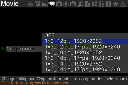

heart0less Posted January 20, 2019 Share Posted January 20, 2019 1 hour ago, Nikkor said: So I managed to record 2.35:1 on 10bit with 1500x1920 continuous!!! which results in 4500x1920 I have no idea how audio works, will have to look into it. The rolling shutter is bad... Don't have anything to compare to right now. Lol, this little crappy camera is crazy. Is there any crop involved? Link to comment Share on other sites More sharing options...

Nikkor Posted January 20, 2019 Share Posted January 20, 2019 3 minutes ago, meudig said: @mercer That's with the eos-m. I've been thinking about getting a 5D3 though, but have yet to find a decent enough deal over here. The 1x3 binning mode must be pretty impressive on the 5Dmkiii, but I can't find any info on the ml forum, do you know if it works? and at which resolutions? Link to comment Share on other sites More sharing options...

Nikkor Posted January 20, 2019 Share Posted January 20, 2019 7 minutes ago, meudig said: Sorry, no clue. And I would like to know too. 1x3 2.48:1 5760(1920)x2352, wow... https://www.magiclantern.fm/forum/index.php?topic=22818.100 meudig 1 Link to comment Share on other sites More sharing options...
Nikkor Posted January 20, 2019 Share Posted January 20, 2019 I've also tried 1:1 4032x2268 Crop mode which is basically m43 sensor area. With 10bit it's continous, with global draw on it will give a black and white preview for accurate framing while recording. Pretty impressive, I thought 2k was amazing back in the 50d times, but this... Andrew Reid would write: MAGIC LANTERN UNLOCKS POKET4K QUALITY RAW VIDEO IN A 50$ 5 years old canon body. Emanuel 1 Link to comment Share on other sites More sharing options...

Nikkor Posted January 20, 2019 Share Posted January 20, 2019 31 minutes ago, Anaconda_ said: Also better for focusing too. Any chance you could share a clip with this setting? Seems like the most usable if it has accurate live view. I will record something tomorrow. But the preview is pixelated, you can't really focus with that. Before recording you can activate a better mode that lags a lot but gives a real quality preview, so if you are fine with focusing before the shot... Update: Ok, it was too good to be true, the 4K cropped mode 1:1 is 9fps ? webrunner5 and Anaconda_ 2 Link to comment Share on other sites More sharing options...
