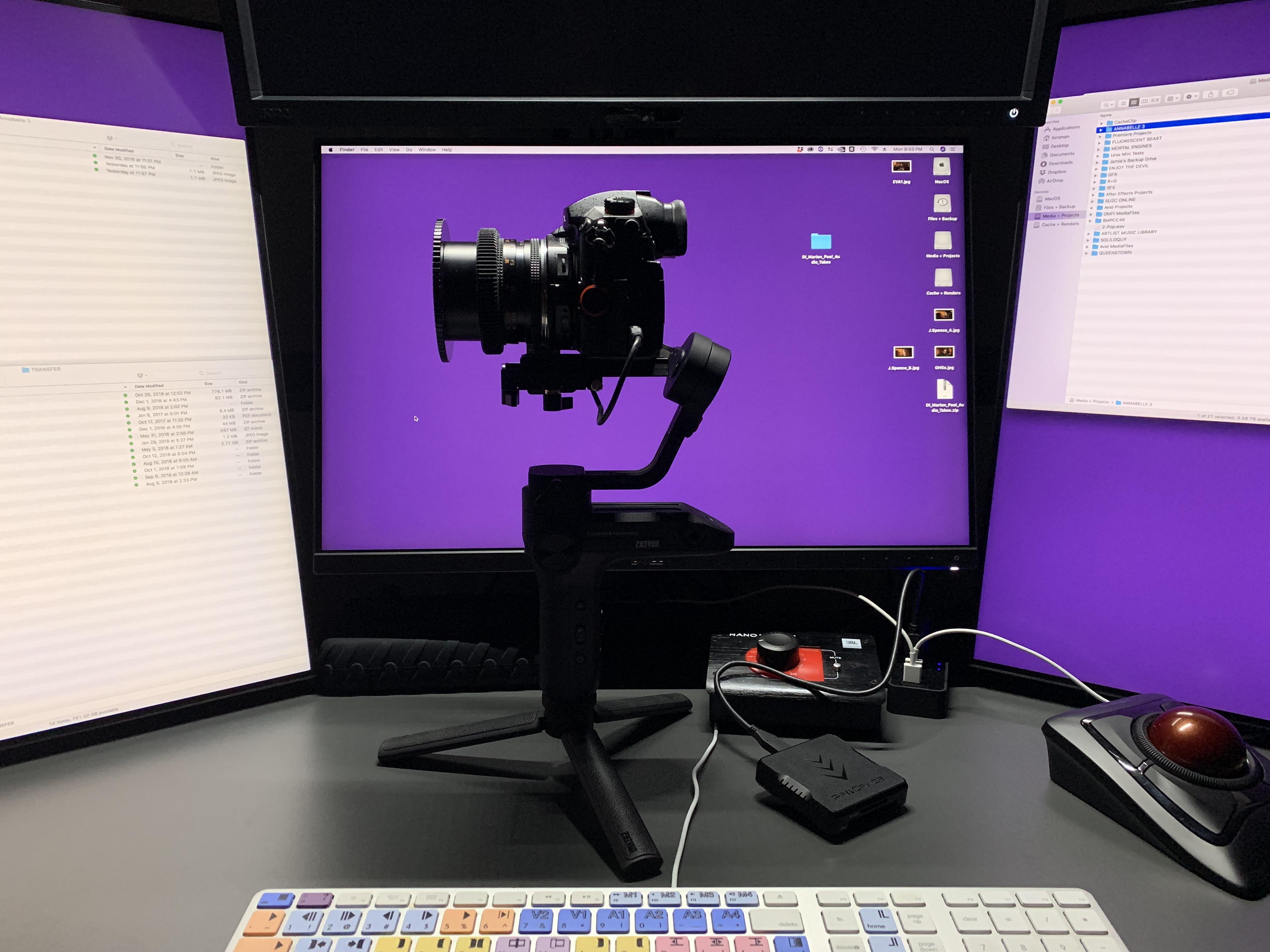

Zak Forsman Posted December 26, 2018 Share Posted December 26, 2018 42 minutes ago, UncleBobsPhotography said: I'm planning to get this as my first gimbal. I'm using an overhand grip most of the time I'm filming, and with this gimbal it looks like I can adopt my current style quite easily. I would be curious to know how the follow focus works, and how their plans for the HDMI out is going to pan out, but I think I will like the gimbal even without those features. I'm using the Weebill with a GH5s, .64x Speedbooster and my (manual focus) Contax-Zeiss lenses. You asked how focus works. The focus wheel requires the use of the Focus Servo to manually control the lens. It will not control a native lens through the USB connection. I absolutely love this gimbal and use it in underslung mode more often than not. I think you'll be happy with it. If you want to run with longer lenses like say a Sigma 18-35, you may want to wait for the Crane 3 Lab. This won't hold it reliably. Xavier Plagaro Mussard and UncleBobsPhotography 1 1 Link to comment Share on other sites More sharing options...

mojo43 Posted December 26, 2018 Author Share Posted December 26, 2018 6 hours ago, Zak Forsman said: I'm using the Weebill with a GH5s, .64x Speedbooster and my (manual focus) Contax-Zeiss lenses. Seems like a heavy setup? Are you getting stable footage with it? 1 hour ago, Ki Rin said: Seems like good hardware spoiled by poor software. @Zak Forsman How has your experience with the app been? I really wanted to like this gimbal since it is nice and lightweight.. Most of the other new gimbals seem quite heavy. It is no more lightweight than any of the other gimbals like Moza air or crane v1 / v2. If you check out the vid I show an example of them laid out and they are basically the same size. Link to comment Share on other sites More sharing options...
UncleBobsPhotography Posted December 26, 2018 Share Posted December 26, 2018 8 hours ago, Zak Forsman said: I'm using the Weebill with a GH5s, .64x Speedbooster and my (manual focus) Contax-Zeiss lenses. You asked how focus works. The focus wheel requires the use of the Focus Servo to manually control the lens. It will not control a native lens through the USB connection. I absolutely love this gimbal and use it in underslung mode more often than not. I think you'll be happy with it. If you want to run with longer lenses like say a Sigma 18-35, you may want to wait for the Crane 3 Lab. This won't hold it reliably. Too bad it doesn't have any "wired" focus control. It would have been nice to at least get "push to autofocus" since it's often enough for me to simply set the focus once before recording. It doesn't seem like my local shops have the follow focus listed (unless it's the same one as for the Crane 2), but I'm sure I'll be able to get it later if I'm happy with the gimbal. I'm using the GH5. My 2 native lenses should be well within the weight limits, but I guess my adapted Canon L-lenses will be borderline too heavy. The GH5+speedbooster+Canon 35mm f/1.4 is 1.5 kg. Link to comment Share on other sites More sharing options...
Zak Forsman Posted December 27, 2018 Share Posted December 27, 2018 18 hours ago, Ki Rin said: @Zak Forsman How has your experience with the app been? 1 Wish I could tell you, but I'm not using the app for anything other than tweaking settings. I don't feel like I have as much fine control over what i'm doing. Beyond the controls offered on the handle, I just need to pull focus manually so this particular gimbal works well for me. I'm still running an HDMI directly from the camera to monitor what i'm doing. I don't want to worry about lag or skipping at crucial moments. 17 hours ago, mojo43 said: Seems like a heavy setup? Are you getting stable footage with it? Runs smoothly with the motors set to medium. Sometimes i bump it to high if I put one of my heavier Contax Zeiss lenses on like the 35/1.4. But the 18mm and the 25mm (pictured above) are pretty light. I also have a Panny/Leica 12-60 that's super light. I put the motors on low for that. Would love to share footage but they are for a short film that the director doesn't want anything released from, or it's behind the scenes footage for studio movies that haven't come out yet. On the short, I do remember the gimbal getting jittery at one point, but i shut it off and immediately saw it needed to be rebalanced. after I did, it was fine the rest of the shoot. Thanks for the great review by the way. I'm going to try your settings over the holiday break. mojo43 1 Link to comment Share on other sites More sharing options...
