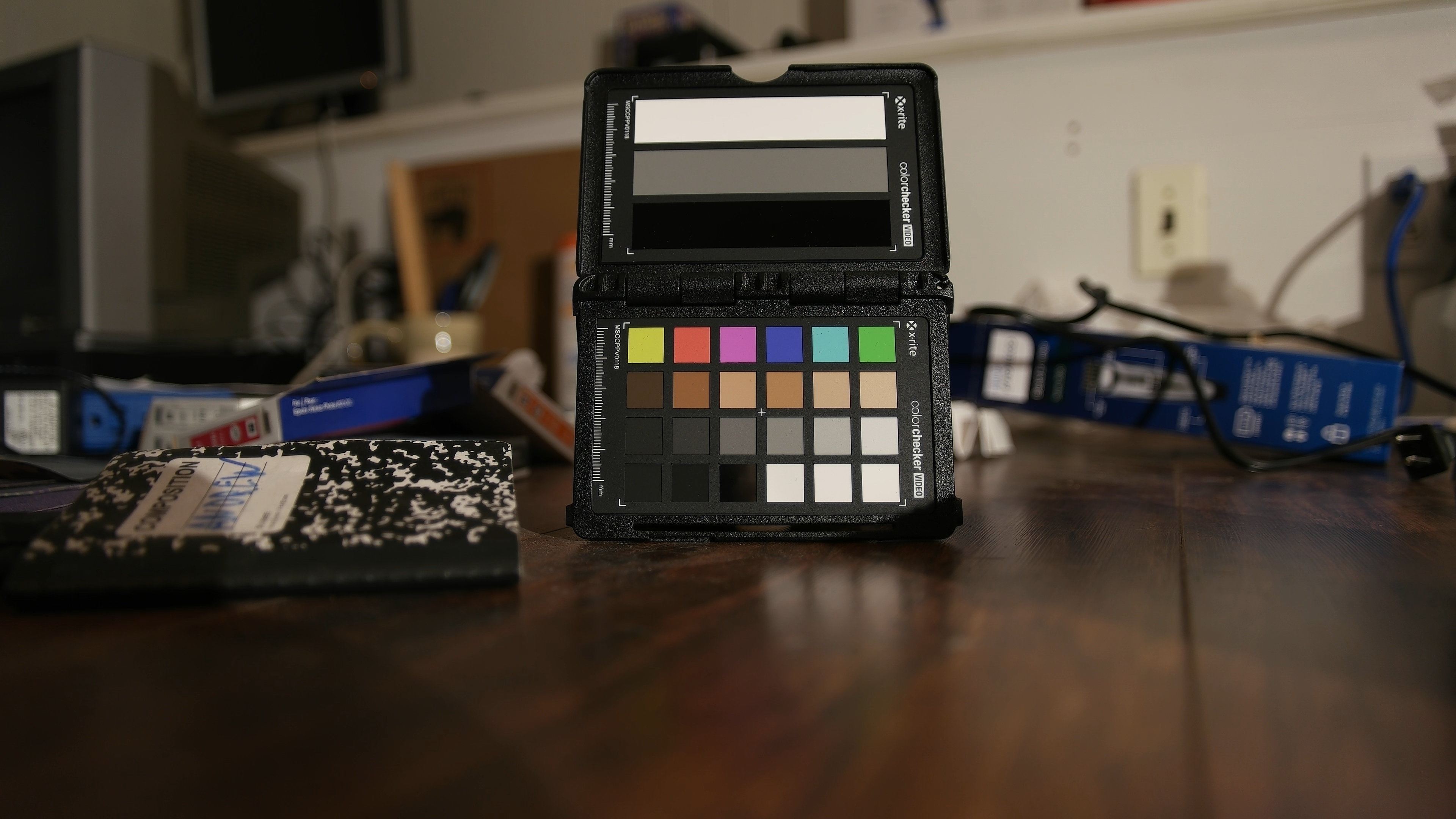

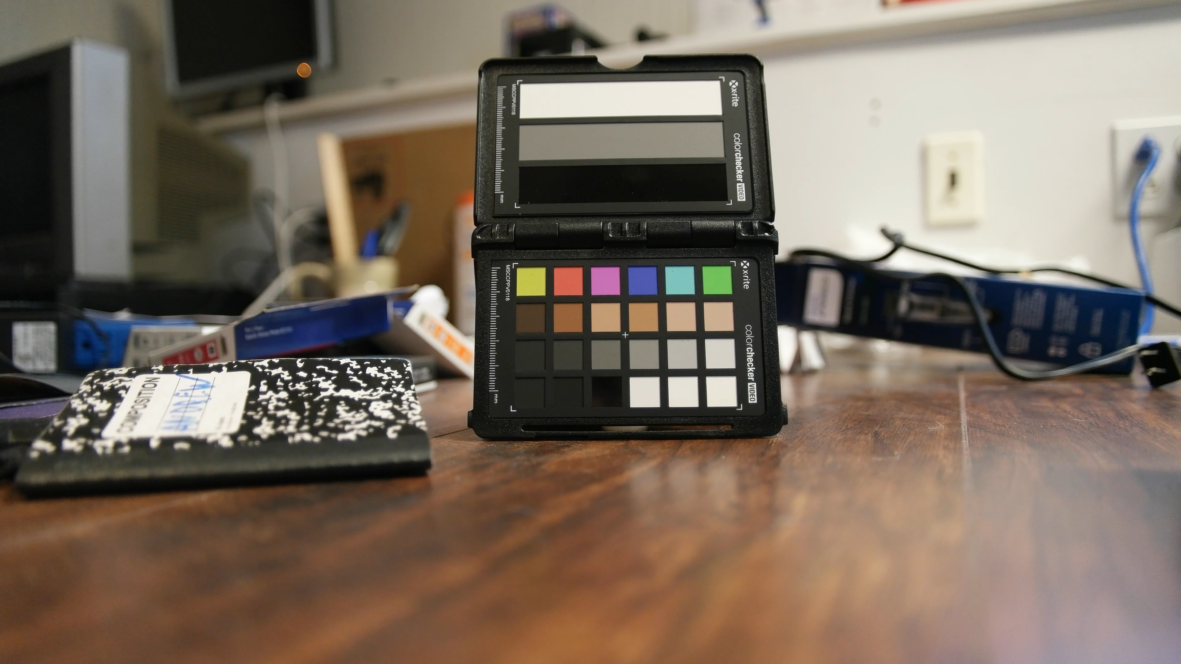

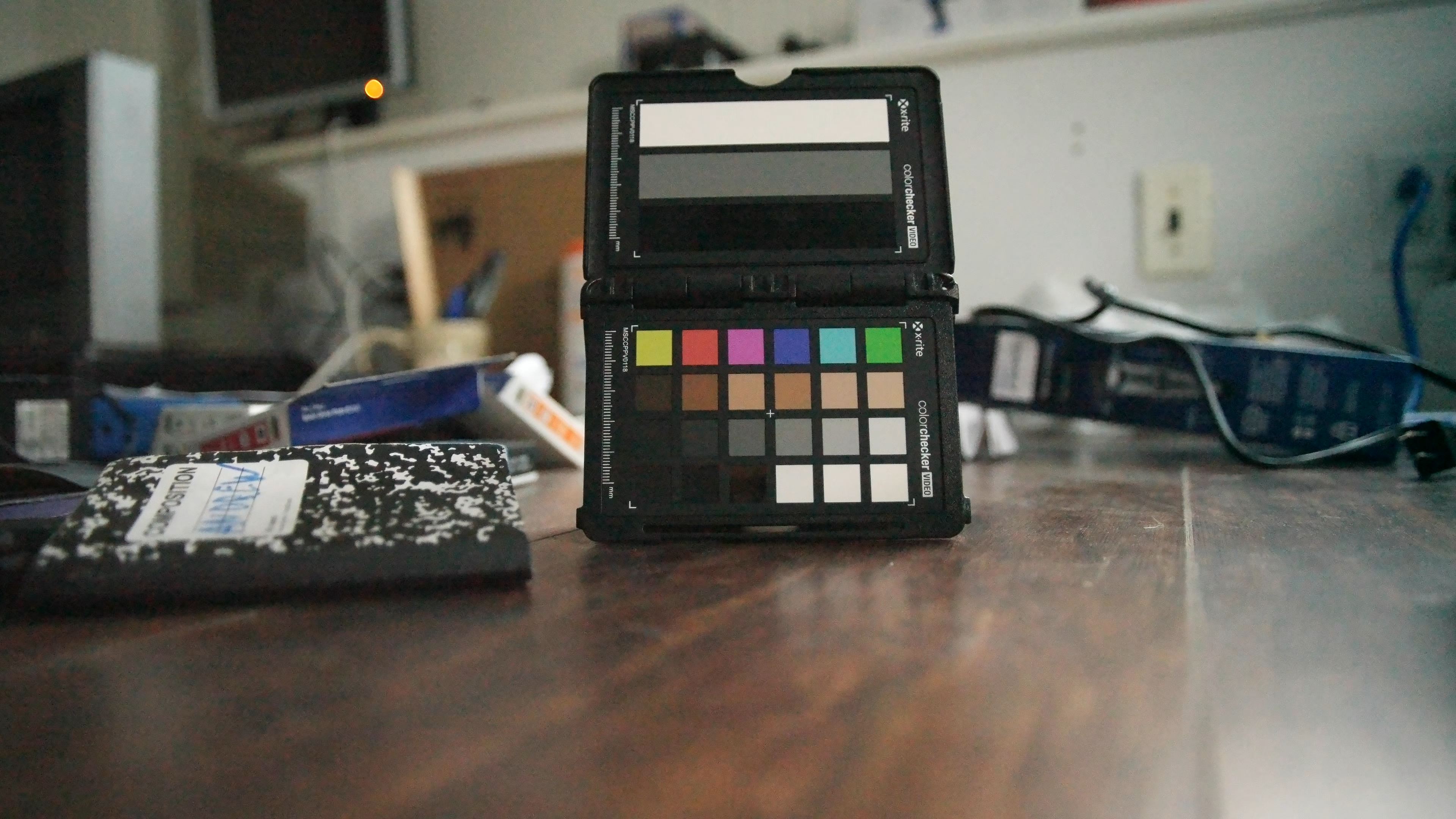

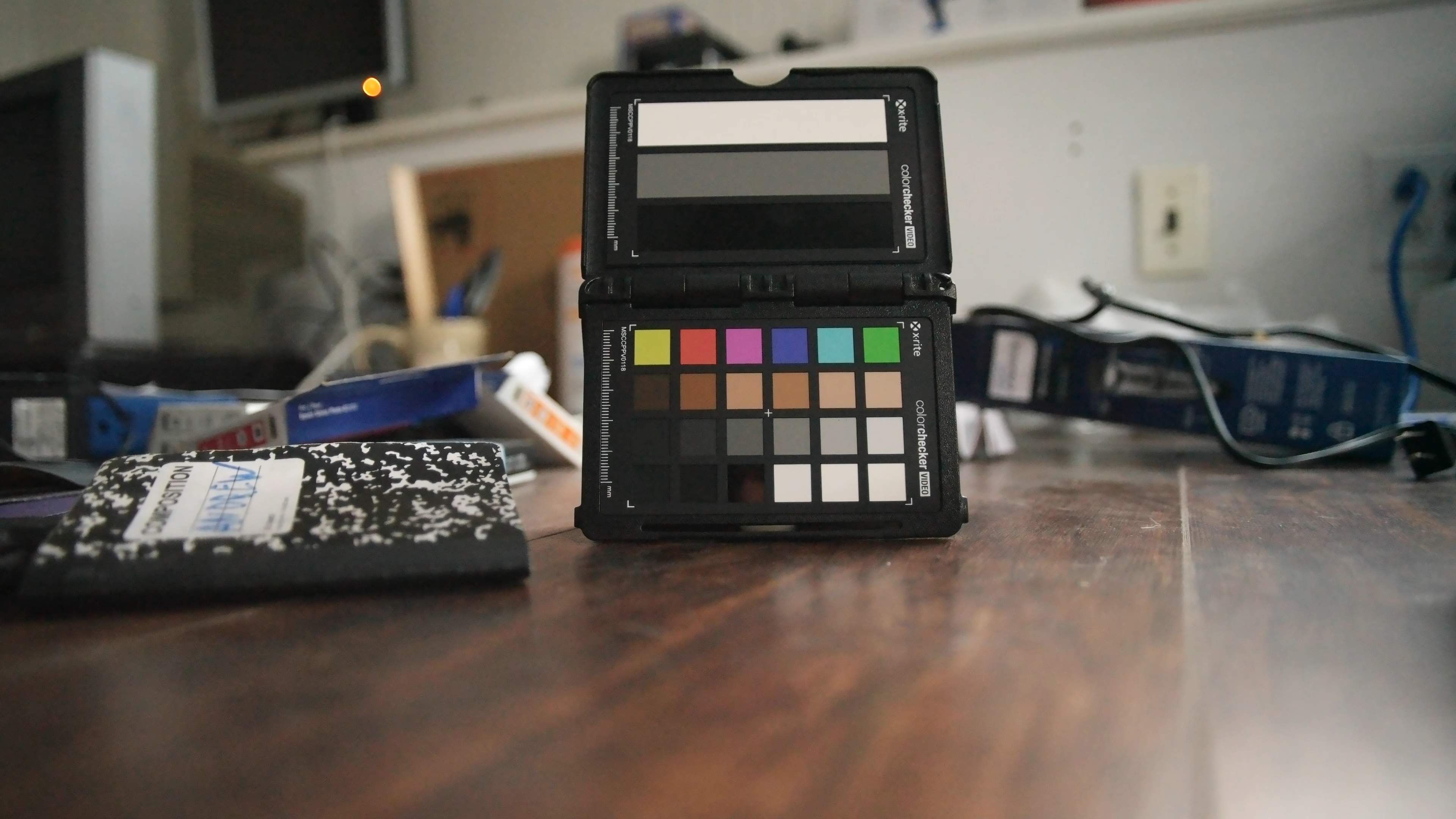

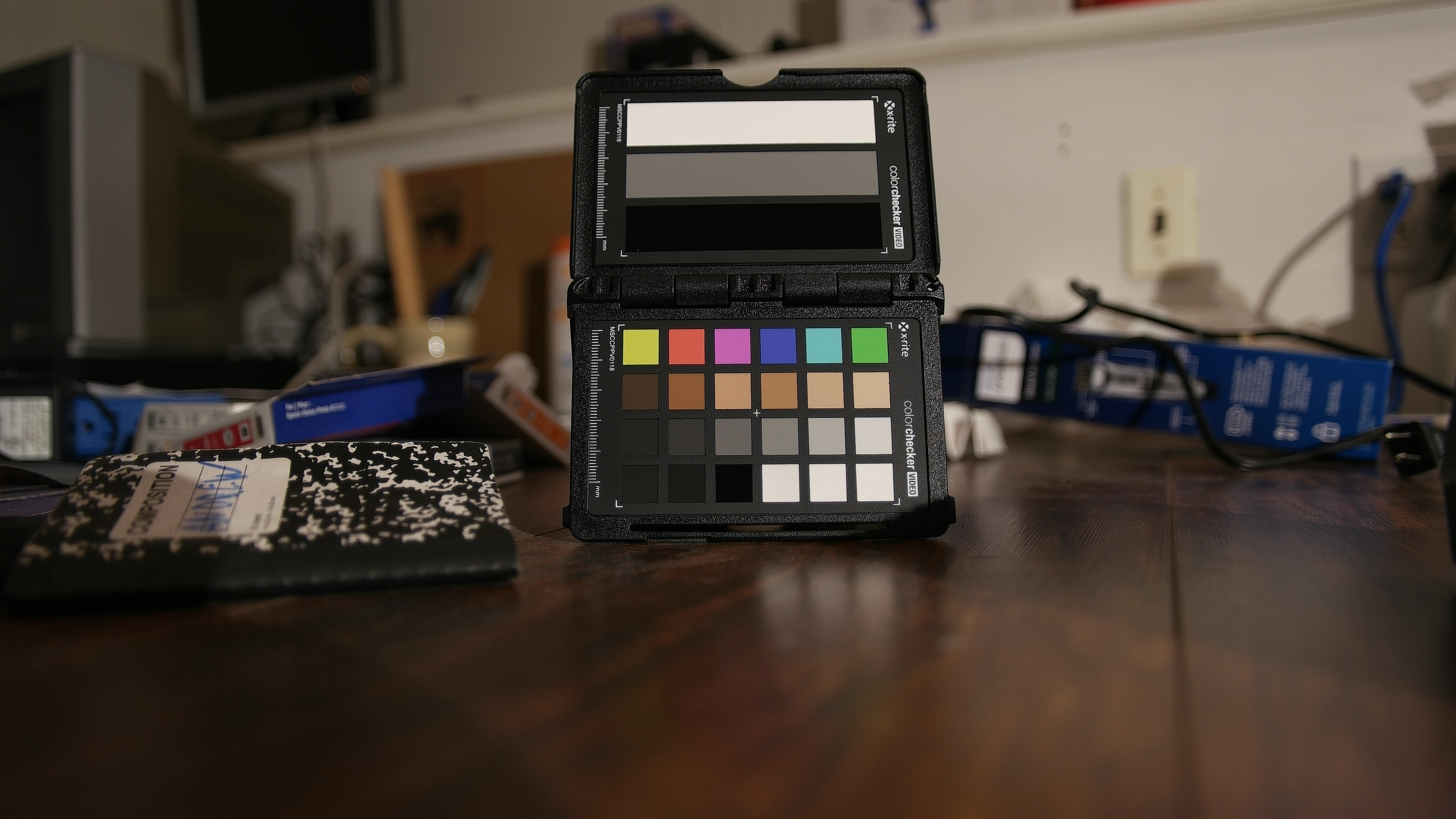

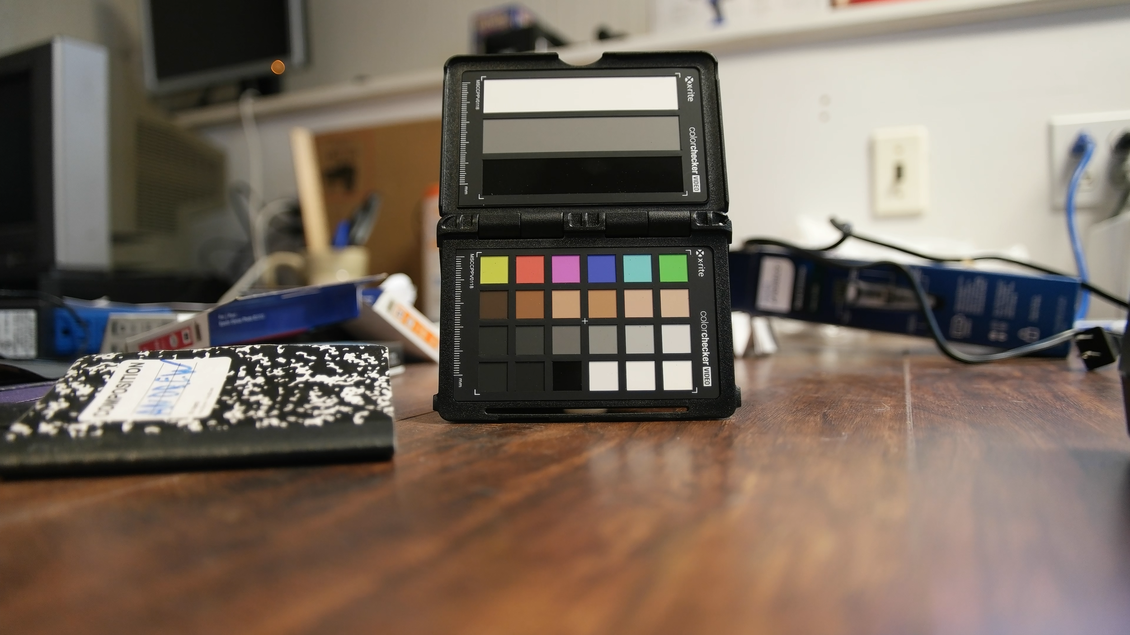

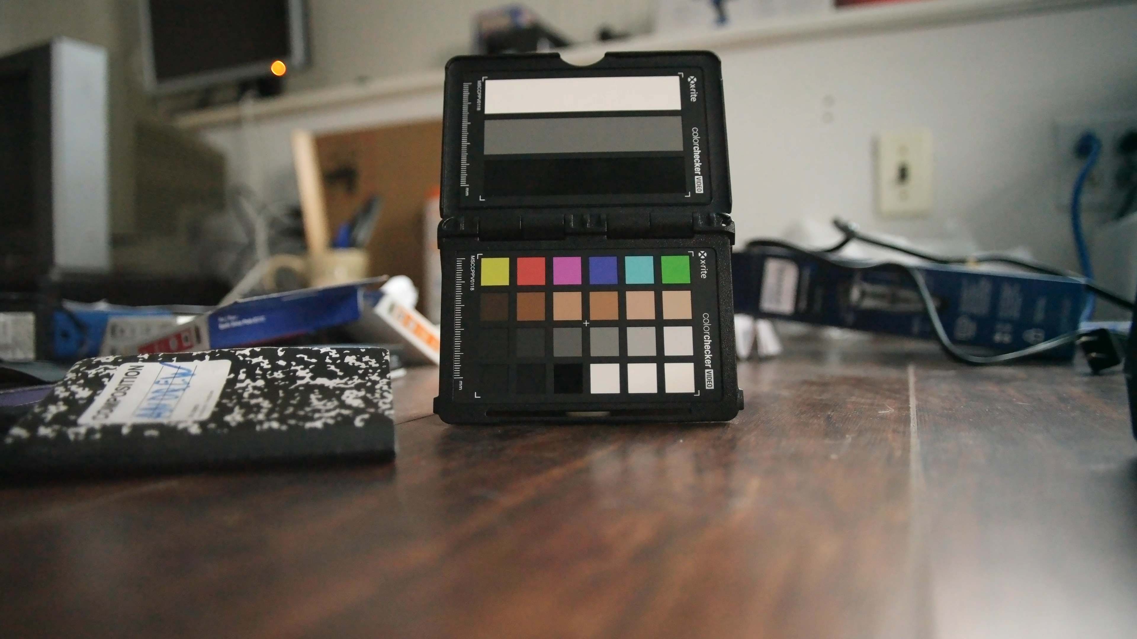

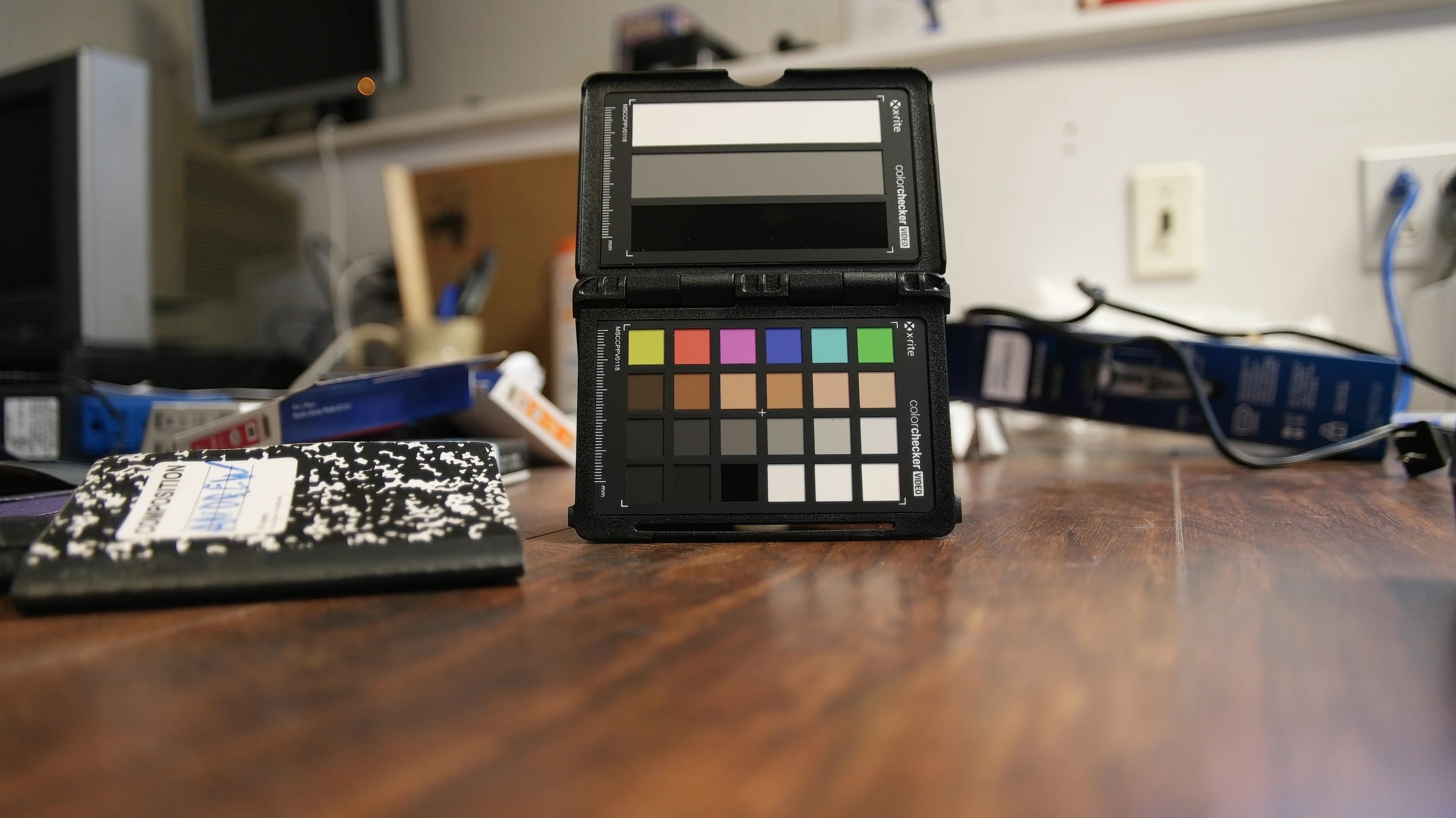

mnewxcv Posted February 26, 2019 Share Posted February 26, 2019 messing around with this today. I am at the moment comparing PW with RGB 0.75, 1.00, and 1.99. My initial tests show 0.75 not having any obvious negative side effects, and provides -0.3 roughly of exposure compensation. AKA, similar to a 0.1ND filter. Please note, this is the first of many tests to be done. This test consisted of recording a colorchecker in 3 lighting situations: basement no lights on (light through windows) referred to as LL, normal light on referred to as NL, and lastly an LED flood light aimed at the color checker referred to as BL. All tests were white balanced on a grey card (warm result) and exposed for it as well. Please discuss what you notice about the differences. LL test settings to achieve proper exposure: RGB 1.00, EV 0, f2.0, 1/50, iso5000: ll100.bmp RGB 1.99, EV -1, f2.0, 1/100(accident), iso5000: ll199.bmp RGB 0.75, EV +0.3, f2.0, 1/50, iso6400: ll75.bmp NL test settings to achieve proper exposure: RGB 1.00, EV 0, f2.0, 1/50, iso640: NL100.bmp RGB 1.99, EV -1, 1/100 (accident), iso640: NL199.bmp RGB 0.75, EV +0.3, 1/50, iso 800: NL75.bmp BL test settings to achieve proper exposure: RGB 1.00, EV 0, f2.0, 1/100, iso100: BL100.bmp RGB 1.99, EV -1, f2.0, 1/200, iso100: BL199.bmp RGB 0.75, EV +0.3, f2.0, 1/80, iso100: BL75.bmp disregard.bmp Link to comment Share on other sites More sharing options...
mnewxcv Posted February 26, 2019 Share Posted February 26, 2019 next I will do the same tests underexposed a stop. It may take me a day or two to get this together. Upon initial inspection, the 1.99 footage has more highlight info and less shadow/black info. However, in brightly lit tests 1.99 seems to have a smoother black roll-off when boosting shadows, due to what seems to be the fact that it has less lower end info, so it has less steps of black that get noticed. It may appear slightly more contrasty, but macroblocking/posterization is actually less (seemingly). Will be doing overexposure tests once I finish underexposure. Link to comment Share on other sites More sharing options...
