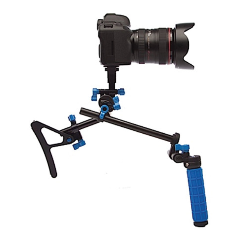

heart0less Posted March 15, 2018 Share Posted March 15, 2018 Hello there. First post here, though I've been visiting the forum for a long, long time as a non-participating viewer. Recently I managed to lay my hands on a sweet Helios 44M-4 and that finally made me think seriously about getting a shoulder rig. However, looking at them I began wondering if this isn't too much for my small, mirrorless (a6300) setup. I do not use (nor do I plan to) external monitor, LED lights, anything - apart from occasionally mounted Zoom H1 / some Rode mic. My heaviest lens is 18-105, but even then the whole setup weighs just around 1kg. I really crave for an organic, natural, handheld look many short videos / ads feature, though I realize they've been filmed with a proper cameras + cine lenses, whose weight prevent getting micro-jitter shakes, + Easy Rigs and gimbals, etc. Is this even possible to achieve this pleasant, immersive handheld feel with such a feather-light cameras? Do you have any recommendations / experiences you are eager to share? Does it make sense to look for something like Tilta's shoulder rigs with counterweights, Z-brackets and top handles or just let it go and get something like Revo's rigs (image)? Being able to have a follow-focus system would be nice, since rotating focus rings with hand will ruin everything.. Thanks for reading, Greetings. Link to comment Share on other sites More sharing options...

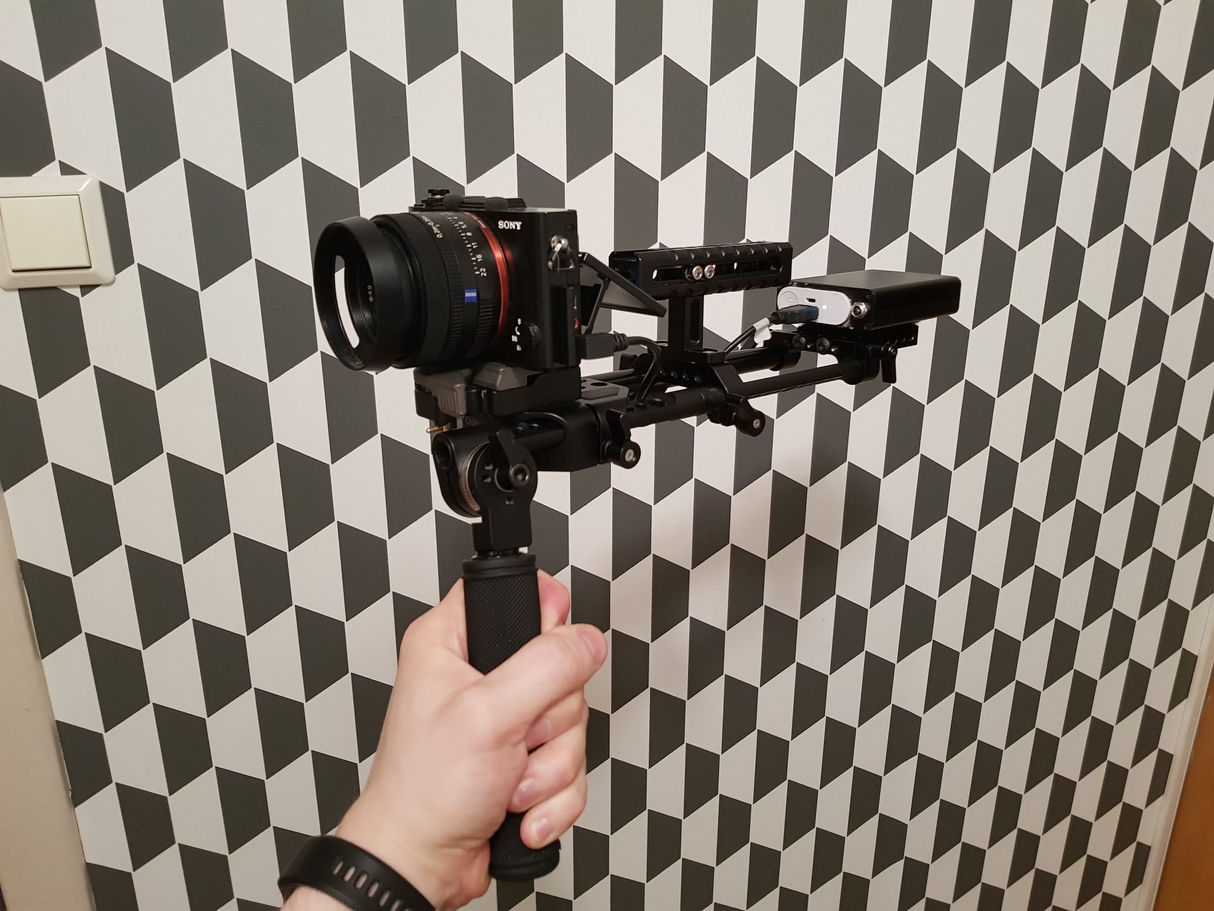

UncleBobsPhotography Posted March 16, 2018 Share Posted March 16, 2018 I have been using the rig in the attached photo lately. To make the rig more stable, you should position the weight as spread out as possible. Putting the powerbank on the end of the rods makes a big differenc, and it's also nice to have it powering the camera. The mid handle is in the centre of gravity which makes it better to handle. I attach the front handle when I want to shoulder mount it. All together the pieces cost about $150 from eBay IronFilm and Adept 1 1 Link to comment Share on other sites More sharing options...
heart0less Posted March 16, 2018 Author Share Posted March 16, 2018 On 3/16/2018 at 6:03 PM, UncleBobsPhotography said: I have been using the rig in the attached photo lately. To make the rig more stable, you should position the weight as spread out as possible. Putting the powerbank on the end of the rods makes a big differenc, and it's also nice to have it powering the camera. The mid handle is in the centre of gravity which makes it better to handle. I attach the front handle when I want to shoulder mount it. All together the pieces cost about $150 from eBay Expand This looks legit! I really like it, since it allows to rest one hand on a camera and turn on/off recording or fiddle with settings. Where do you put a shoulder pad if I may ask? Do you just move the power bank and then attach it? One more thing: unfortunately, my replies will be delayed - they need to go through the moderator before they get posted. Link to comment Share on other sites More sharing options...

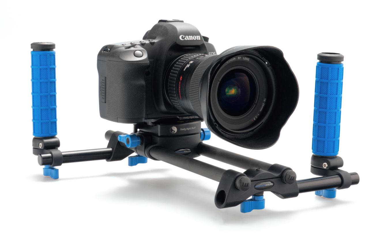

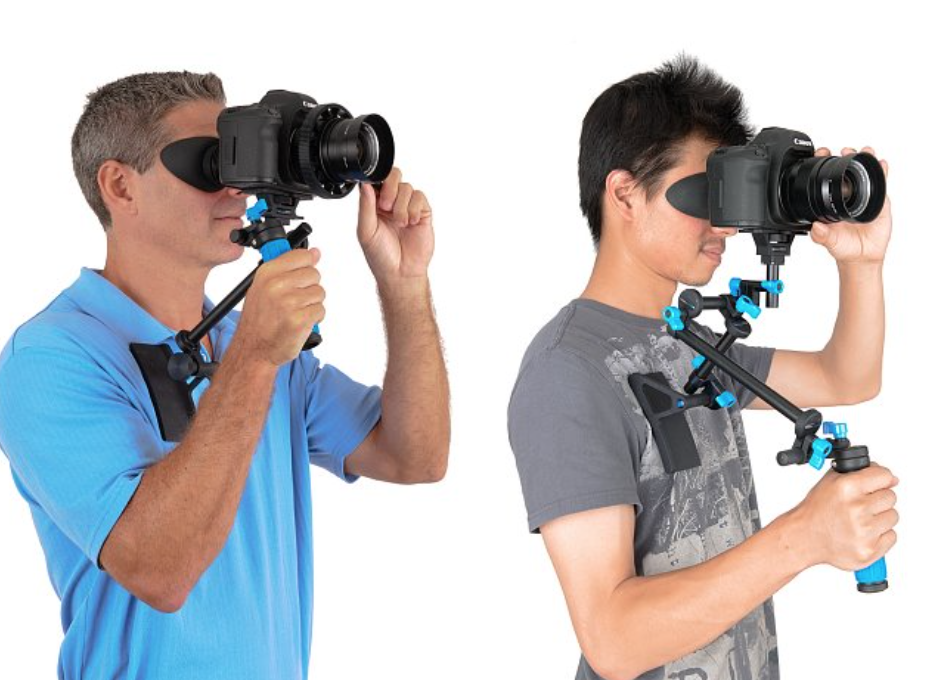

Trek of Joy Posted March 16, 2018 Share Posted March 16, 2018 For small/light without a gimbal I like what Uncle Bob did above, only I'd have the option for a chest pad or something for another point of contact when you want added stability. I also like the twin offset handle config pictured below, though the a6300's rolling shutter, that could be tough without a stabilized lens. You don't have to spend Redrock cash either, but they have lots of rig sample photos to get ideas from. The other option is a gimbal. Chris Link to comment Share on other sites More sharing options...

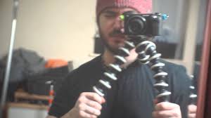

kye Posted March 17, 2018 Share Posted March 17, 2018 In addition to the above advice, another option I have opted to go with is a Job Gorillapod (I bought the largest one, I think it's called the 5K?). It's a small tripod with bendy legs, and is a jack-of-all-trades-but-master-of-none. If you're familiar with Casey Neistat it's what he uses on his hand-held rigs. It can be used: as a very short tripod (~30cm tall) if you bend the legs so they're together it works as a handle if you have a bullhead you can adjust it so the legs go straight out behind the camera horizontally and it's a crude shoulder rig if you have the legs coming back at you then you can have them make two points of contact with your chest, with your hands making three if you put one leg towards your chest you can shape the other two out to the sides in a W shape and they become two handles - one on each side of the camera a variation on the above is that the leg coming back goes over your shoulder making it a shoulder rig with handles it's grippy so it can be wrapped around trees, poles, etc etc etc etc It won't do any of those things as well as dedicated rigs, but it's probably the most flexible rig you can get. You said you didn't want to go overboard - this will give you some extra stability but will also ensure you aren't going too far! My other suggestion might be a monopod. Super stable if you're stationary, and if you're walking then it makes a decent counterbalance a bit like a glidecam. IronFilm 1 Link to comment Share on other sites More sharing options...

heart0less Posted March 17, 2018 Author Share Posted March 17, 2018 So, to sum up: there is not so much to gain from an offset rig with a counterweight, when it comes to a feather-light camera without any extra accesories. Did I get it right? Gorillapod seems like a nice option, but wouldn't it be a bit slippery / wobbly? There is nothing that sets it properly in place, nothing to prevent it from moving on my chest / shoulder. Link to comment Share on other sites More sharing options...

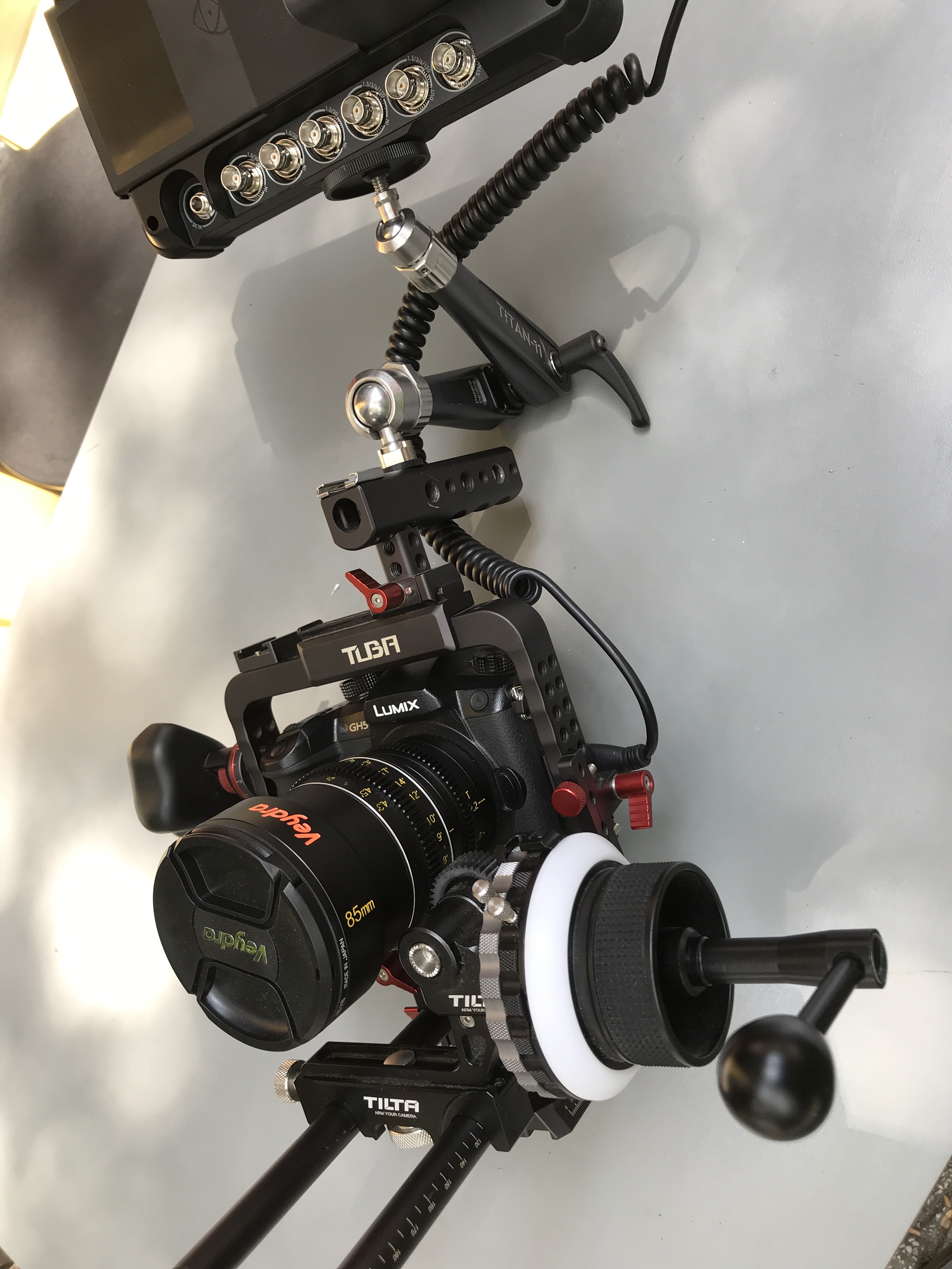

jonpais Posted March 17, 2018 Share Posted March 17, 2018 Whatever you do, don’t go crazy like I did this afternoon. Link to comment Share on other sites More sharing options...
heart0less Posted March 17, 2018 Author Share Posted March 17, 2018 Hahahahha, that's a nice one. Will you mount it on a tripod? Link to comment Share on other sites More sharing options...
jonpais Posted March 17, 2018 Share Posted March 17, 2018 On 3/17/2018 at 3:16 PM, heart0less said: Hahahahha, that's a nice one. Will you mount it on a tripod? Expand Believe it or not, I actually tried shooting with this contraption on an easyrig when I realized it was completely impractical. Yes, next time, tripod. ? Link to comment Share on other sites More sharing options...
kye Posted March 17, 2018 Share Posted March 17, 2018 On 3/17/2018 at 11:43 AM, heart0less said: Gorillapod seems like a nice option, but wouldn't it be a bit slippery / wobbly? There is nothing that sets it properly in place, nothing to prevent it from moving on my chest / shoulder. Expand Each 'bubble' on the legs have a rubber ring around them and they're surprisingly grippy. Combined with the fact you can bend it however you'd like it can do an ok job. The most significant issue is that as everything is flexible and there's no way to lock things down (there is no tighten adjustment) if you put enough force on something then it will move. I don't think you'll run into this problem if you get a large enough one (this is why I went with the largest model) but you can't expect it to be completely rigid either. On 3/17/2018 at 12:14 PM, Dude_ger said: Rent one and check for yourself. If you like the feeling of your rented rig, don't buy a compromise- no gorilla pod and no rig with one handle or anything that costs less than 200 $ (new), you will get pissed of because of screws getting loose and things like that. Expand Great advice. Rigs are personal and depend on what you're shooting and how you are approaching it. @jonpais what a great rig - reminds me of the contraption I've built for my next family holiday... It has the XC10 and Rode VMP+ pointing forwards and the GoPro and Rode VideoMicro pointing backwards so that I can get shots of myself included in the video. Including the GoPro also means that I can do things like time lapses (eg, if we stop to eat by a nice view) without having a separate rig. I'm also taking my phone with the a phone gimbal for those wide panning shots that I can never get smooth handheld. Time will tell if this rig is genius, ridiculous, or both! @heart0less view this as a sign of what NOT to do! jonpais 1 Link to comment Share on other sites More sharing options...
