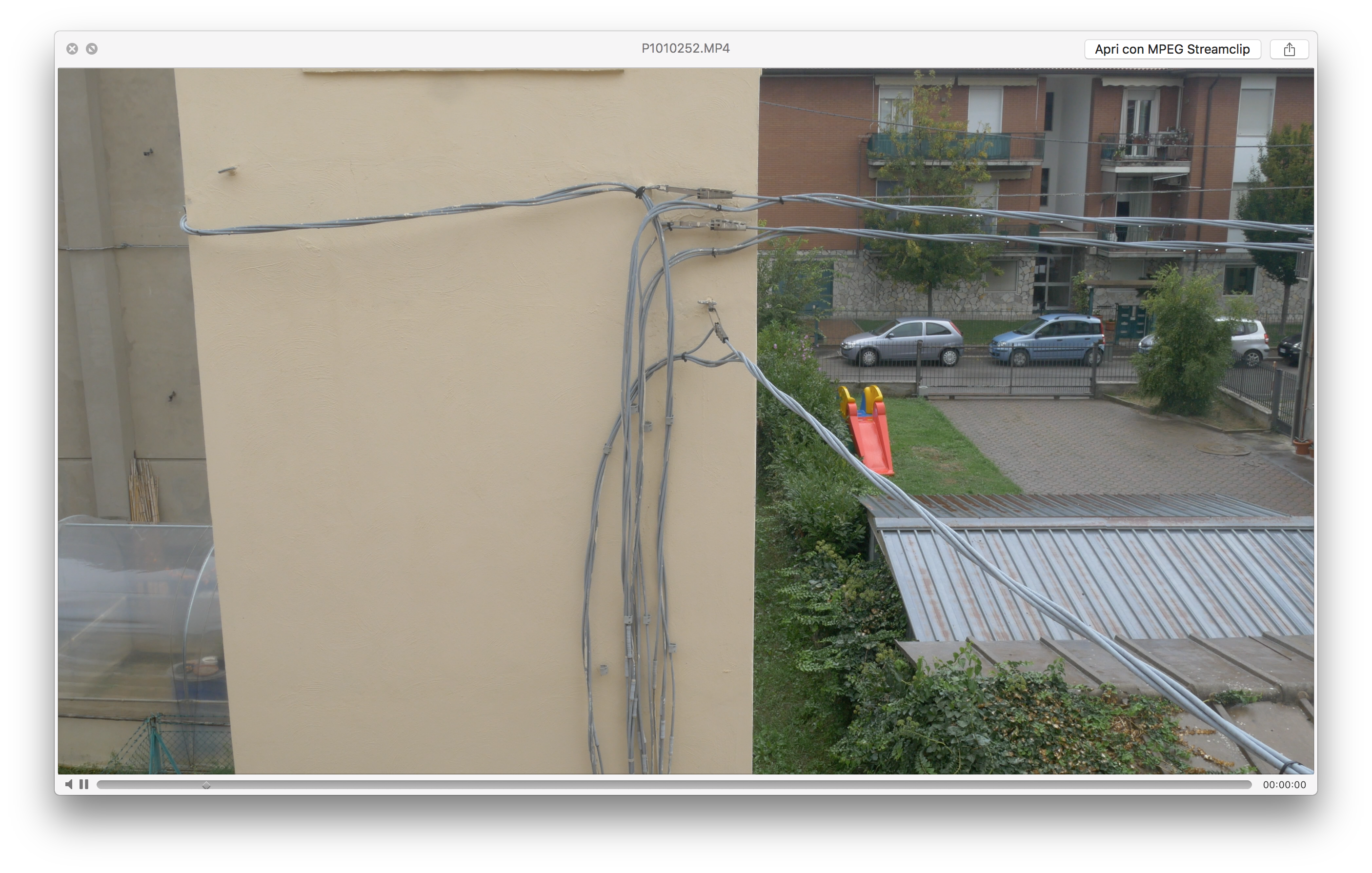

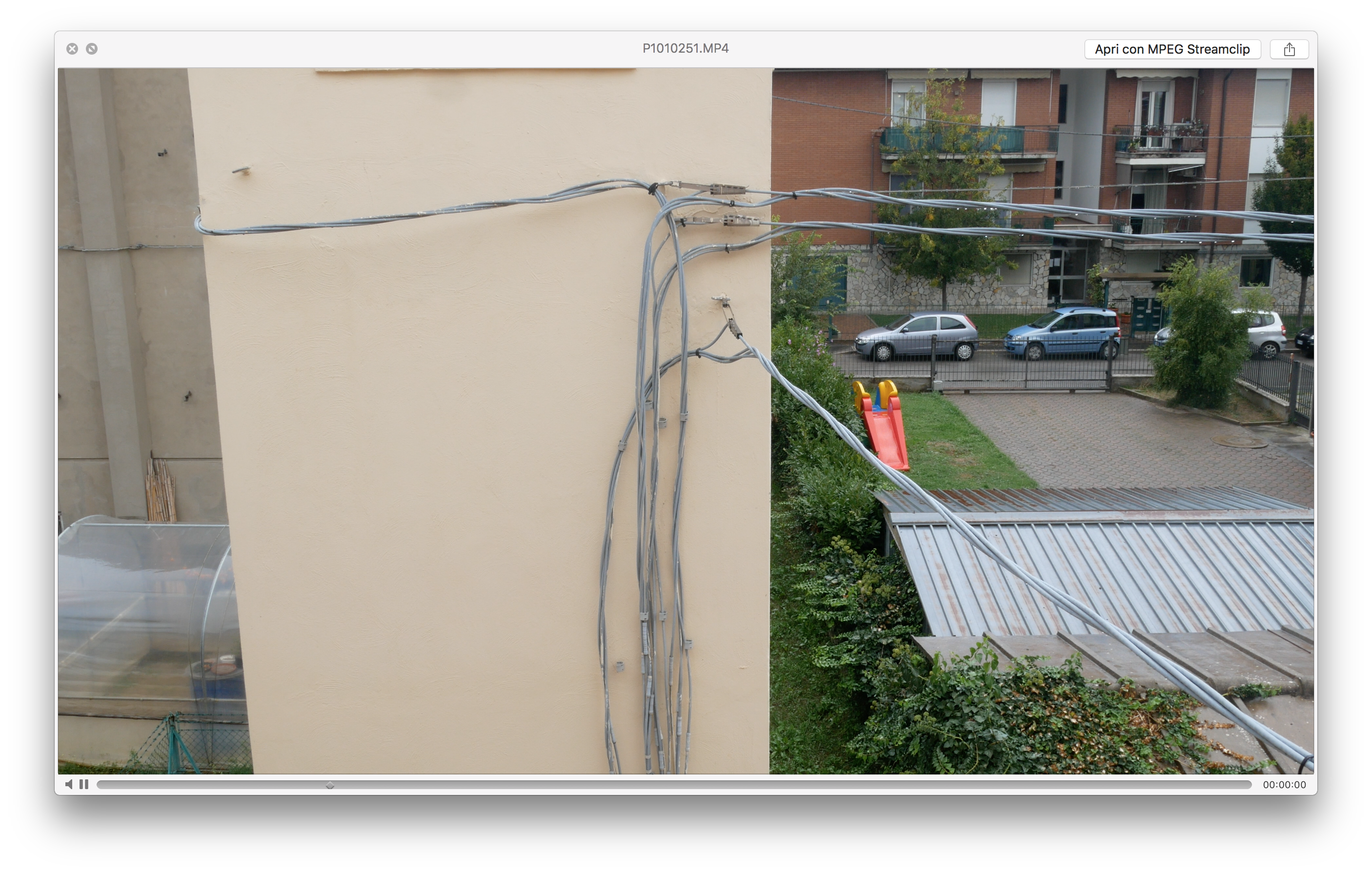

So, as some of you may know, I've been "experimenting" with having little chats with different Panasonic cameras over WiFi and after whispering in the GX80s ear last night, I may have come up with something quite interesting.
The first image is a grab from a GX80 using its Standard profile.
The second image is a grab from a GX80 that is definitely not using the Standard profile.......
