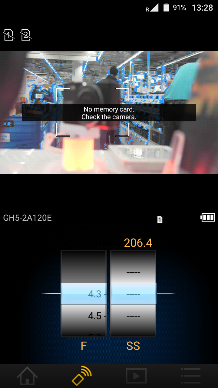

Thanks to Saturn in Berlin leaving a GH5 unattended I was able to do a quick sniffing session and the app does indeed control the angle increments so I now have the command to do it.
Its a bit of an unusual structure so I suspect the camera needs to be in the specific mode to accept the offset parts of the message but its something to go on when I get back. I'm not convinced it will work on the GX but you never know. At least I can include it in the device for GH5 owners if nothing else.

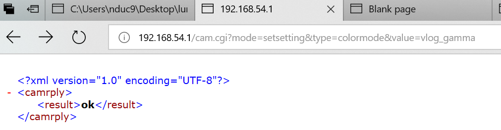

Hi guys, I tried on my GF8 and it worked, but not perfect like I thought. Its darker than other color modes, but the color is good.
In addition, I also tried other commands. The first is vlog
http://192.168.54.1/cam.cgi?mode=setsetting&type=colormode&value=vlog_gamma
The resulted image is slightly darker than standard mode, despite the same setting. File size all larger (6.1 vs 5.6), but the menu no change like in cine D. Thus, I am not sure it works or not.
