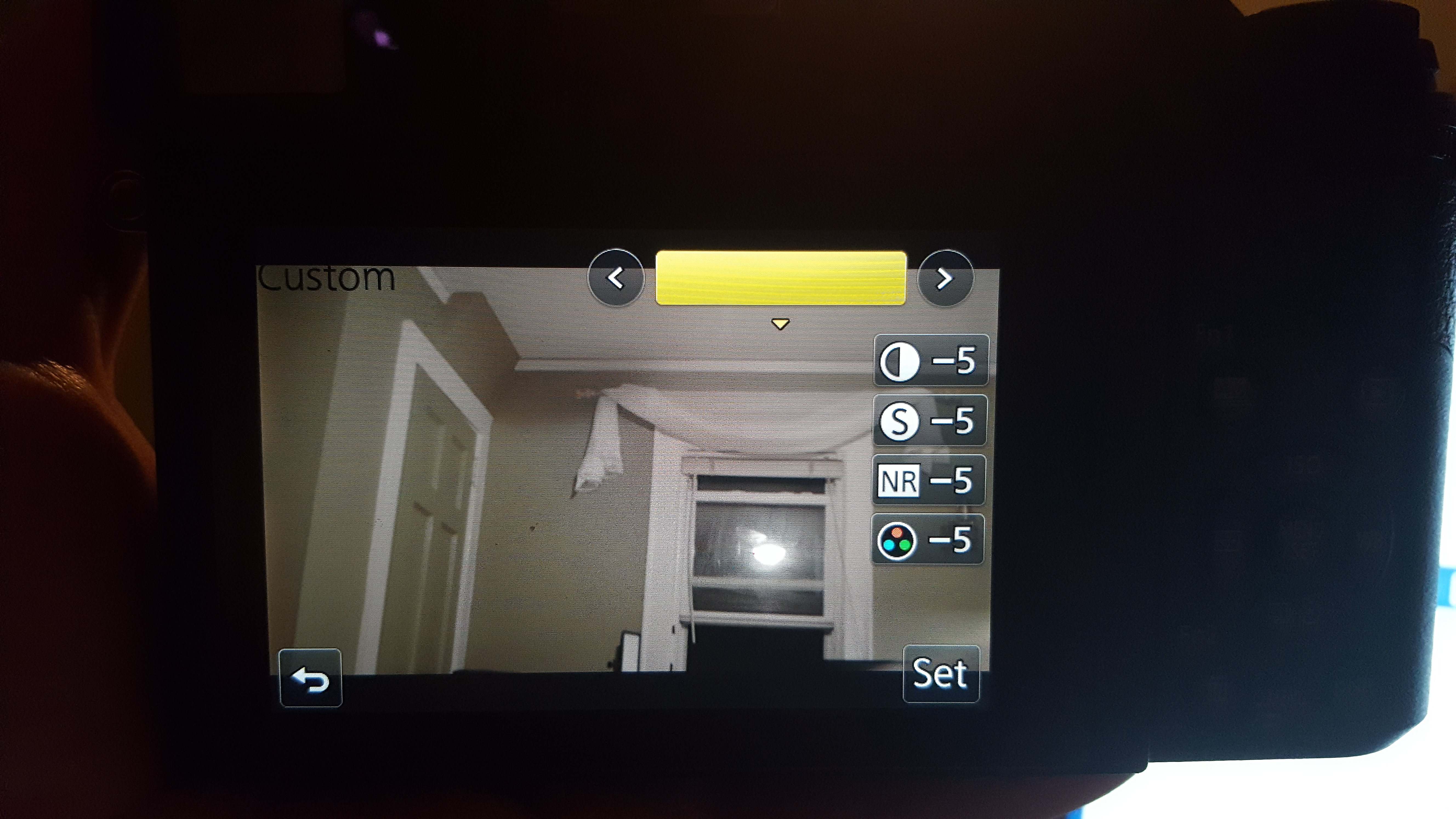

livingcolor Posted June 7, 2017 Share Posted June 7, 2017 Thank you for this!!! I believe I found a better workaround for using the C1,C2,C3 custom functions, where you can: - Save the CineD for use as an actual profile and - Switch to other profiles normally I was able to save the CineD profile into the custom slot by clicking the Disp.Save button while in the profile change window. This saved the profile as Custom and allows me to switch profiles now, but at same time I can still go back to CineD by going to the slot where Custom used to be, it still appears as Blank with Custom misaligned to the very left top on the screen :D See the pic and check out the video I attached too. 20170607_033823_1.mp4 BTM_Pix and Grimor 2 Link to comment Share on other sites More sharing options...
Super Members BTM_Pix Posted June 7, 2017 Author Super Members Share Posted June 7, 2017 23 minutes ago, livingcolor said: Thank you for this!!! I believe I found a better workaround for using the C1,C2,C3 custom functions, where you can: - Save the CineD for use as an actual profile and - Switch to other profiles normally I was able to save the CineD profile into the custom slot by clicking the Disp.Save button while in the profile change window. This saved the profile as Custom and allows me to switch profiles now, but at same time I can still go back to CineD by going to the slot where Custom used to be, it still appears as Blank with Custom misaligned to the very left top on the screen :D Yes, this is a perfectly valid way to do it. However, for me, I also felt it was much easier to accidentally overwrite when using other profiles and mean you have to fire up a computer or smartphone to redeploy if you want Cinelike D back. Depending on where you are when you do this, it may not always be that practical and certainly not fast to do that. This is true of using the C functions as well of course but its a far more deliberate process to overwrite those as you need to go and navigate through the menus to get there and do that so I felt it was a bit safer. You could certainly use both approaches though and just save Cinelike D into the custom profile slot (along with any tweaks of its additional parameters as you would do using that function with the other profiles)and also save it in its flat format into C1 so if you did overwrite it then you could get it back easily. And that approach definitely saves having to use an additional C slot too. Link to comment Share on other sites More sharing options...
