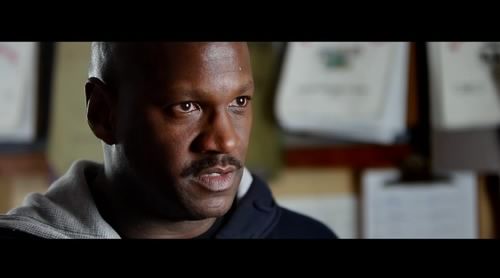

TheRenaissanceMan Posted March 10, 2017 Share Posted March 10, 2017 Can you pin down exactly what they mean by "hard light look"? Do they mean gritty with lots of contrast? High key? If it's what I'm thinking of, you could cover all the windows except one, then use that as a hot edge and gel a softer source (1/2 CTB should be fine) from the opposite side as your key. Or vice versa, depending how the ratios work out. Then some negative fill on the down side of the face. Should give you something like this. I would avoid undiffused redheads/blondes. They tend to have hot spots and an uneven spread, and are therefore not controllable enough to use directly on talent IMO. Better off using a fresnel with Hollywood Frost or a couple sheets of Opal. andrew berekdar and Gregormannschaft 2 Link to comment Share on other sites More sharing options...

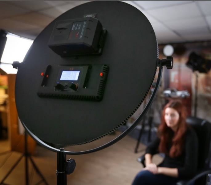

jonpais Posted March 10, 2017 Share Posted March 10, 2017 22 minutes ago, Davey said: Thanks for sharing this. That will save me a tonne of time when I finally get around to using lights for the first time (probably this summer when doing interviews). I've watched a few videos on the subject but it's far easier just to look at that one single page. Still pictures cannot waffle. I put an order in for some LED lighting for video, my very first. I'll be getting Chinese versions of some popular Fotodiox models for vlogging, short films and possibly some pinups. A while back, Dave Dugdale did a review of these lights and said they were virtually identical to Fotodiox, except for the price. I'd wanted to get Aputure lighting, but they're not available here, and they cost a small fortune anyway. Link to comment Share on other sites More sharing options...

jcs Posted March 10, 2017 Share Posted March 10, 2017 1 hour ago, TheRenaissanceMan said: Lol! Clearly, you haven't shopped for many lights. Aputure are dirt cheap compared to Kinos, HMIs, plasma, and most comparable LEDs. It's all relative, right? Aputure Lightstorms, for example are in the high end of consumer/prosumer lights. While there are now lots of good options for LED panels at all price ranges, I don't see many options for high CRI LED Fresnels (I have one Fiilex P360EX with a drop in Fresnel. Would love to see some variable Fresnels with more light output in the same size or slightly larger and priced to compete with Aputure (perhaps best bang for buck re:CRI and cost)). A powerful LED Fresnel is a lot more versatile than flat LED panels (beam width and modifiers, everything from tight hard light to large area soft diffusion). Link to comment Share on other sites More sharing options...

andrew berekdar Posted March 10, 2017 Share Posted March 10, 2017 4 hours ago, TheRenaissanceMan said: Can you pin down exactly what they mean by "hard light look"? Do they mean gritty with lots of contrast? High key? If it's what I'm thinking of, you could cover all the windows except one, then use that as a hot edge and gel a softer source (1/2 CTB should be fine) from the opposite side as your key. Or vice versa, depending how the ratios work out. Then some negative fill on the down side of the face. Should give you something like this. I would avoid undiffused redheads/blondes. They tend to have hot spots and an uneven spread, and are therefore not controllable enough to use directly on talent IMO. Better off using a fresnel with Hollywood Frost or a couple sheets of Opal. When you say softer source is there a particular reason you suggest tungsten & CTB through diffusion over LED or fluorescent? 8 hours ago, Gregormannschaft said: Lighting, my achilles heel and something I really need to work on. SO, I've got a client who has requested a hard light look for a corporate interview shoot. The only thing is, their office has a ton of natural light and is surrounded on two sides by windows. It's lovely, but I'm not sure how to create that hard light look they're after in such a well-lit environment. Would anyone have any tips at this stage? My gut says, light the subjects extremely brightly and then expose for that in camera, so that the usually light office environment looks like it's in the shade. I'm also very used to working with LED panels and I feel like at some point it might be time to take the step up to more complex lighting systems. Any help is hugely appreciated! p.s We should really have a go-to 'Lighting' topic. Just a note in addition to the issues raised by others above - If you are going to use an open face tungsten lamp, be aware that if the bulb blows and the lamp is pointed at your interviewee you could have a very serious situation on your hands... Link to comment Share on other sites More sharing options...

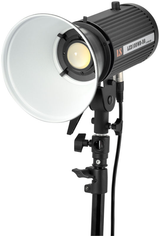

scotchtape Posted March 12, 2017 Share Posted March 12, 2017 If you want to try cheap LED fresnels there's a few options: - Godox SL series (unsure of actual CRI values), must buy fresnel attachment like Nanguang NG-10X or Aputure fresnel. - The similar model is Jinbei EF series (I think they have lower CRI though) - Nanguang CN series - More expensive = Rayzr 7 - Smaller, cheaper, and might work if you are very close are the Came Boltzens and Fotodiox J-500 - Other stuff in UK, I'm in NA so I didn't look into them like the intellitech or whatever. I am taking a chance on the Godox series because they are the cheapest lux per $. But you have to mod them by replacing fan because it's relatively loud. Hopefully someone will measure the actual CRI and TLCI at some point. I am waiting to find a good deal on a spectrometer. The Boltzens stats also seem very competitive so look into those too, but I am not sure how they measured the lux values, it seems to be an open face measurement. If so when spotted down should be really bright. The Fotodiox seems to be very weak based on their stats. All you need is a point light source. Even a small LED panel casts some pretty harsh shadows if you put it more than a few feet away from subject, but they usually have low output and can't compete with ambient. The monolight design with reflector also works if you don't want to get the fresnel attachment, but the fresnel really helps focus the light and boost output when spotted down. Gregormannschaft 1 Link to comment Share on other sites More sharing options...
