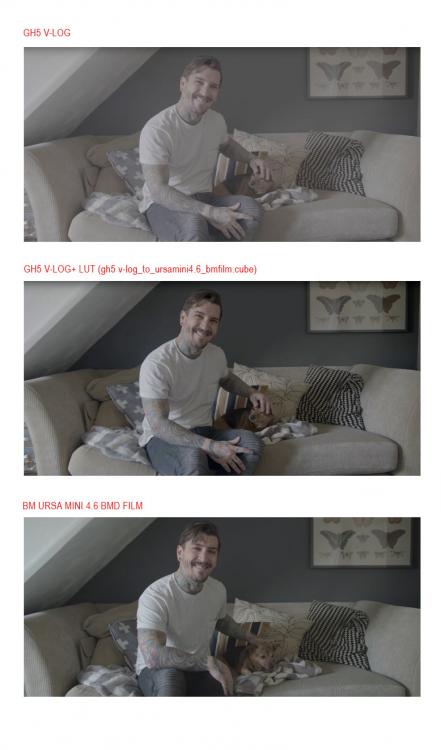

Some off the cuff comparisons between um4.6 and gh5.
Would like to see skin off different types of interior lights, wide and cu, and also mixed lights.
Unfortunatelly he didnt said which codec he used with UM46K. One of the strongest features of UM46K is compressed 4.6K raw, not prores so i would like to see how the cameras best codecs compares: 4:1 4.6K raw 60fps vs 10 bit vlogL h.264 30fps (and vs 8bit 60fps) - i would like to see shadow/highlight recovery abilities with the best codecs of both cameras (there is really lots of recoverable information in UM46K highlights).
ok, he now answered, that  it was prores HQ UHD422 on UM46K.
So we can see, that GH5 is holding up nicely with dynamic range until you unleash RAW in UM46K and play with shadow/highlight sliders in resolve. Than you can gain additional DR steps where GH5 codec is struggling and cannot really keep up. Raw settings in resolve with highlight/shadow, midtones etc. are much better than just using curves on compressed codec, gives much more clarity according to my tests. It is nice to see that 10bit GH5 codec looks the same like UM 10bit prores HQ422. I wonder what about UM 444 12bit proress though...
