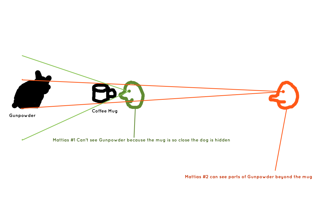

Super Members BTM_Pix Posted October 30, 2016 Super Members Share Posted October 30, 2016 1 hour ago, Mattias Burling said: No this is not about Depth of field. It never was about depth of field. I suggest rereading my posts or just letting it go. Its not about exposure either. A 50mm f1.8 on a s16 has the exact same dof as it does on a FF from the same distance. The exposure is also the same. So is the compression/separation.Switch to an equivalent lens and the compression/separation changes accordingly to the focal length. Its simple physics. Exactly. And this is the salient point here. Go and actually put a 200mm f2.8 on a M4/3 and then put a 400mm f2.8 on a FF and point them at the same thing. They'll look completely different. This web page is actually a decent source for it and the differences would become even more obvious with longer lenses than the 58 and 85mm used there. http://neilvn.com/tangents/full-frame-vs-crop-sensor-cameras-comparison-depth-of-field/ Link to comment Share on other sites More sharing options...

Super Members BTM_Pix Posted October 30, 2016 Super Members Share Posted October 30, 2016 29 minutes ago, hyalinejim said: Well, yes, of course because the aperture is not equivalent even though the focal length is. When comparing sensor sizes you multiply the focal length and aperture of the smaller sensor camera to give the equivalent focal length and aperture of a full frame camera that would give an equivalent angle of view and depth of field from the same viewpoint. Apologies for adding to the confusion, I was referring to the spec of the lens being a 2.8 rather than that the actual aperture that has been set. Link to comment Share on other sites More sharing options...

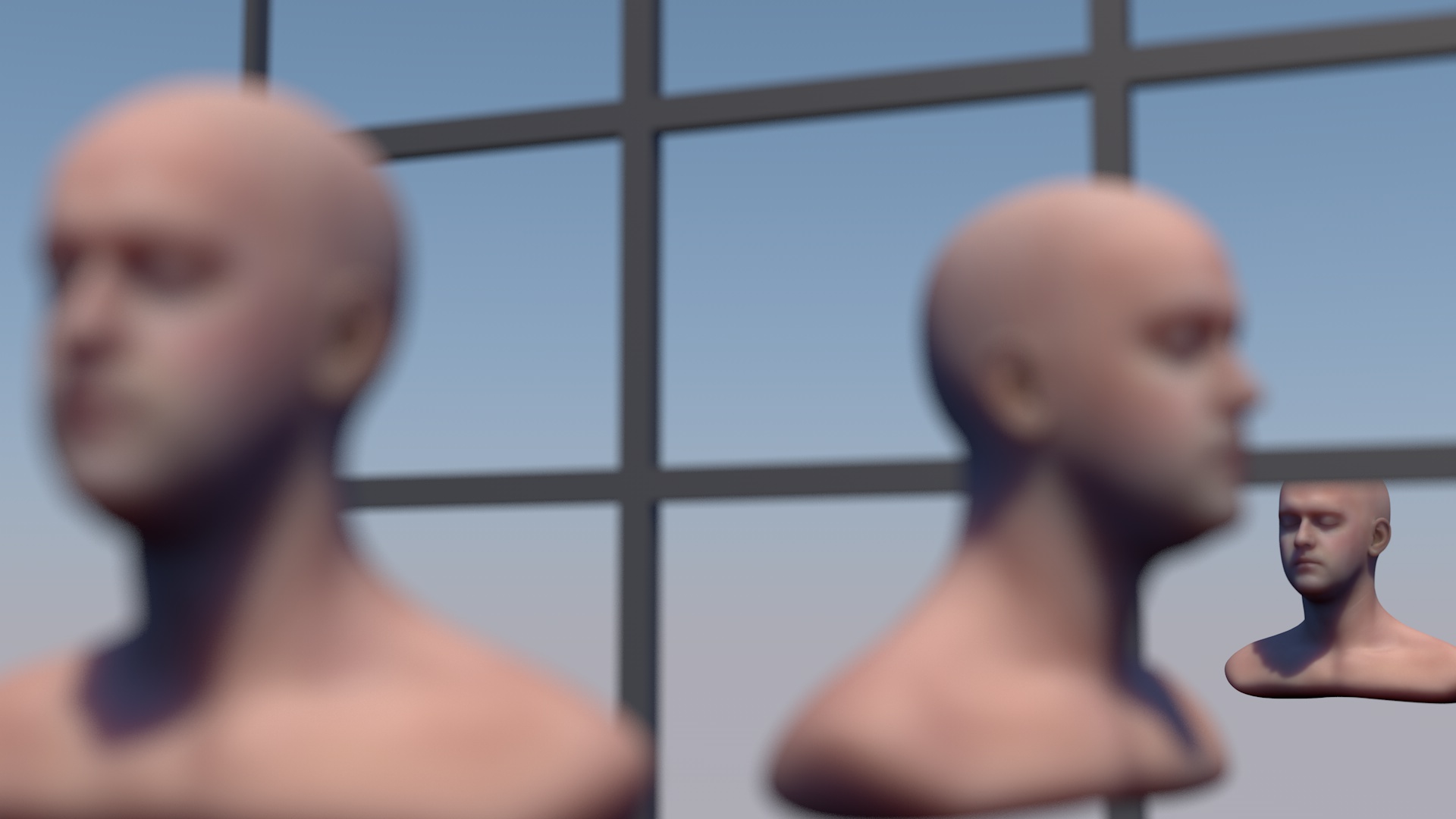

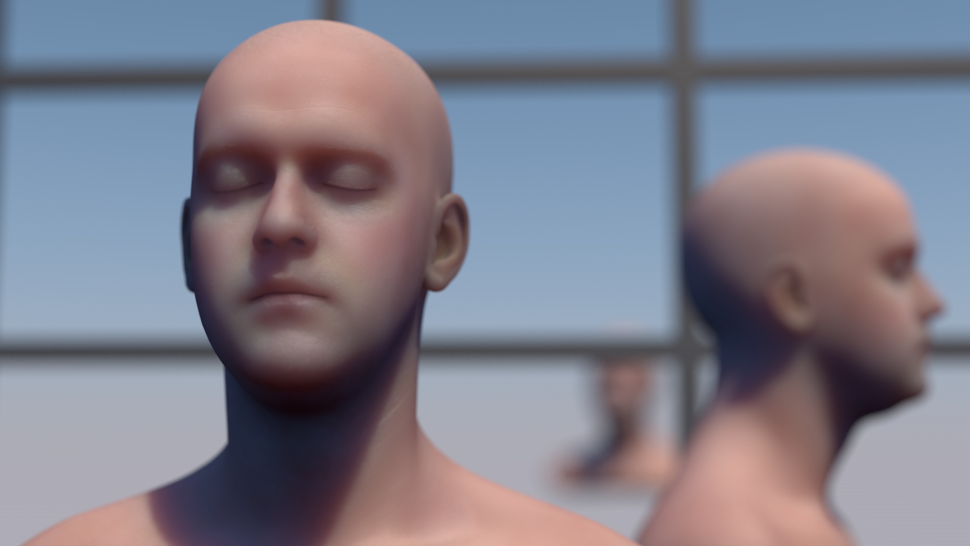

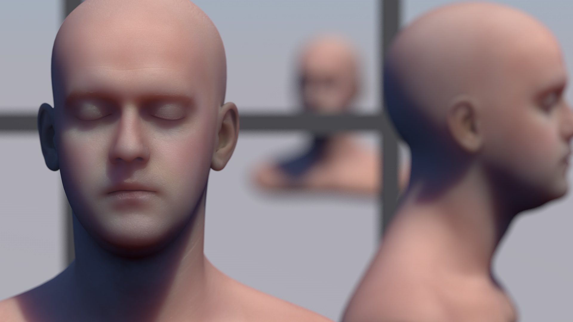

bunk Posted October 30, 2016 Share Posted October 30, 2016 On 29/10/2016 at 3:58 PM, Mattias Burling said: I will give you $100 it they turns out exactly the same. In Cinema 4D I set up 2 cams. A FullFrame Camera driving a Crop camera. I used releas 13 which is from around 2010, way before the whole Northrup discussion The Xpresso above is based on Crop x Focal Lenght, Crop x Aperture and (crop)squared x Iso. Resulting in for instance the properties below. Three different points of view. 2 x a 50mm f1.4 and 1x 105 mm f2.8 lens in FF You can check them in Photoshop, or better render them out yourself (file attached, Download the demo) but I'm pretty sure they are to the pixel precise. Let me know how to contact you so I can give you my Paypal info. CinemaFile.zip DPC, Don Kotlos, Timotheus and 4 others 7 Link to comment Share on other sites More sharing options...

tweak Posted October 30, 2016 Share Posted October 30, 2016 I don't think anyone was arguing the math... These CGIs are useless, they show us nothing of sensor difference only equivalence of focal length and aperture, which as far as I can tell everyone had agreed on. Link to comment Share on other sites More sharing options...
Timotheus Posted October 30, 2016 Share Posted October 30, 2016 4 minutes ago, tweak said: I don't think anyone was arguing the math... These CGIs are useless, they show us nothing of sensor difference only equivalence of focal length and aperture, which as far as I can tell everyone had agreed on. I'm pretty sure Mattias didn't agree with what @bunk proves ;-) What kind of sensor differences do you mean exactly? Noise, bit depth, resolution etcetera? Sure there can be differences in technical picture quality, but as shown above: framing and DOF can be made identical while shooting from the same spot with different sensor sizes...by using equivalent lenses. Link to comment Share on other sites More sharing options...
