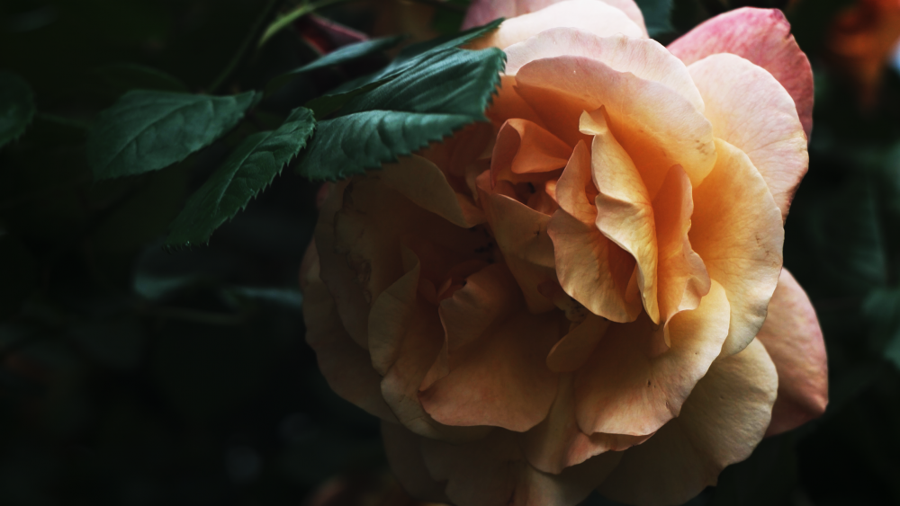

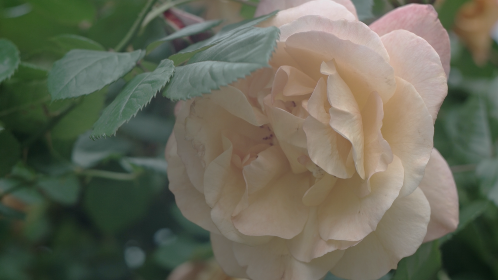

SMGJohn Posted May 15, 2016 Share Posted May 15, 2016 3 minutes ago, kinoseed said: I included the 2.5K as option to be set on the DC channel (for testing), and ran a few test shots today, and looks like there is no difference from when being on VGA, so I will pull that option in the next release. However with regard to the "interlacing" you are talking about, I get it only once in a while - maybe once in 50 recordings. 2.5K does exhibit more problematic artifacts indeed, and increasing the bitrate does not help here, however it's far from "useless", well... I guess it's a matter of personal preference. here is an example from today's 2.5K / 180Mbps test out of camera: applied RGB curves only: I might be overreacting a bit, artefacts is something I rather not have in my videos but its something I can live with if its not as visible and the bonuses outweight its downsides. After all, with no NR being applied and no digital sharpening is definitely enough for me to continue shooting 1440p25 which looks bloody gorgeous. But the interlacing look alike artefacts appear more frequent for me for some reasons, I have no idea what causes them, maybe its the heat? Its around 20 - 30 degrees over here so I am giving the camera some workout, I use 140mbps I noticed with DC it uses the pro setting which was set to 150mbps for some reasons the NX500 wont do 160mbps on my 128GB Lexar card but it will do 160mbps on my NX1 just fine but 24fps is not in my taste definitely. Also did the NX500 have NR applied in UHD and 4K mode before your hack is applied? Because as I stated earlier on page 64, UHD and 4K seem to lack the presence of NR and have similar noise patern like the 1440p mode, is this something you can confirm? Or was it already there before the mod was applied? outerbeat 1 Link to comment Share on other sites More sharing options...
kinoseed Posted May 15, 2016 Share Posted May 15, 2016 18 minutes ago, SMGJohn said: I might be overreacting a bit, artefacts is something I rather not have in my videos but its something I can live with if its not as visible and the bonuses outweight its downsides. After all, with no NR being applied and no digital sharpening is definitely enough for me to continue shooting 1440p25 which looks bloody gorgeous. But the interlacing look alike artefacts appear more frequent for me for some reasons, I have no idea what causes them, maybe its the heat? Its around 20 - 30 degrees over here so I am giving the camera some workout, I use 140mbps I noticed with DC it uses the pro setting which was set to 150mbps for some reasons the NX500 wont do 160mbps on my 128GB Lexar card but it will do 160mbps on my NX1 just fine but 24fps is not in my taste definitely. Also did the NX500 have NR applied in UHD and 4K mode before your hack is applied? Because as I stated earlier on page 64, UHD and 4K seem to lack the presence of NR and have similar noise patern like the 1440p mode, is this something you can confirm? Or was it already there before the mod was applied? honestly, those cameras are a bit like a black-box, and you never quite know what and why they do it. if your 2.5K turns out "interlaced" is absolutely useless. imho, it is not really interlaced, but looks like it, and you will not be able to fix it. It is not the temperature, as in the span of 15 min, I shot 4-5 clips, and only one was "interlaced". Why - no idea. I don't think I changed the settings then. My own camera can't be used as a reference as it has been messed with extensively, however I noticed that @outerbeat's video looks much more NRed, and at least here (on my nx500), the effects of NR are far less noticeable. In the mod there isn't anything that specifically changes NR. However especially at ISO 3200, I get quite a nice grain, which does not look NRed at all (at least at the very high frequency) I though that it may be due to the different models, and the NX1's are the one suffering a lot from NR, but if you notice fine grain on NX1 footage, maybe it's something else. edit: if you have noticed it only on the NX500, and is different than before, the only difference from NX1is setting the VGA to 2.5K, which I'm not sure how may affect it, but there is also the "silent shutter" which you probably have enabled (but if it affects the NR - I don't know). outerbeat and SMGJohn 2 Link to comment Share on other sites More sharing options...
