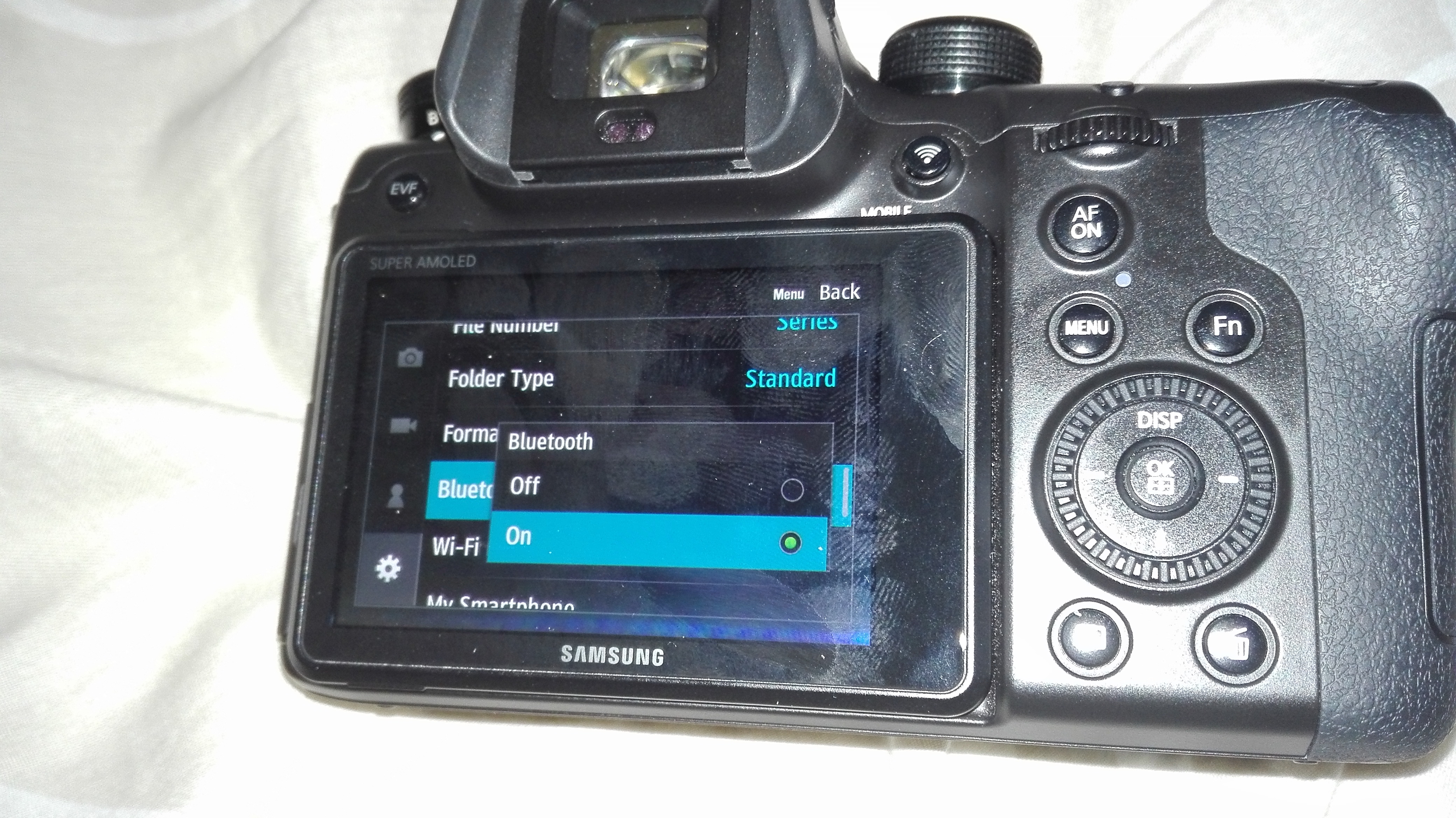

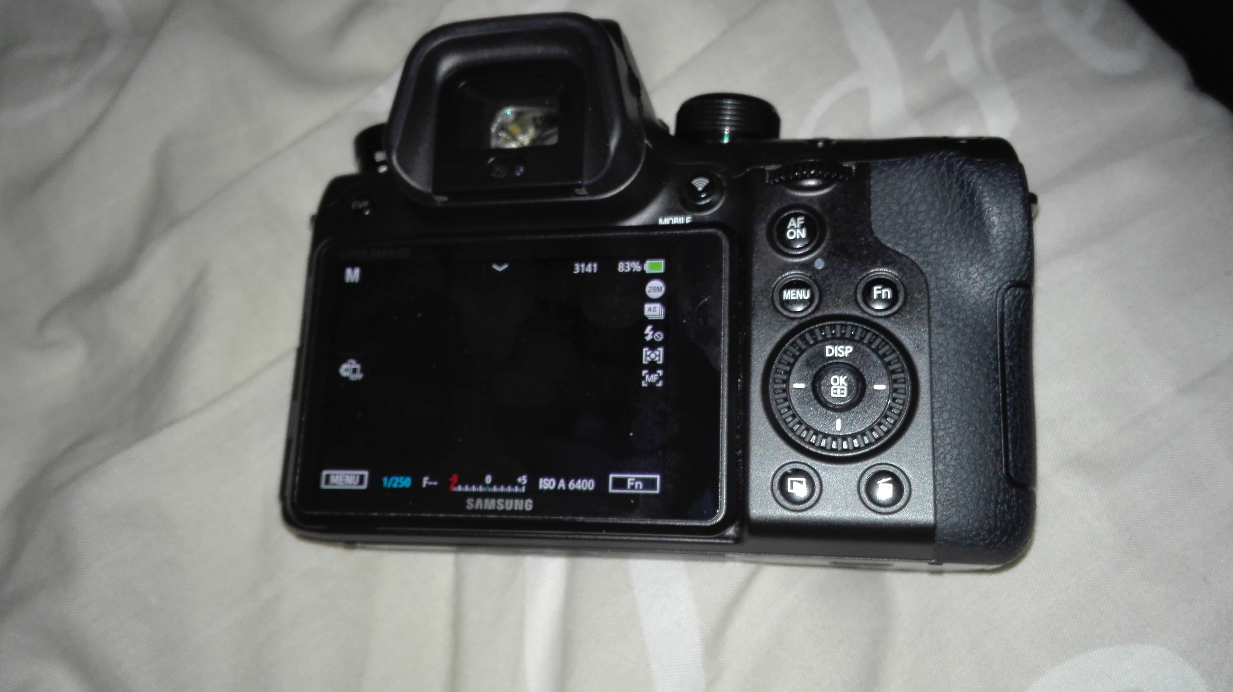

thanks folks, let me put down what i can see, i appreciate your input.
body firmware is at 1.40.
if i look at your screen, i see a difference in that I have no BT icon at the top of the screen. reset all defaults in the menu, and re-installed the mod version you linked to...
here are the screen shots of how your screen is different, and how my menu says BT is ON
Yes, confirmed, press EV (hold) click ok, then release both.
the only other thing I can think that different is I dont have a lens to attach yet, I will have that tomorrow.
it i look at your screen, i see a difference in that I have no BT icon at the top of the screen. reset all defaults in the menu, and re-installed the mod version you linked to...
It would not install if you didn't have the correct firmware, so you don't have to worry about that.
If after boot, you see something like [Mod V1.xx], that means Mod is loaded.
Now check the key-scan. Press EV_UP, if it works you will get a message "Preset missing"
(I wonder if the keyscan didn't load for some reason, or your buttons are mapped differently)
