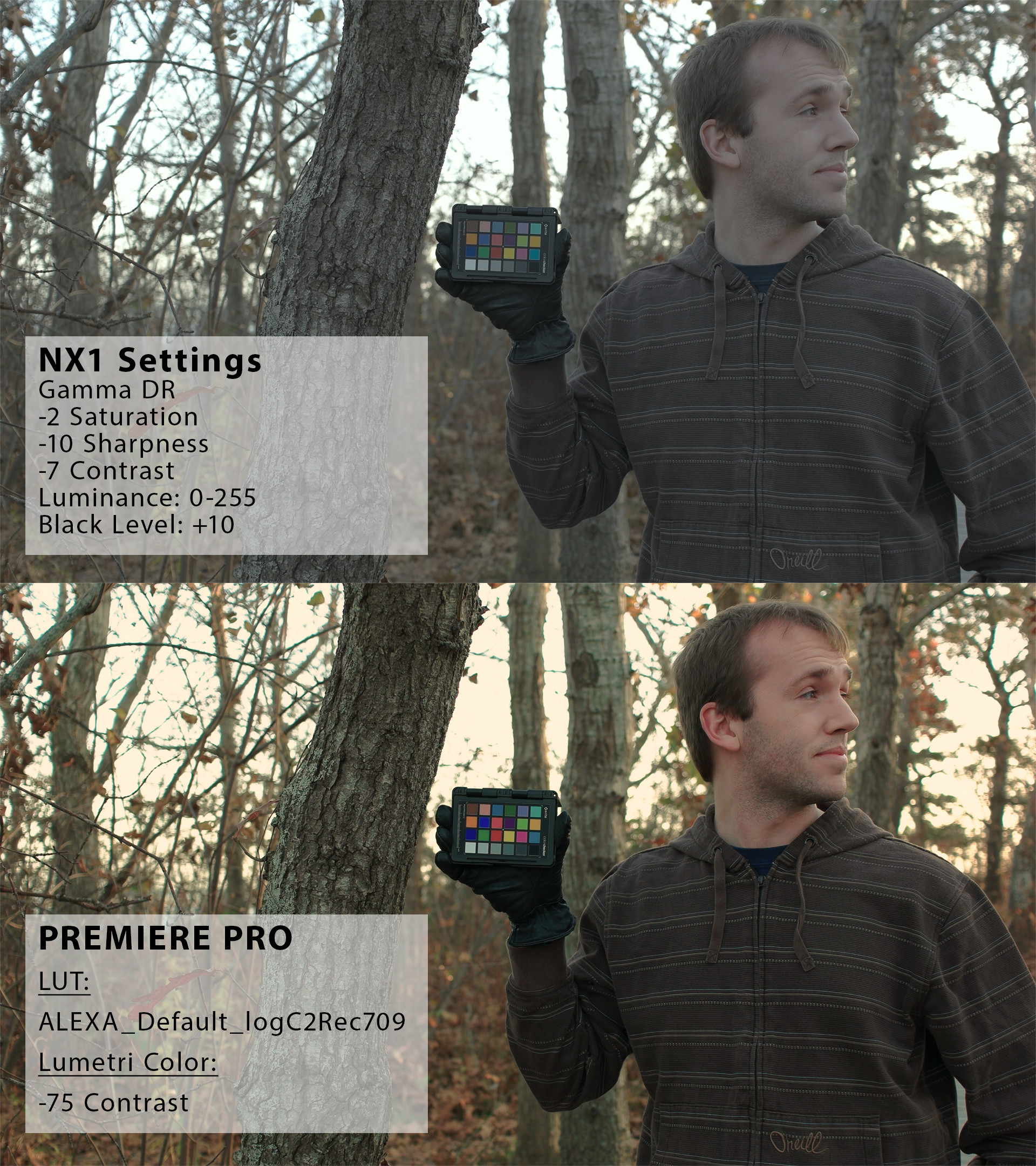

Geoff CB Posted November 22, 2015 Author Share Posted November 22, 2015 Not my test but interesting settings. One of the things that I think seems to be happening is that if you reduce contrast or increase black level to much you get banding in the colors. However, color get back to proper levels if you decrease saturation alongside decreasing contrast. Link to comment Share on other sites More sharing options...
