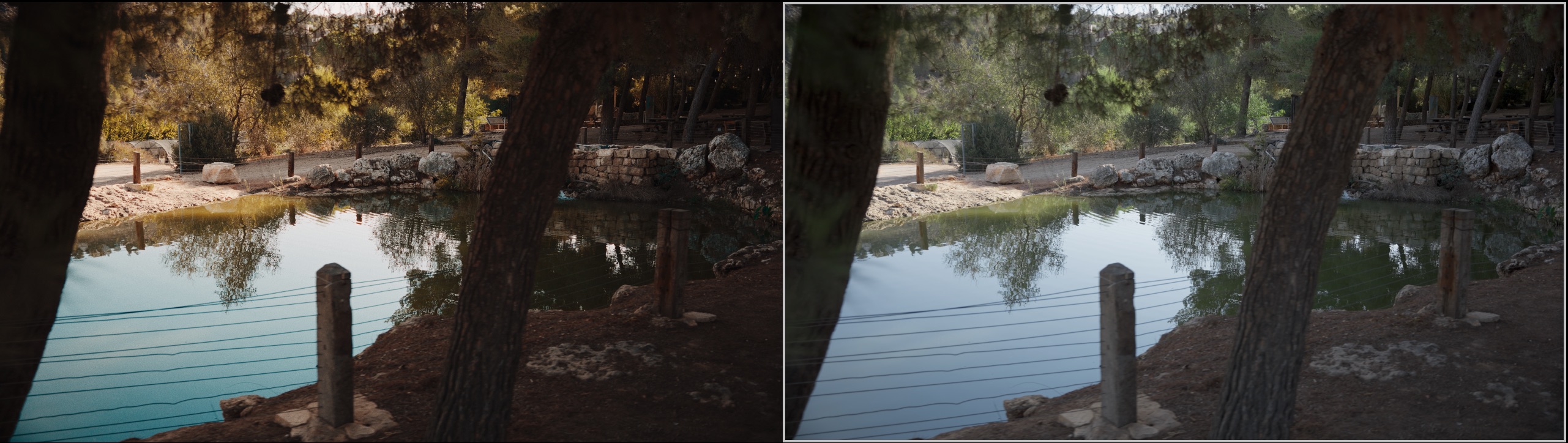

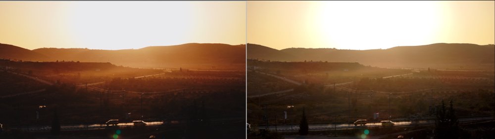

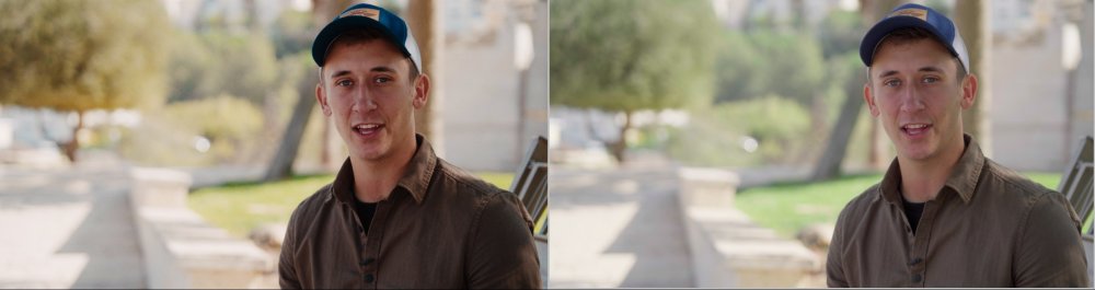

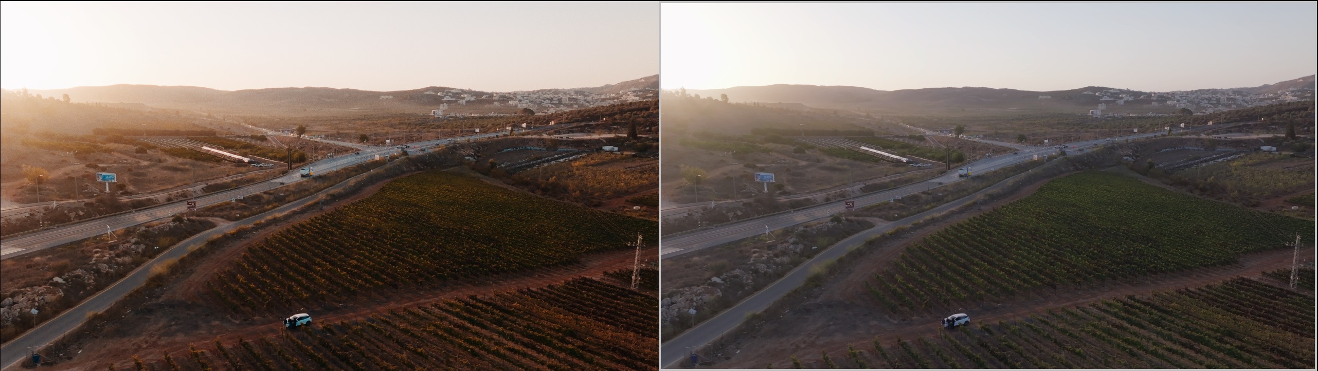

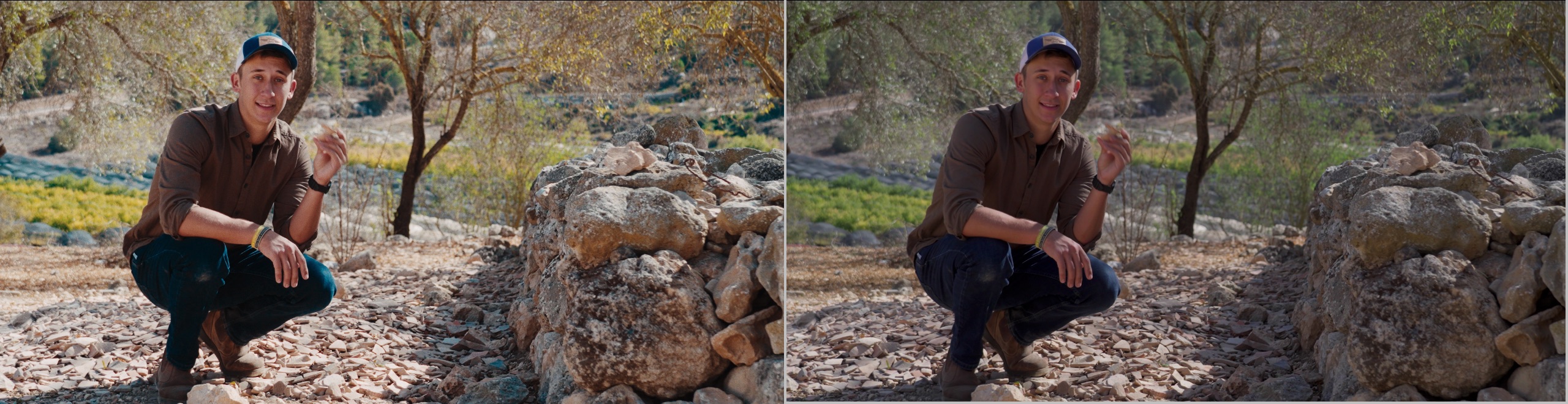

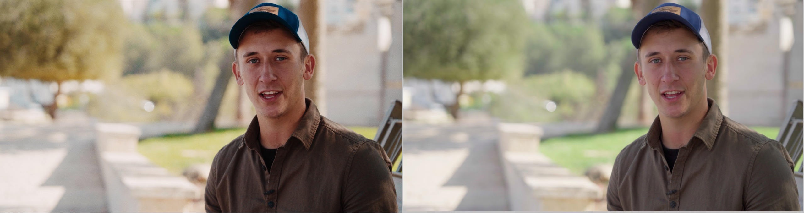

Benjamin Hilton Posted October 16 Share Posted October 16 16 hours ago, kye said: It's great to hear that the people doing real work have taken the time to build a custom look for themselves. Just another reminder than the muppets on social media aren't really representative of how real people use cameras. Yeah we've taken a lot of time to create a film look that gave good color, but also just kind of works. When using footage in a doc from a lot of different cameras, archive stuff etc. a lot of film looks can break easily. We also wanted something that while invoking film, was also not too strong. Below are some side by sides, the images on the left are the look we developed, and the versions on the right are a standard CST: eatstoomuchjam and kye 2 Link to comment Share on other sites More sharing options...
