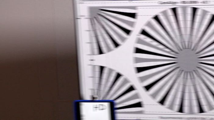

Lintelfilm Posted October 12, 2016 Share Posted October 12, 2016 On 10/11/2016 at 1:08 AM, hyalinejim said: Yes, I see it and it's not pretty! I noticed it first in HD (after firmware update) and to a lesser extent in 4K. Switching between IS modes makes no difference but it does increase with ISO. It makes HD footage unusable at 3200 if there's any movement of high contrast areas. The DV Info review points it out and theorises that the ghosting artifacts are due to an in-camera temporal noise reduction. The reviewer spotted it during a rolling shutter test: Now that I've seen it in my own footage I can't unsee it! It seems to even be present, but very subtly, at 500. Whack up the ISO a bit, zoom in on a contrasty line and wiggle the camera a bit. You'll see it too ? Now, I know the latest firmware "improved" high ISO performance in HD. But has it caused a worsening of ghosting? I took only a handful of shots before updating so I can't really check for sure. Of course, the sensible thing would be to have an option to disable all noise reduction but... it's Canon. Thanks for letting me know about the DV Info review. In a bad sort of way it's good to know it's not just a problem with my unit. It hasn't destroyed any shots for me as it's fairly well hidden by motion when video is playing. On 10/8/2016 at 4:53 PM, Amook said: Here's a few clips in c-log Hd, as well as some 60p shots. I'm not a very good at color grading so I know it could be better. I had my daughter in a pack on my back of all these shots so the stabilization helped a lot. A fine example of what this camera is great at. I must remember to use HD mode more!! Link to comment Share on other sites More sharing options...

hyalinejim Posted October 12, 2016 Share Posted October 12, 2016 I honestly can't see the difference between the various IS modes and their effect on ghosting. It's just as visible with IS off. It's minimised at ISO 500 but detail still seems to get smeared when the camera moves. Time for a good ol' Lets Petition Canon Party? Link to comment Share on other sites More sharing options...
Amook Posted October 12, 2016 Share Posted October 12, 2016 I have to agree. I see it often and think it's something canon could probably fix. Link to comment Share on other sites More sharing options...
mercer Posted October 12, 2016 Share Posted October 12, 2016 I haven't seen it once, but I mostly shoot in HD on the wide end, but I exclusively use 5-Axis and I have whipped the camera around fairly fast. If I'm not mistaken I remember reading in the manual that ghosting can occur on the long end, but it seems you guys are noticing it even on the wide end? If it's ISO related, then I may never notice it because I rarely go higher than 500. Link to comment Share on other sites More sharing options...
hyalinejim Posted October 12, 2016 Share Posted October 12, 2016 I think it's quite likely that it's less noticeable on the wide end because there is generally less motion within the frame when shooting wide. If you were to do a whip pan or have a speeding object move through the frame, you would see ghosting at 24mm. Canon's spiel is BS. It's not IS related, it's not (directly) focal length related. It's a shitty temporal NR process which can't be switched off. Link to comment Share on other sites More sharing options...
