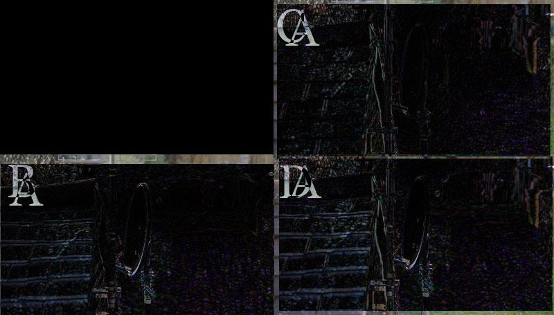

jcs Posted February 21, 2015 Share Posted February 21, 2015 I prefer the way a longer lens separates the in and out of focus areas of a frame.Hey Rich- the math doesn't predict this and I haven't seen it in practice. The closest example I found online was this comparison:http://neilvn.com/tangents/full-frame-vs-crop-sensor-cameras-comparison-depth-of-field/He didn't adjust the aperture correctly for the FF lens: he used F2.8 for both. He should have used 2.8*1.5 = F4.2 (or F4) and adjusted ISO up on FF by 1.5^2. In that case the images, which already looks pretty close, would be as identical as possible in this case with these lenses. It's true that the FF camera gets more shallow DOF with the F2.8 lens, but there's nothing inherent in the FF sensor that gives it a look advantage in this case. Link to comment Share on other sites More sharing options...

richg101 Posted February 21, 2015 Share Posted February 21, 2015 Hey Rich- the math doesn't predict this and I haven't seen it in practice. The closest example I found online was this comparison:http://neilvn.com/tangents/full-frame-vs-crop-sensor-cameras-comparison-depth-of-field/He didn't adjust the aperture correctly for the FF lens: he used F2.8 for both. He should have used 2.8*1.5 = F4.2 (or F4) and adjusted ISO up on FF by 1.5^2. In that case the images, which already looks pretty close, would be as identical as possible in this case with these lenses. It's true that the FF camera gets more shallow DOF with the F2.8 lens, but there's nothing inherent in the FF sensor that gives it a look advantage in this case.I suppose the reason for the difference is that generally from what I see an 85mm at f2.8 is almost always sharper than a 50mm at f2. Since the 85mm will be used on full frame, the full frame setup has the advantage in sharpness of the in focus subject. as a result the actual ratio between in focus and out of focus is greater.Also, from my experiences using usually full frame lenses on both full frame and aps-c/s35 on a full frame sensor the whole image circle is being utilised to deliver the sensor resolution. Assuming a full frame lens wide open will resolve 30lp/mm on a full frame sensor the horizontal resolution 36mm x 30x30 = 2160px. crop into that for s35 and you only have 1440px of horizontal resolution. So assuming the actual lenses are full frame lenses - an 85mm on the full frame sensor, and a 50mm on a s35 sensor, the 50mm will project the same fov as the 85mm but the actual overall line pairs is divided by 1.5 on s35. The difference is less obvious when true s35mm lenses are used on the frame they're designed for. The sigma 18-35 f1.8 for example will outresolve most full frame lenses. Then we have speed boosters - which compress the resolution down onto a smaller area, so if there was a 'optically perfect' speed booster available you could take the 30lp/mm full frame lens and compress it by the 0.7x and have around 45lp/mm of resolving power onto your s35 sensor. Unfortunately no commercially available speed boosters allow optical perfection so some of the lens resolution is lost. Still the delivered resolving power onto the s35 sensor is normally more from a 50mm + speed booster than the resolution from a 35mm lens without a focal reducer. The only real way to properly illustrate the difference would be to take a m4/3 camera and a 25mm lens and put it against a 645 camera and an 80mm lens. The 80mmbeing set at f2.8 and the 25mm lens having to be set at something like f0.7 to get the same amount of defocus. Quite obviously the 80mm will blow the 25mm lens out of the water in terms of sharpness. Nick Hughes 1 Link to comment Share on other sites More sharing options...
