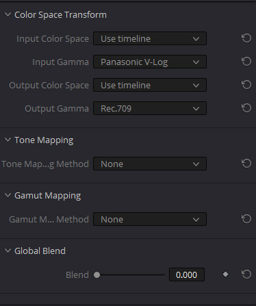

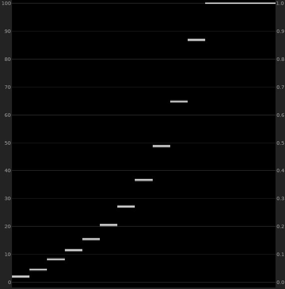

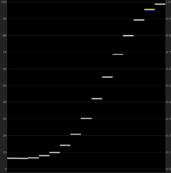

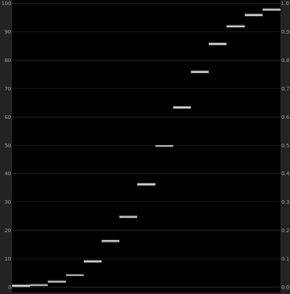

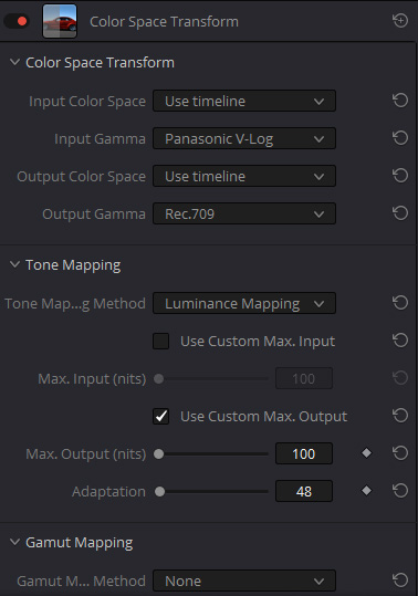

Popular Post hyalinejim Posted January 12, 2023 Popular Post Share Posted January 12, 2023 As I was watching the S5II reviews I realised that people are taking the same V-Log files and ending up with very different colour results. I guess there are four main approaches - use the colour in the file untouched, use Panny's LUT, use Resolve's Rec709 conversion, or use a third party LUT. This post compares the accuracy of each and discusses the trade-offs that might be made. This applies to the GH6 and any other Panasonic cameras that share a similar color palette. I'll be using extracted colour patches from a colour target. This is how the chart looks in reality: Below, I match the gamma of a GH6 V-Log shot of this chart and then look at the results. Open in paired tabs on a monitor and flick back and forth to compare. 1. Don't transform the colour, just add contrast: You can see here by comparing with the original that overall saturation is way down, cyan magenta and yellow are too bright, reds are too orange, greens are too yellow and blues are too bright. Skintones are too green. I guess some people grade like this. However the colours are still in V-gamut and ideally should be transformed to Rec709. Even when I manually colour grade in Resolve so that some patches are accurate, then others are still totally off. Not recommended. 2. Use Panasonic's VLog to V709 LUT This official LUT comes with a half-assed curve as part of it. But you can separate the components using LutCalc and just get a LUT that is the colour transform only. The colour LUT must come first, before the curve, or things will go wonky. Cyans are too bright, magentas too pale, yellows too dark and orangey, reds a smidgen too bright and orangey, greens too pale and light, and blues are absolutely far too light and cyan. Skintones are slightly too pink. Despite these colour inaccuracies this is actually a good colour transform in the sense that as far as I have looked I have never spotted any colour weirdness in the image like banding or colour clipping. It's a slightly muted look though, and not good for landscapes - foliage, sea and sky will suffer a washed out fate here. 3. Use Resolve's Color Space Transform to convert to Rec709 colour Note that Panasonic's official LUT is available in Resolve under the LUT menu. However, you will get different colour results using the Color Space Transform effect to convert V-gamut to Rec709. I was a little bit excited when I saw these results at first. It looked off-hand to be a bit better than Panny's conversion, especially in terms of the lightness of the blues. However closer inspection reveals that although cyans are just about right, magentas are too bright and saturated, yellows too orange, reds too bright and saturated, greens are close but deep blues are oversaturated. This colour conversion differs from the Panny insofar as it has to be applied after the curve conversion, not before. When you do this I noticed some weird colour artifacts in footage I'd shot at an aquarium. So yes, the blues are more accurate but the inaccurate Panny conversion gave an image with integrity whereas blues began to clip and go weird (even with saturation mapping). Overall, this gives more accurate and I think nicer colour than Panny. However, if I was a wedding or nightclub shooter I'd be wary of colour artifacting in strong coloured lighting scenarios. 4. Third party LUT I was interested to see if I could make a colour accurate LUT for the GH6. I gave it a go and you can check out the LUT here. The LUT must go after the contrast curve, not before! Yes, it's very accurate compared to the other approaches. When contrast is relatively moderate and the range of colours is not so saturated it looks a bit similar to the Resolve transform. However, there is much better hue accuracy and saturation control in all tonal areas, which you really notice if you crank up the contrast or have very saturated. However, I did still notice some of that colour weirdness in the aquarium shots. So it looks like Panasonic know what they're doing in terms of sacrificing colour accuracy to preserve image integrity. And I guess if total colour accuracy is what you're after you need to shoot RAW! Finally, here's a comparison on a real world image: Vgamut Panasonic Vgamut to V709 Resolve Vgamut to Rec709 (skintones are nice but note the oversaturated reds on the skirt) Custom LUT mercer, newfoundmass, Davide DB and 7 others 7 3 Link to comment Share on other sites More sharing options...
PannySVHS Posted January 13, 2023 Share Posted January 13, 2023 I built a set lut for an arri amira project. it has a nice look to it under uv, ir and various other outdoor lighting situations. Now I have been using my own flashy lut for other projects with Mavo LF and Lumix S Vlog material and it is neither accurate nor keeps colours intact. But interesting enough desaturating before and after the grading pipeline gives it back its integrety. Color correction within the node workflow gives it back its plausibility, keeping character and beauty, which this lut was built for as well. That in 70% of the cases. For 8bit Slog2 on the FS700 it did not work well at all.:) Oversaturated reds and blues was the problem. I did a handcurve once for SLog2 material, which beat everything I was able to achieve with the official lut or CST. So I am always open for different ways. What do you mean by curve before Gamut? Do you mean a separate gamma transform and a separate gamut tranform? How do you do that? @hyalinejim Awesome post btw. Thank you! FHDcrew 1 Link to comment Share on other sites More sharing options...

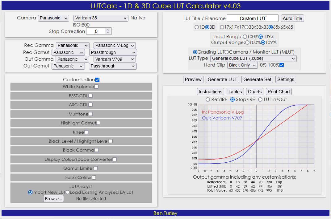

hyalinejim Posted January 14, 2023 Author Share Posted January 14, 2023 On 1/13/2023 at 12:02 AM, PannySVHS said: What do you mean by curve before Gamut? Do you mean a separate gamma transform and a separate gamut tranform? Yes, you can isolate one or the other! If you wanted to isolate Panasonic's offical VLog to V709 gamma (or gamut) you can use the excellent free online tool LutCalc (make sure Input Range and Output Range is set as below): But I find Panasonic's V709 curve to be too mild: blacks don't reach the top and bottom of the waveform and middle grey stays annoyingly at 42 IRE instead of 49 where it "should" be: In Resolve you can use the Color Space Transform effect. This is what it would look like for VLog to Rec709. These settings would blow the highlights, though: So I like this modification of the settings: This gives a decent curve with dark blacks and middle grey at the right value: Or, of course, you can use a simple RGB curve to create your own gamma curve, as you did for SLog2. But regardless of which method you use, if you're separating the gamma and gamut transforms then the order in which they're applied is very important. In the case of Panasonic's transforms, if the gamma comes before the gamut then the colours will break. For Resolve's transforms, if you put the gamut before the gamma then the colours will be a bit inaccurate. It's interesting to me because it's the Wild West out there in terms of what people are doing. I definitely think that some major YouTubers are doing things the "wrong" way, for example simply adding a curve to out of the box log footage and not transforming the gamut. Of course, if you like the results it doesn't really matter. PannySVHS 1 Link to comment Share on other sites More sharing options...
