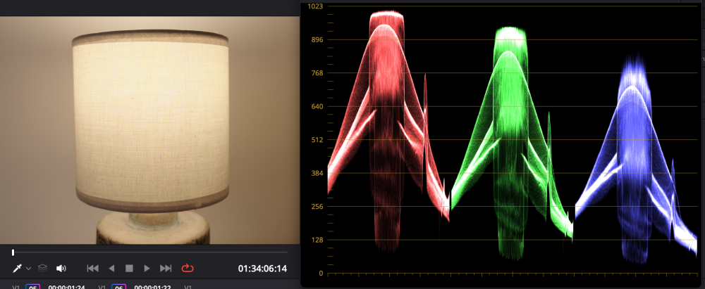

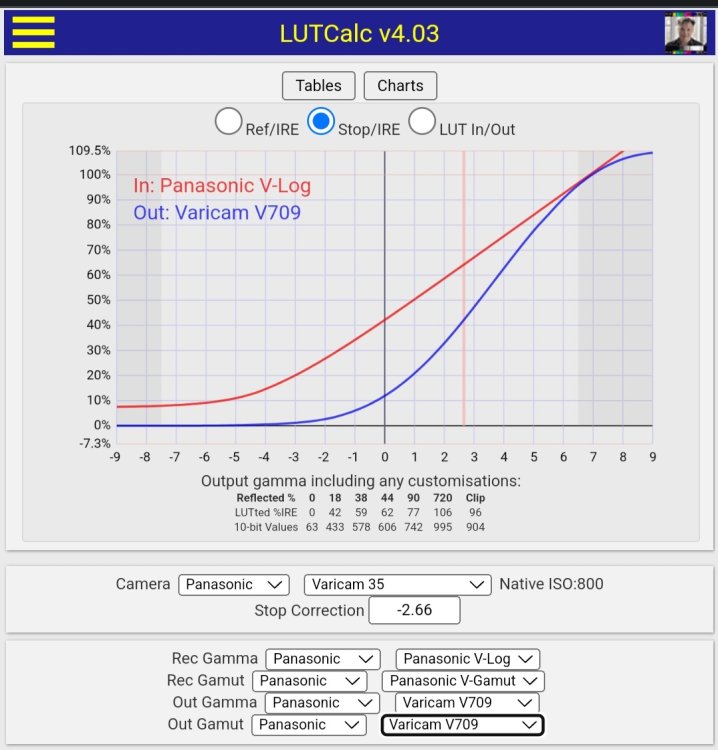

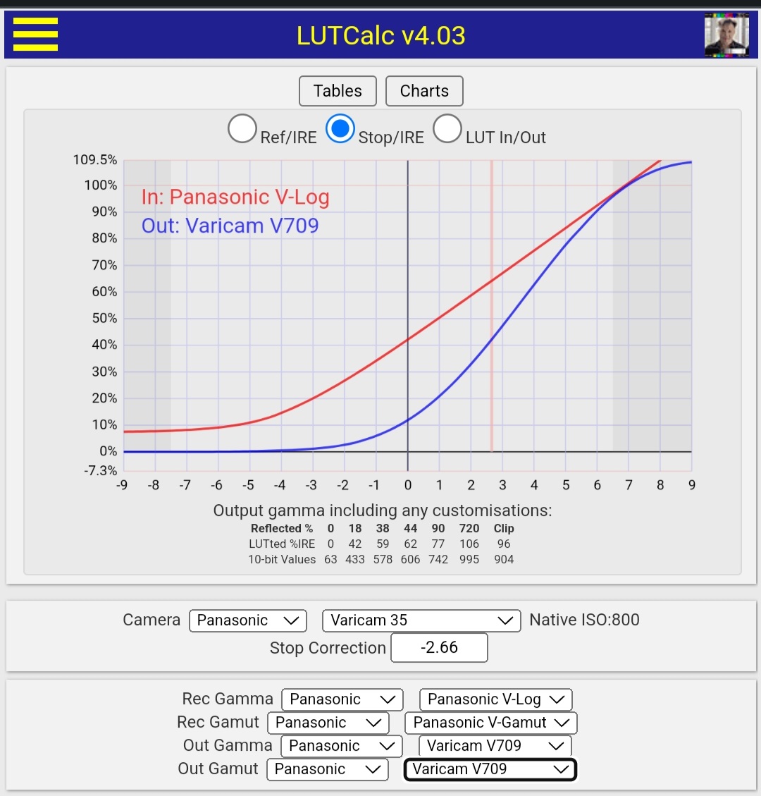

hyalinejim Posted May 22, 2023 Share Posted May 22, 2023 8 hours ago, MrSMW said: baked in Gamut V2 lut This is why you're not seeing it. A baked in LUT uses V-Log as its base picture style so it avoids the nasties that are in the regular profiles. I never use regular profiles so I don't care. But for anyone who does want to use them then a solution is to use this method. If you're after the lower noise of regular profiles then just create a lut that pushes V-Log down by 2.66 stops. And I think you can also set metering compensation. deezid 1 Link to comment Share on other sites More sharing options...
deezid Posted May 22, 2023 Share Posted May 22, 2023 32 minutes ago, hyalinejim said: This is why you're not seeing it. A baked in LUT uses V-Log as its base picture style so it avoids the nasties that are in the regular profiles. I never use regular profiles so I don't care. But for anyone who does want to use them then a solution is to use this method. If you're after the lower noise of regular profiles then just create a lut that pushes V-Log down by 2.66 stops. And I think you can also set metering compensation. I agree. If you want good looking Rec709 on the S5II avoid any of the Rec709 profiles at all cost. Use Real-Time Lut with a nice lut, preferably made for the S5II and its new colorscience and you'll get great looking results. Link to comment Share on other sites More sharing options...

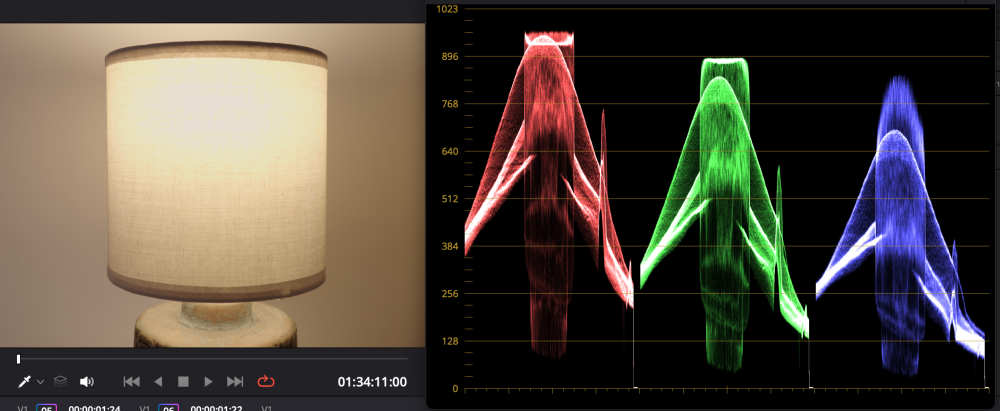

Beritar Posted May 22, 2023 Share Posted May 22, 2023 1 hour ago, hyalinejim said: This is why you're not seeing it. A baked in LUT uses V-Log as its base picture style so it avoids the nasties that are in the regular profiles. I never use regular profiles so I don't care. But for anyone who does want to use them then a solution is to use this method. If you're after the lower noise of regular profiles then just create a lut that pushes V-Log down by 2.66 stops. And I think you can also set metering compensation. It's not so simple. If you create a LUT that push V-Log down by 2 stops, you need much more light compared to the 709 profiles. Link to comment Share on other sites More sharing options...
hyalinejim Posted May 22, 2023 Share Posted May 22, 2023 Not if you ignore the meter! V-Log at base ISO 640 is simply ISO 100 pushed 2.66 stops to give extra highlight headroom. If you push it back down it should be just as clean as the regular profiles at ISO 100. So you don't need more light at all you need to re-think ISO and metering. In a situation where you would have shot Natural at 6400 you would add 2.66 stops to the ISO and shoot V-Log at 40000, then push the exposure back down with the real time LUT. You can make a lut like this right now with LutCalc: And then you will have a Rec709 file with low noise and none of the artifacts (and none of the highlight headroom, but you won't need it because you're burning in the contrast) Also, you're not limited to the V709 conversion (that curve is a bit weird IMO). You can try more contrasty curves in LutCalc, while keeping the gamut conversion. Or you can load up your favourite third party LUT, add the -2.66 exposure and re-export it. PS: It looks like Exposure Offset Adjust (to re-calibrate the meter) is limited to 1 EV maximum so with that selected you'd be looking to hit +1.66 on the meter instead of +2.66. This would be your new "zero". No light needed, just ISO. Of course above a certain level I think you lose PDAF? deezid and PannySVHS 2 Link to comment Share on other sites More sharing options...

Beritar Posted May 23, 2023 Share Posted May 23, 2023 11 hours ago, hyalinejim said: Not if you ignore the meter! V-Log at base ISO 640 is simply ISO 100 pushed 2.66 stops to give extra highlight headroom. If you push it back down it should be just as clean as the regular profiles at ISO 100. So you don't need more light at all you need to re-think ISO and metering. In a situation where you would have shot Natural at 6400 you would add 2.66 stops to the ISO and shoot V-Log at 40000, then push the exposure back down with the real time LUT. You can make a lut like this right now with LutCalc: And then you will have a Rec709 file with low noise and none of the artifacts (and none of the highlight headroom, but you won't need it because you're burning in the contrast) Also, you're not limited to the V709 conversion (that curve is a bit weird IMO). You can try more contrasty curves in LutCalc, while keeping the gamut conversion. Or you can load up your favourite third party LUT, add the -2.66 exposure and re-export it. PS: It looks like Exposure Offset Adjust (to re-calibrate the meter) is limited to 1 EV maximum so with that selected you'd be looking to hit +1.66 on the meter instead of +2.66. This would be your new "zero". No light needed, just ISO. Of course above a certain level I think you lose PDAF? I must doing something wrong because VLog is definitely more noisy, did you crop at 1:1 to compare ? I use LutCalc and I use a Lut with -2.6 stop correction in Real Time Lut, of course my ISO value is higher in V-Log. To match ISO 100 in Natural I must use ISO 640/800 in V-log, but with this value there are more noise than Natural at ISO 100, and yet I use a curve which crush the shadows a lot. Easy to see the difference when cropping at 1:1. Both my S5 and S1 with Natural look cleaner, and this is not due to noise reduction because the footage is full of details, zero smearing, the same level of details as V-Log with these cameras. I also get banding using V-Log on the S5II, and of course the lenses correction are not applied (unlike with the 709 profiles). Link to comment Share on other sites More sharing options...
