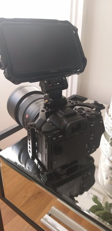

Rinad Amir Posted February 28, 2021 Share Posted February 28, 2021 My current set up, i use handle as well sometimes Quote Link to comment Share on other sites More sharing options...

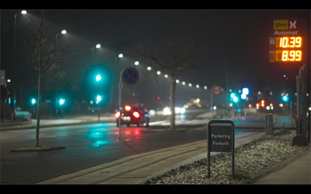

Llaasseerr Posted March 1, 2021 Share Posted March 1, 2021 On 2/18/2021 at 2:11 AM, deezid said: Another issue with Sony footage (at least lots of FX6 stuff I've seen lately) is that it's quite prone to some nasty gamut clipping in S-Gamut3.cine at least. It looks even worse than BMD footage with HR turned on. Thankfully NR doesn't seem to be a huge problem on the FX6 at last. Is there some S-Gamut3 footage showing bright saturated lights available as well? https://filmplusgear.com/sony-fx6-test-files-for-download/ Re: gamut clipping, I finally took a look at one of the shots on this guy's page. Here's a shot bought into ACES which of course has a larger gamut than sgamut3.cine, then it's remapped to display on a P3D65 monitor. I would say that the issue you're seeing is that on the web page there is no correct gamut transform from a wide gamut to something like rec709. However there is still some funkiness from the digital numbers in the top right corner. I'm not sure if that's a compression artifact, or possibly to do with chroma subsampling, or it could be something that is still out of gamut and requires something like the "Neon Suppression LMT" in Resolve. Or maybe the sensor is clipping - it looks like the red channel has hit the dynamic range limit. I have a feeling it all might have been okay if shot raw though. EDIT: It seems that behind the scenes the OS color management or the web browser is transforming it so it should display correctly on a regular sRGB monitor. Hard to tell how this will look for you though! Quote Link to comment Share on other sites More sharing options...

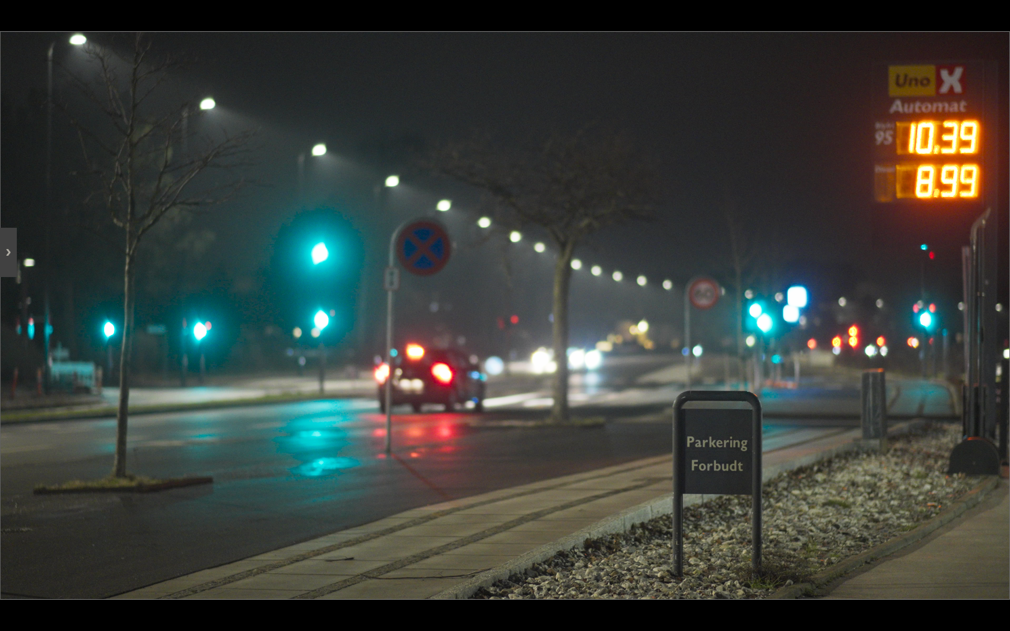

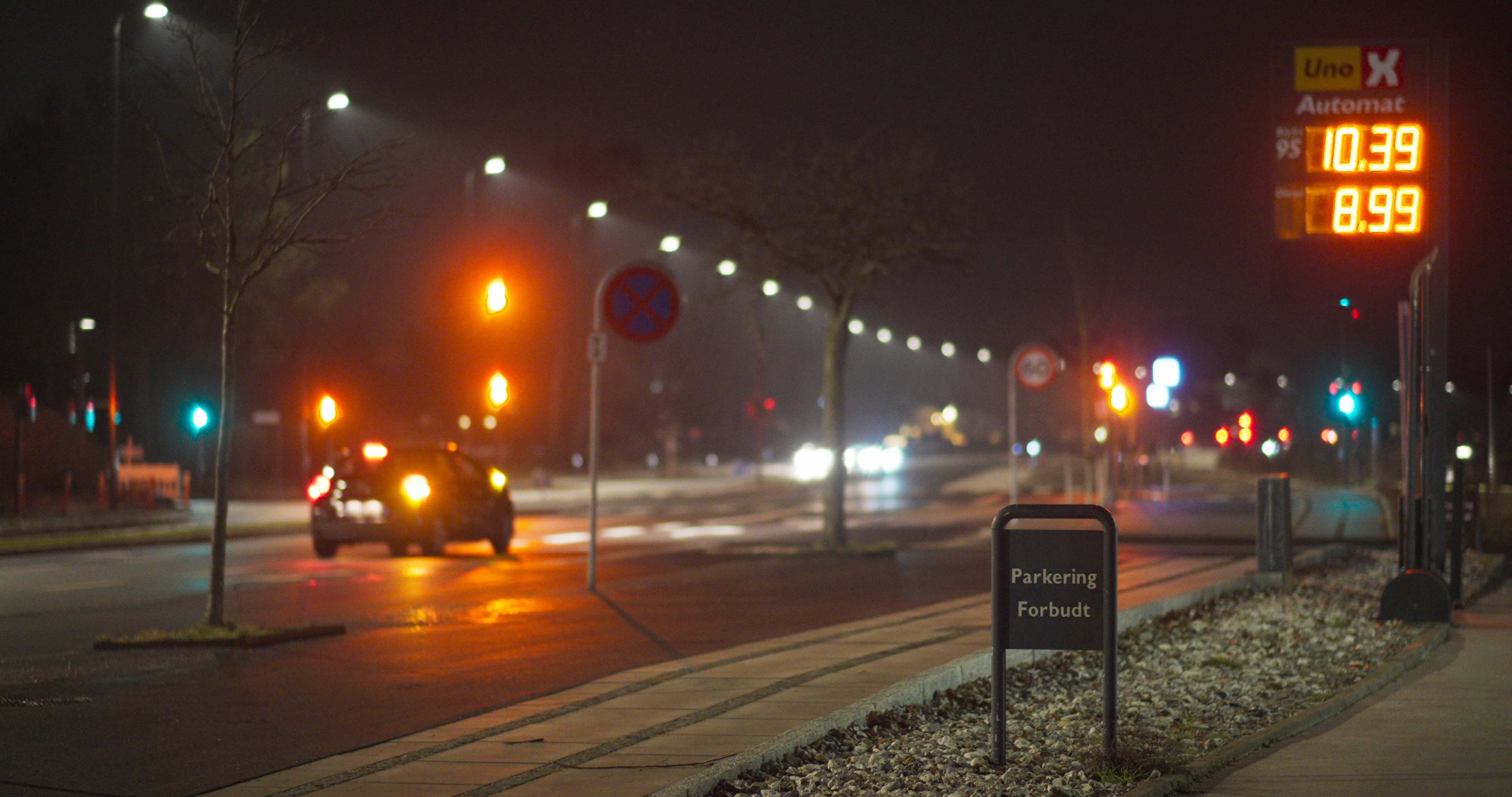

Llaasseerr Posted March 1, 2021 Share Posted March 1, 2021 14 hours ago, Llaasseerr said: Re: gamut clipping, I finally took a look at one of the shots on this guy's page. Here's a shot bought into ACES which of course has a larger gamut than sgamut3.cine, then it's remapped to display on a P3D65 monitor. I would say that the issue you're seeing is that on the web page there is no correct gamut transform from a wide gamut to something like rec709. However there is still some funkiness from the digital numbers in the top right corner. I'm not sure if that's a compression artifact, or possibly to do with chroma subsampling, or it could be something that is still out of gamut and requires something like the "Neon Suppression LMT" in Resolve. Or maybe the sensor is clipping - it looks like the red channel has hit the dynamic range limit. I have a feeling it all might have been okay if shot raw though. EDIT: It seems that behind the scenes the OS color management or the web browser is transforming it so it should display correctly on a regular sRGB monitor. Hard to tell how this will look for you though! I noticed the ugly falloff and stepiness around the blooming blue lights on the left after I posted this image. Without doing some pixel peeping in the chroma channels, I think this may be to do with chroma subsampling and lossy compression. Again, it would be interesting to shoot a scene like this in raw. You would also get the extra 2 bits in log for colour transitions, so that's 4096 vs 1024 discreet integer log steps per channel which is very efficient. It's not that I think raw is a panacea, but it does everything that something like a log encoded ProRes444 does and a little bit more. For me, the bench mark is always a film scan and then Alexa log C. And tbh I did not have any plans to shoot with any of these Sony cams in anything but raw, unless absolute convenience was required. I really wish more cameras shot internal raw or log ProRes444. Quote Link to comment Share on other sites More sharing options...
deezid Posted March 1, 2021 Share Posted March 1, 2021 15 hours ago, Llaasseerr said: Re: gamut clipping, I finally took a look at one of the shots on this guy's page. Here's a shot bought into ACES which of course has a larger gamut than sgamut3.cine, then it's remapped to display on a P3D65 monitor. I would say that the issue you're seeing is that on the web page there is no correct gamut transform from a wide gamut to something like rec709. However there is still some funkiness from the digital numbers in the top right corner. I'm not sure if that's a compression artifact, or possibly to do with chroma subsampling, or it could be something that is still out of gamut and requires something like the "Neon Suppression LMT" in Resolve. Or maybe the sensor is clipping - it looks like the red channel has hit the dynamic range limit. I have a feeling it all might have been okay if shot raw though. EDIT: It seems that behind the scenes the OS color management or the web browser is transforming it so it should display correctly on a regular sRGB monitor. Hard to tell how this will look for you though! Try a still with orange/tungsten lights, they'll turn dark. It also happens with the Sony Venice and shows up in many shows shot on it. The same issue occured on the Panasonic S1 and the first firmware supporting V-Log, but with firmware 1.4 everything gamut and processing-related was fixed. Since it's a Sony it'll probably never be fixed and even Blackmagic does better with their near out of gamut handling since Gen 5. 18 hours ago, TomTheDP said: I wouldn’t call the Sony’s weak but the s1/s1h/s5 is definitely better. There are worse contenders indeed. Doesn't mean that cheaper cameras such as the Pocket4k, 6k (Pro) and Panasonic S5/S1 seriously outperform the A7sIII and therefor FX3 in terms of video quality. Sony is just more convenient. (screenshots: FX6 S-Gamut3.cine, ACEScct, Rec709 odt) Quote Link to comment Share on other sites More sharing options...
TomTheDP Posted March 1, 2021 Share Posted March 1, 2021 1 hour ago, deezid said: Try a still with orange/tungsten lights, they'll turn dark. It also happens with the Sony Venice and shows up in many shows shot on it. The same issue occured on the Panasonic S1 and the first firmware supporting V-Log, but with firmware 1.4 everything gamut and processing-related was fixed. Since it's a Sony it'll probably never be fixed and even Blackmagic does better with their near out of gamut handling since Gen 5. There are worse contenders indeed. Doesn't mean that cheaper cameras such as the Pocket4k, 6k (Pro) and Panasonic S5/S1 seriously outperform the A7sIII and therefor FX3 in terms of video quality. Sony is just more convenient. (screenshots: FX6 S-Gamut3.cine, ACEScct, Rec709 odt) You think the P4K outperforms the A7S3/FX3 in terms of dynamic range? Quote Link to comment Share on other sites More sharing options...
