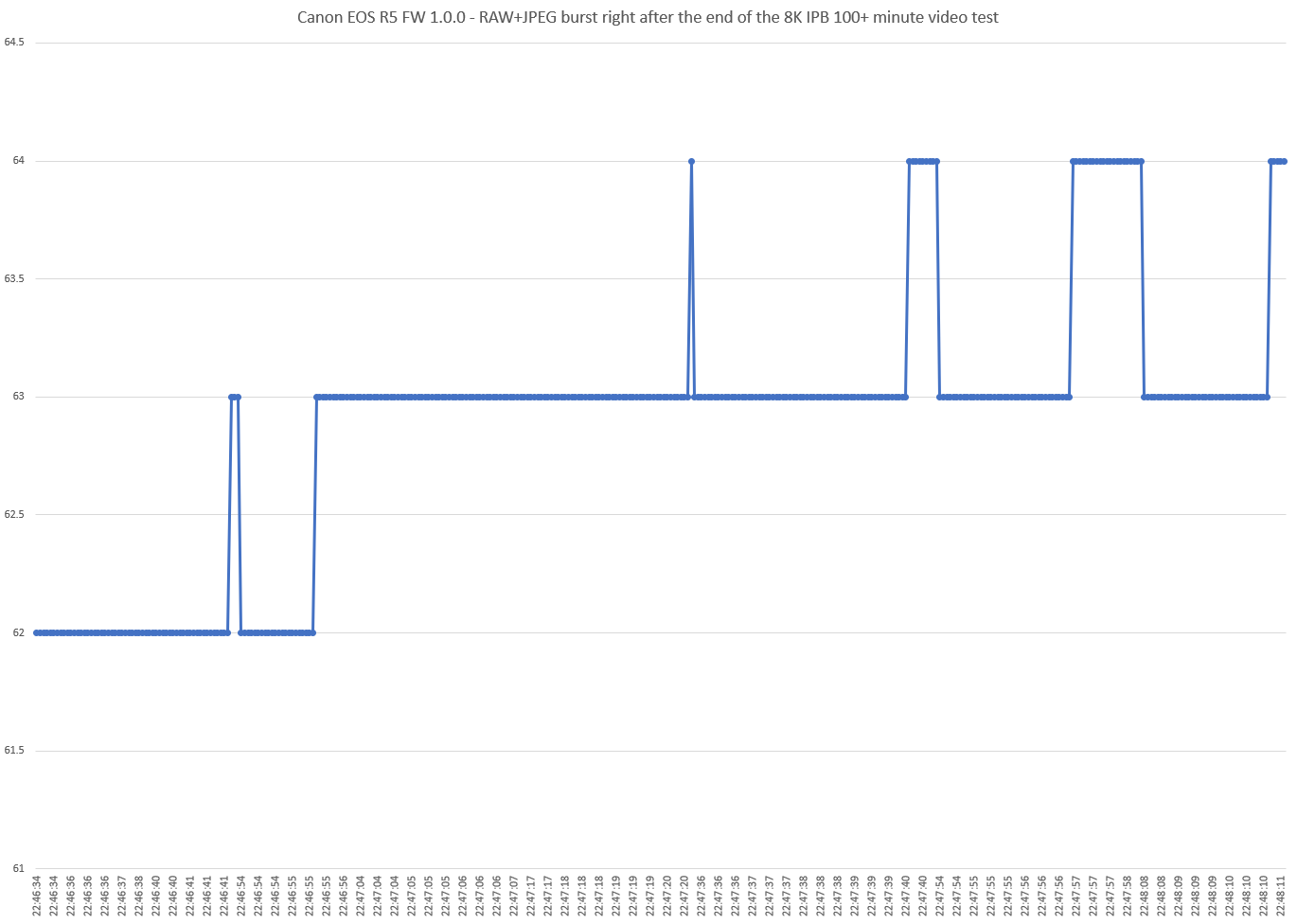

Electroholic Anonymous Posted August 26, 2020 Share Posted August 26, 2020 At the end I did not take a single JPEG, no, I hammered the buffer, guess, did the temperature get higher than the video max of 62C, or, lower? Link to comment Share on other sites More sharing options...

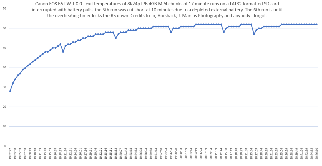

horshack Posted August 26, 2020 Share Posted August 26, 2020 6 minutes ago, Electroholic Anonymous said: My R5 survived the 1 hour and 45 minute 8K IPB SD FAT32 recording test! Peaking at 62C exif from the end of the 3rd run to the end of the 6th run. Will the FW update allow us to run 8K IPB for more or less than 100 minutes at a time? I will present the exif temps shortly and send the data to Horshack. Thanks. So the only difference between this run peaking at 62C and earlier one at 72C was the camera being on the desk? Ambient temps in your room the same as before? How warm does the bottom of the camera get? If that's a thermal conduction point maybe the desk was inhibiting it whereas it would be available to the air on your tripod. Link to comment Share on other sites More sharing options...
Electroholic Anonymous Posted August 26, 2020 Share Posted August 26, 2020 7 minutes ago, horshack said: Thanks. So the only difference between this run peaking at 62C and earlier one at 72C was the camera being on the desk? Ambient temps in your room the same as before? How warm does the bottom of the camera get? If that's a thermal conduction point maybe the desk was inhibiting it. The ambient temperature is perhaps only 1 or 2C lower, that should not make such a difference. I think it's mainly convection, and that I held it in my hands perhaps a minute at the start and end of each run earlier, and now on the tripod I did not. Ah, and that's it, I used 8K 24p now, and 8K 30 earlier, that's of course it. I specifically chose 24 p for the long test, because that is the mode I am personally most interested in. I could run the 8K30p also, we'll see. The inordinate number of RAW+jpeg's that I shot at the end produced 64C exifs after only 257 photos. So that's in line with my personal experience of the R5 feeling hotter hammering lots of stills than recording 8K. Link to comment Share on other sites More sharing options...
horshack Posted August 26, 2020 Share Posted August 26, 2020 11 minutes ago, Electroholic Anonymous said: The ambient temperature is perhaps only 1 or 2C lower, that should not make such a difference. I think it's mainly convection, and that I held it in my hands perhaps a minute at the start and end of each run earlier, and now on the tripod I did not. Ah, and that's it, I used 8K 24p now, and 8K 30 earlier, that's of course it. I specifically chose 24 p for the long test, because that is the mode I am personally most interested in. I could run the 8K30p also, we'll see. The inordinate number of RAW+jpeg's that I shot at the end produced 64C exifs after only 257 photos. So that's in line with my personal experience of the R5 feeling hotter hammering lots of stills than recording 8K. Odd that stills would get hotter. Would really like to see that verified with measurements one day. That's either the sensor (14-bit readouts for stills vs likely 12-bit operation for video), the CFE card (total data rate, or perhaps peak rate during long bursts), DIGIC (more processing for stills, which seems unlikely vs handling/compression for video), the fact you're holding the camera for stills and not video (conduction), etc... One way to eliminate the sustained rate difference is to try 8K raw. Link to comment Share on other sites More sharing options...
Electroholic Anonymous Posted August 26, 2020 Share Posted August 26, 2020 Oh Yes, I forgot someone all right, Andrew Reid, how could I, thanks Andrew!! visionrouge, Matins 2, ntblowz and 1 other 3 1 Link to comment Share on other sites More sharing options...
Electroholic Anonymous Posted August 26, 2020 Share Posted August 26, 2020 Juank 1 Link to comment Share on other sites More sharing options...

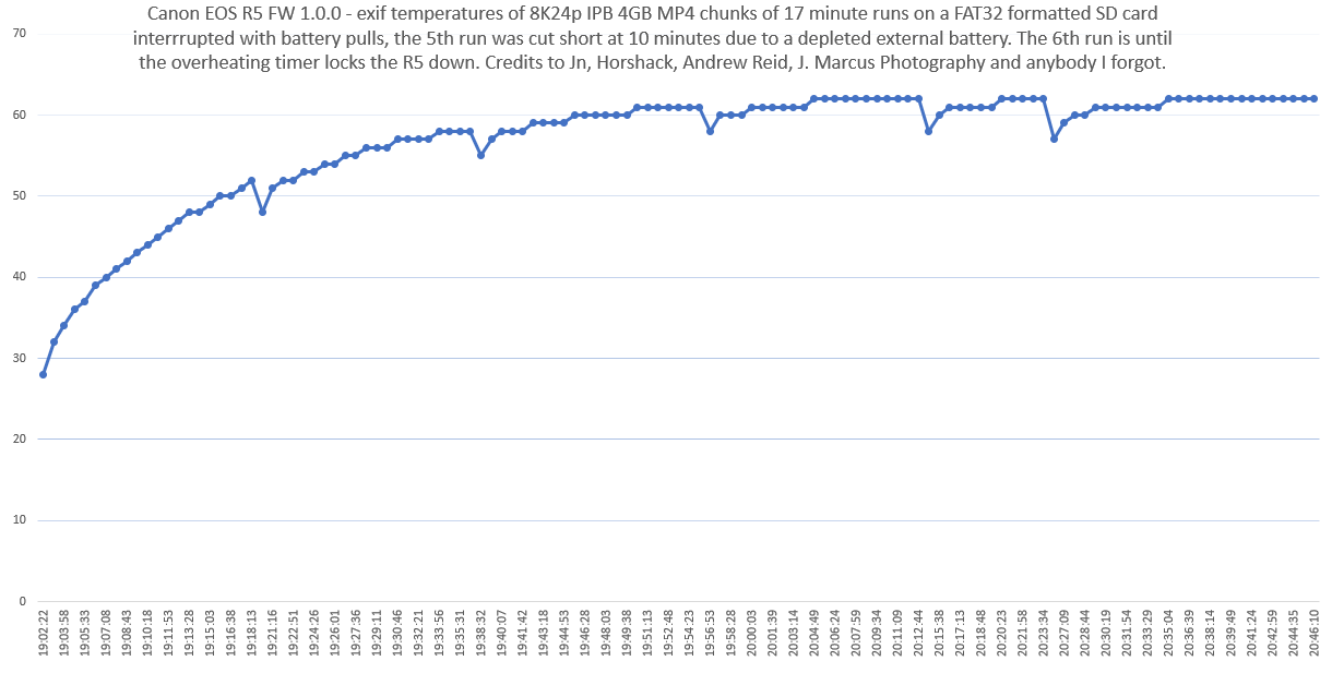

Administrators Andrew Reid Posted August 26, 2020 Author Administrators Share Posted August 26, 2020 7 minutes ago, Electroholic Anonymous said: Oh Yes, I forgot someone all right, Andrew Reid, how could I, thanks Andrew!! Where is this chart from? Is it your test data or somebody else's? Asking because I want to give credit to the right people, if I feature it on the blog. Cheers EA Link to comment Share on other sites More sharing options...
Electroholic Anonymous Posted August 26, 2020 Share Posted August 26, 2020 It is from the test I ran the past few hours. Now with your name 😉 Link to comment Share on other sites More sharing options...
Administrators Andrew Reid Posted August 26, 2020 Author Administrators Share Posted August 26, 2020 I see. The credits were confusing me, as I thought they'd contributed the data. So it's very interesting that it levels off like that. Would it be possible to change the time axis to show minutes from 00:00 instead of the time stamps? Cheers! Link to comment Share on other sites More sharing options...

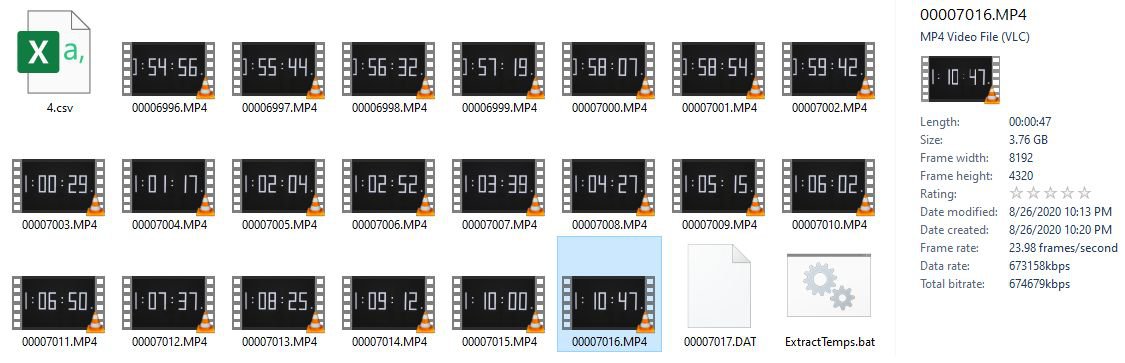

Electroholic Anonymous Posted August 26, 2020 Share Posted August 26, 2020 19:02:22,00006996.MP4,47.5475,28 19:03:10,00006997.MP4,47.5475,32 19:03:58,00006998.MP4,47.5475,34 19:04:45,00006999.MP4,47.5475,36 19:05:33,00007000.MP4,47.5475,37 19:06:20,00007001.MP4,47.5475,39 19:07:08,00007002.MP4,47.5475,40 19:07:55,00007003.MP4,47.5475,41 19:08:43,00007004.MP4,47.5475,42 19:09:30,00007005.MP4,47.5475,43 19:10:18,00007006.MP4,47.5475,44 19:11:05,00007007.MP4,47.5475,45 19:11:53,00007008.MP4,47.5475,46 19:12:41,00007009.MP4,47.5475,47 19:13:28,00007010.MP4,47.5475,48 19:14:16,00007011.MP4,47.5475,48 19:15:03,00007012.MP4,47.5475,49 19:15:51,00007013.MP4,47.5475,50 19:16:38,00007014.MP4,47.5475,50 19:17:26,00007015.MP4,47.5475,51 19:18:13,00007016.MP4,47.5475,52 19:20:28,00006996.MP4,47.5475,48 19:21:16,00006997.MP4,47.5475,51 19:22:03,00006998.MP4,47.5475,52 19:22:51,00006999.MP4,47.5475,52 19:23:38,00007000.MP4,47.5475,53 19:24:26,00007001.MP4,47.5475,53 19:25:13,00007002.MP4,47.5475,54 19:26:01,00007003.MP4,47.5475,54 19:26:48,00007004.MP4,47.5475,55 19:27:36,00007005.MP4,47.5475,55 19:28:23,00007006.MP4,47.5475,56 19:29:11,00007007.MP4,47.5475,56 19:29:59,00007008.MP4,47.5475,56 19:30:46,00007009.MP4,47.5475,57 19:31:34,00007010.MP4,47.5475,57 19:32:21,00007011.MP4,47.5475,57 19:33:09,00007012.MP4,47.5475,57 19:33:56,00007013.MP4,47.5475,58 19:34:44,00007014.MP4,47.5475,58 19:35:31,00007015.MP4,47.5475,58 19:36:19,00007016.MP4,47.5475,58 19:38:32,00006996.MP4,47.5475,55 19:39:20,00006997.MP4,47.5475,57 19:40:07,00006998.MP4,47.5475,58 19:40:55,00006999.MP4,47.5475,58 19:41:42,00007000.MP4,47.5475,58 19:42:30,00007001.MP4,47.5475,59 19:43:18,00007002.MP4,47.5475,59 19:44:05,00007003.MP4,47.5475,59 19:44:53,00007004.MP4,47.5475,59 19:45:40,00007005.MP4,47.5475,60 19:46:28,00007006.MP4,47.5475,60 19:47:15,00007007.MP4,47.5475,60 19:48:03,00007008.MP4,47.5475,60 19:48:50,00007009.MP4,47.5475,60 19:49:38,00007010.MP4,47.5475,60 19:50:25,00007011.MP4,47.5475,61 19:51:13,00007012.MP4,47.5475,61 19:52:01,00007013.MP4,47.5475,61 19:52:48,00007014.MP4,47.5475,61 19:53:36,00007015.MP4,47.5475,61 19:54:23,00007016.MP4,47.5475,61 19:55:11,00007017.MP4,47.5475,61 19:56:53,00006996.MP4,47.5475,58 19:57:41,00006997.MP4,47.5475,60 19:58:28,00006998.MP4,47.5475,60 19:59:16,00006999.MP4,47.5475,60 20:00:03,00007000.MP4,47.5475,61 20:00:51,00007001.MP4,47.5475,61 20:01:39,00007002.MP4,47.5475,61 20:02:26,00007003.MP4,47.5475,61 20:03:14,00007004.MP4,47.5475,61 20:04:01,00007005.MP4,47.5475,61 20:04:49,00007006.MP4,47.5475,62 20:05:36,00007007.MP4,47.5475,62 20:06:24,00007008.MP4,47.5475,62 20:07:11,00007009.MP4,47.5475,62 20:07:59,00007010.MP4,47.5475,62 20:08:46,00007011.MP4,47.5475,62 20:09:34,00007012.MP4,47.5475,62 20:10:22,00007013.MP4,47.5475,62 20:11:09,00007014.MP4,47.5475,62 20:11:57,00007015.MP4,47.5475,62 20:12:44,00007016.MP4,47.5475,62 20:14:50,00006996.MP4,47.5475,58 20:15:38,00006997.MP4,47.5475,60 20:16:26,00006998.MP4,47.5475,61 20:17:13,00006999.MP4,47.5475,61 20:18:01,00007000.MP4,47.5475,61 20:18:48,00007001.MP4,47.5475,61 20:19:36,00007002.MP4,47.5475,61 20:20:23,00007003.MP4,47.5475,62 20:21:11,00007004.MP4,47.5475,62 20:21:58,00007005.MP4,47.5475,62 20:22:46,00007006.MP4,47.5475,62 20:23:34,00007007.MP4,47.5475,62 20:26:21,00006996.MP4,47.5475,57 20:27:09,00006997.MP4,47.5475,59 20:27:56,00006998.MP4,47.5475,60 20:28:44,00006999.MP4,47.5475,60 20:29:31,00007000.MP4,47.5475,61 20:30:19,00007001.MP4,47.5475,61 20:31:06,00007002.MP4,47.5475,61 20:31:54,00007003.MP4,47.5475,61 20:32:41,00007004.MP4,47.5475,61 20:33:29,00007005.MP4,47.5475,61 20:34:16,00007006.MP4,47.5475,61 20:35:04,00007007.MP4,47.5475,62 20:35:52,00007008.MP4,47.5475,62 20:36:39,00007009.MP4,47.5475,62 20:37:27,00007010.MP4,47.5475,62 20:38:14,00007011.MP4,47.5475,62 20:39:02,00007012.MP4,47.5475,62 20:39:49,00007013.MP4,47.5475,62 20:40:37,00007014.MP4,47.5475,62 20:41:24,00007015.MP4,47.5475,62 20:42:12,00007016.MP4,47.5475,62 20:42:59,00007017.MP4,47.5475,62 20:43:47,00007018.MP4,47.5475,62 20:44:35,00007019.MP4,47.5475,62 20:45:22,00007020.MP4,47.5475,62 20:46:10,00007021.MP4,6.423083333,62 That is the CSV data, so have at it 😉 horshack, mechanicalEYE, Katrikura and 1 other 4 Link to comment Share on other sites More sharing options...
Electroholic Anonymous Posted August 26, 2020 Share Posted August 26, 2020 In case people would start doubting whether this is all just made up. Here is a screenshot of the MP4 file thumbnails of the 4th run. mechanicalEYE 1 Link to comment Share on other sites More sharing options...

horshack Posted August 26, 2020 Share Posted August 26, 2020 9 minutes ago, Electroholic Anonymous said: I will try to upload the whole boring a7R4 video of this 100+ minute 8K IPB test now after a quick and dirty render. And about the FW update, I consider it riskier to update my FW then to run the R5 like this. Will they close this loophole, will they cripple my much loved superb Canon EF glass that has never ever worked better on any native body I owned, all to give RF an edge, in exchange for 20% more overheating time? No thanks! Thanks for the .CSV data. Here's your data plotted. The running elapsed time was calculated from the EXIF timestamps: Electroholic Anonymous 1 Link to comment Share on other sites More sharing options...
