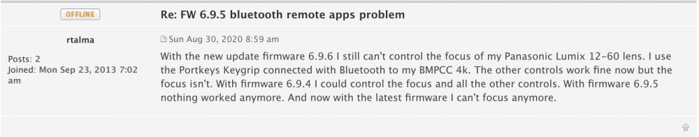

Anaconda_ Posted September 1, 2020 Share Posted September 1, 2020 More Bluetooth issues with BMD updates. I imagine this will also impact the AFX Focus Module? BTM_Pix 1 Link to comment Share on other sites More sharing options...
Emanuel Posted September 1, 2020 Share Posted September 1, 2020 I bet so too but, I've just received from CDA TEK support on the now released v6.9.6 update a few days ago, so I guess we're pretty safe with our Irish supplier :- ) majoraxis and BTM_Pix 2 Link to comment Share on other sites More sharing options...
Super Members BTM_Pix Posted September 1, 2020 Author Super Members Share Posted September 1, 2020 3 hours ago, Anaconda_ said: More Bluetooth issues with BMD updates. I imagine this will also impact the AFX Focus Module? Thanks for the heads up. I'm guessing it must something specific to Portkeys because I've just tested that lens (presuming it's the Panaleica one) with the PBC in combination with both the Nucleus Nano and the AFX and focus control is fine with v6.9.6 It wasn't working when I first put the lens on to test it but in my defence have you seen how small the AF/MF switch is on that lens and how difficult it is to see its in the MF position when you haven't had a coffee 🙂 Link to comment Share on other sites More sharing options...
