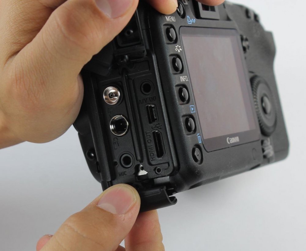

visionrouge Posted August 12, 2020 Share Posted August 12, 2020 You may want to check, but there is a button cell to keep the camera time https://www.ifixit.com/Guide/Canon+EOS+5D+Mark+II+Clock+Battery+Replacement/31531 Look more for something like this to reset time. If this reset the recovery time or recording time, it's the 100% proof that there is no valid temperature reading, but time based only This is for 5D, but I guess 5R have something similar Link to comment Share on other sites More sharing options...
