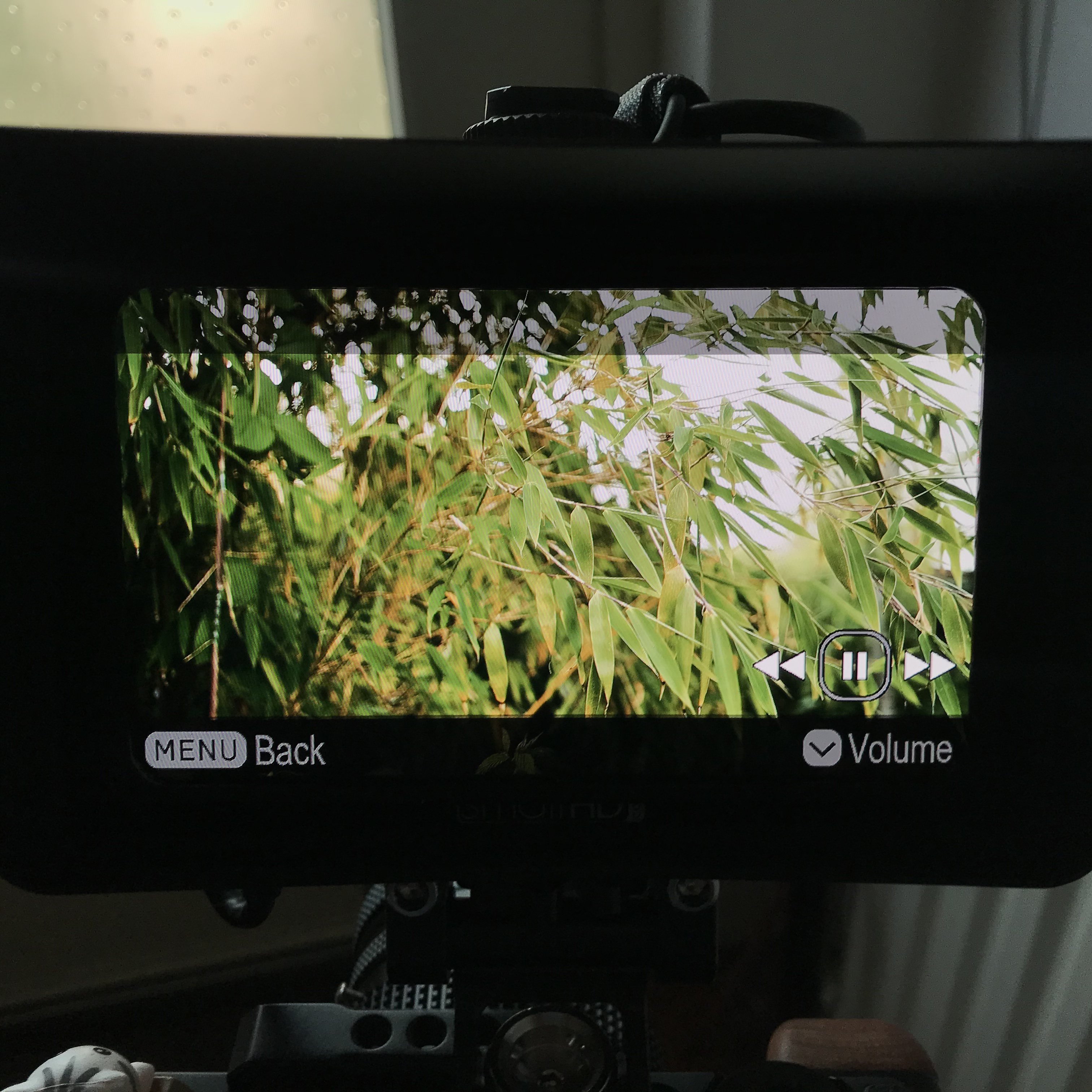

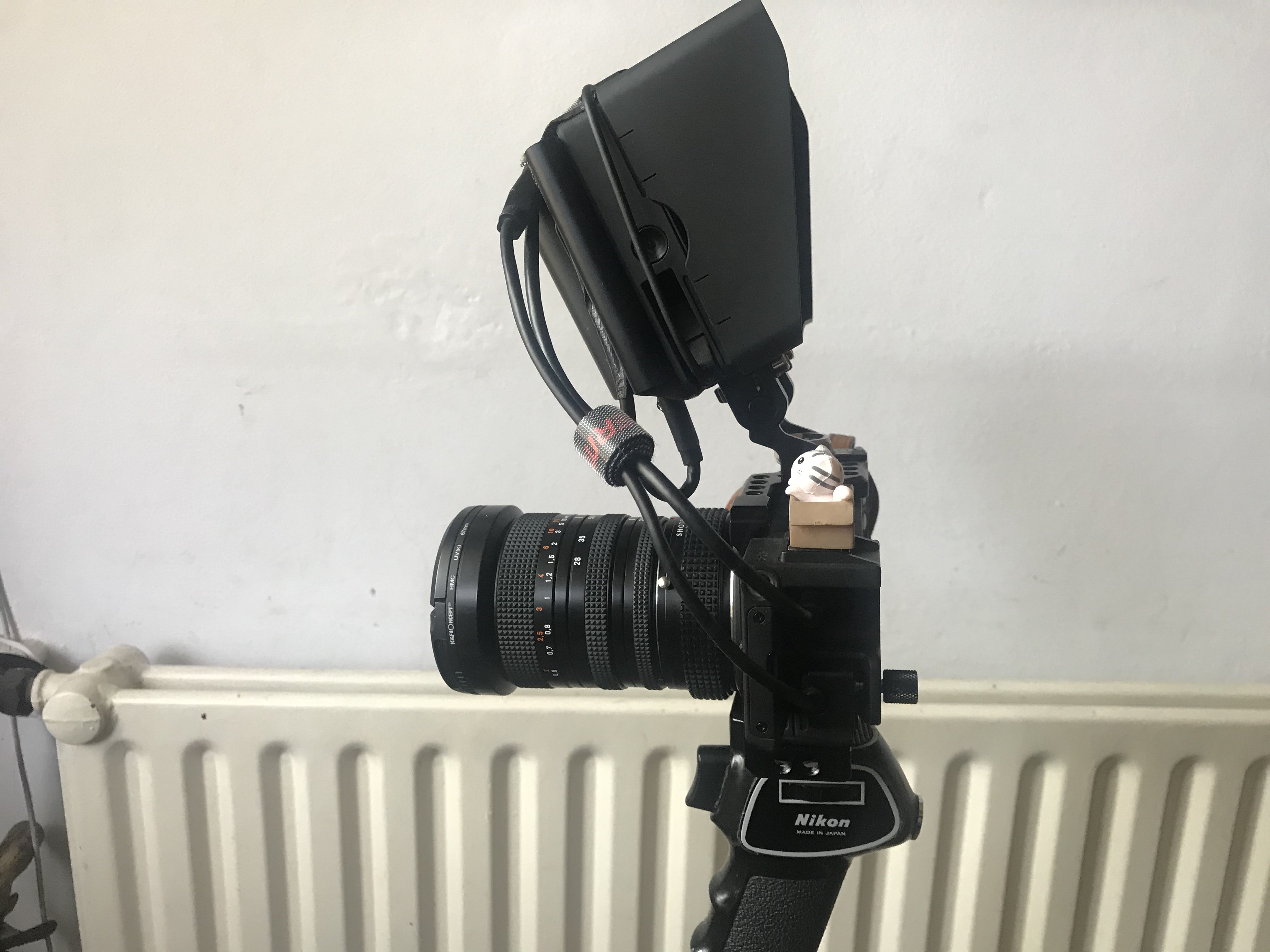

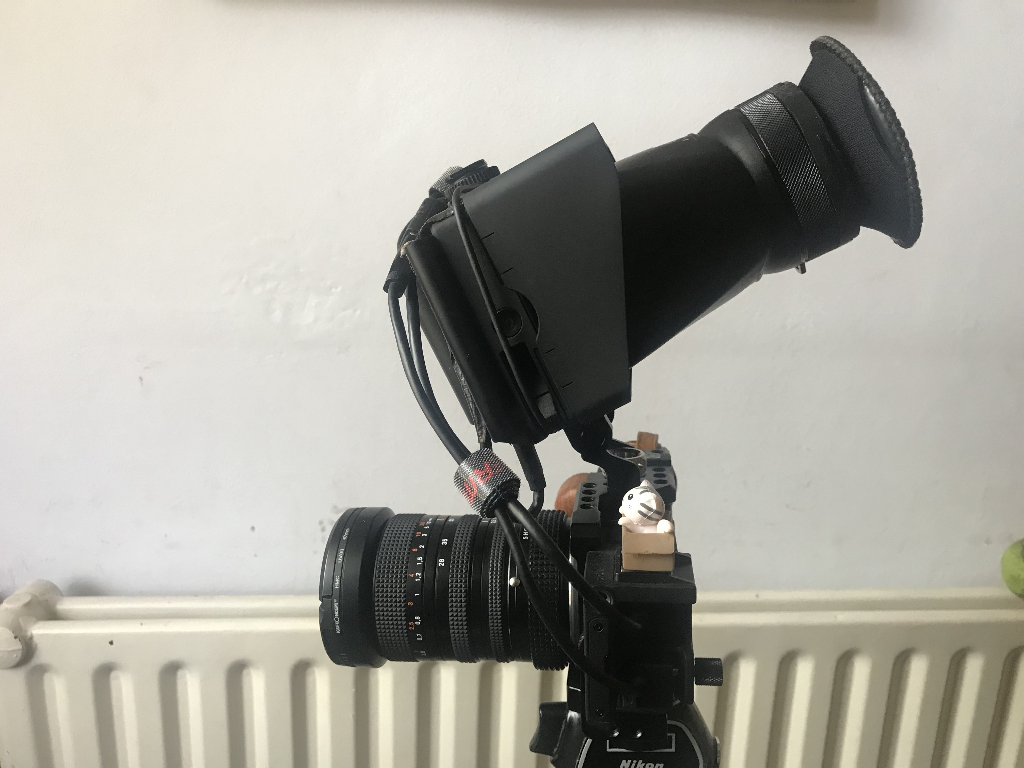

Lars Steenhoff Posted June 26, 2020 Share Posted June 26, 2020 47 minutes ago, Andrew Reid said: I may get the viewfinder loupe for it. And gorilla pod for handheld work. You can argue it would look less weird than IBIS if used nicely this way. https://kinotehnik.com/product/lcdvf-bm5-optical-viewfinder/ I use the Kinotehnik optical viewfinder on the smallhd focus oled, its not supposed to work but I made it work. So now I have a 1080p OLED evf It is suported to work on the blackmagic 5" 12g imagesfromobjects and heart0less 2 Link to comment Share on other sites More sharing options...
