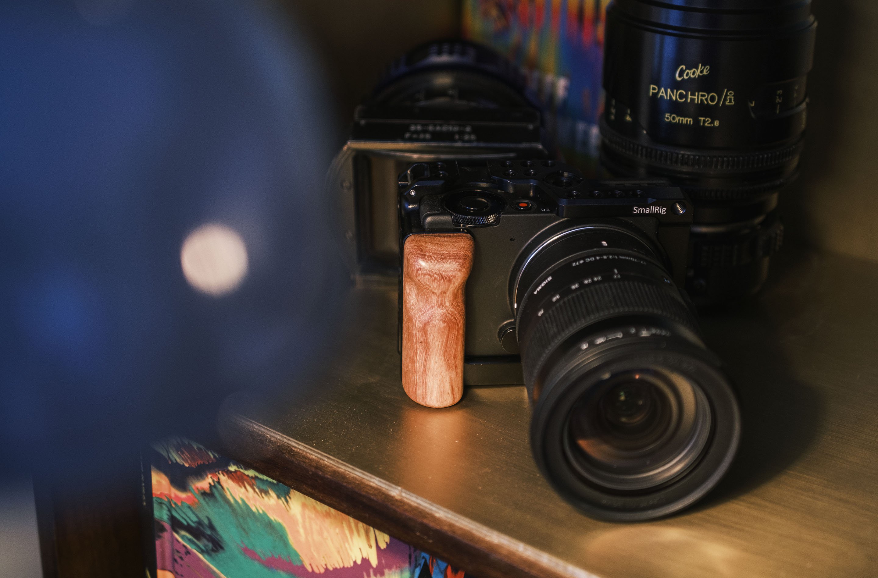

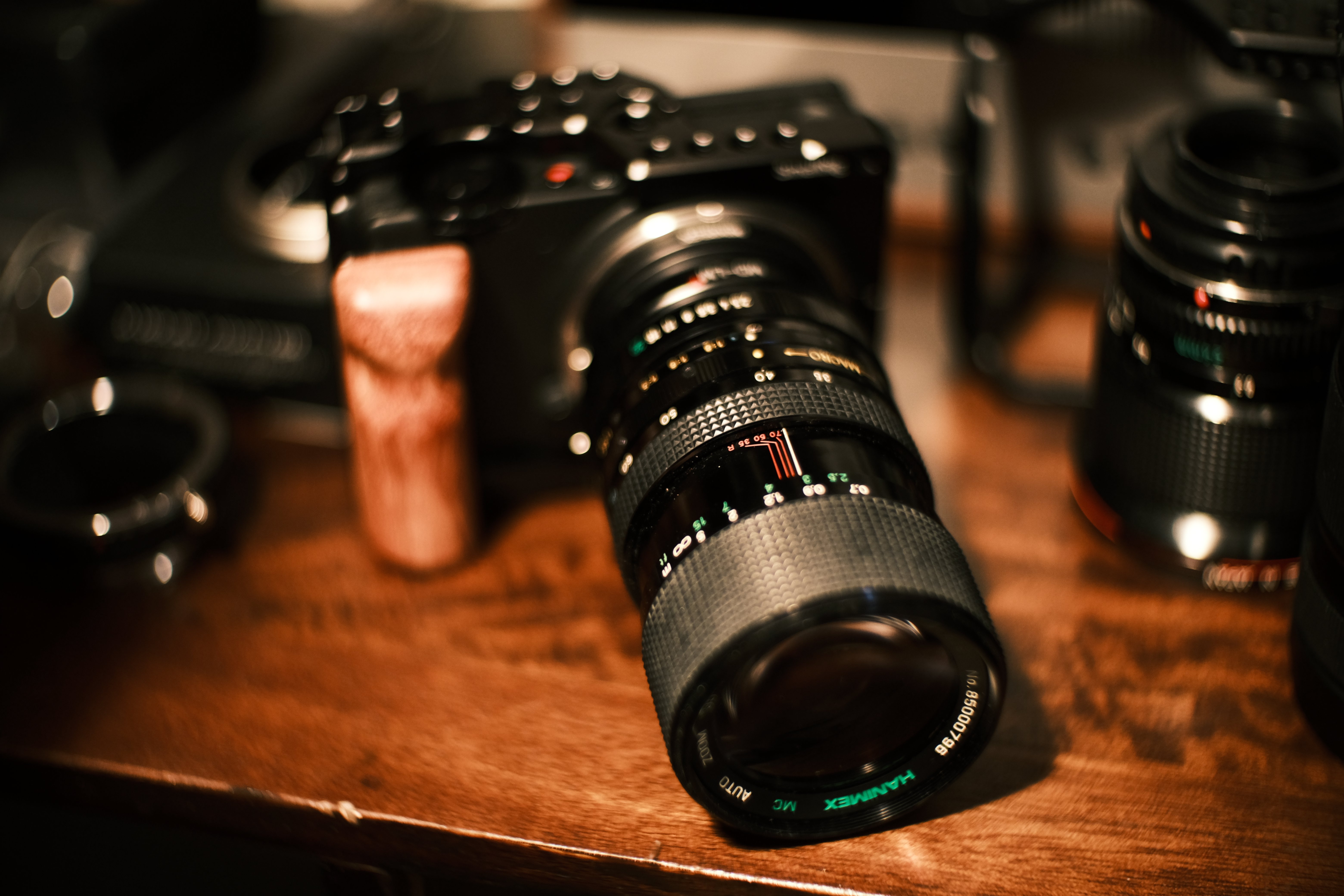

Administrators Andrew - EOSHD Posted May 22, 2020 Author Administrators Share Posted May 22, 2020 Fuji's own 18-55mm F2.8-4 is a great lens for the money but the Sigma is even better and more versatile in my book. A nice bit longer at the telephoto end. A bit wider too. Much better macro. More versatile. Fits more cameras. Goes on a Micro Four Thirds Speed Booster as well, where it just about has 1.3x crop covered. I would keep it on the X-T4 though and not the older Fuji cameras as the AF seems FAR better on X-T4 vs my X-Pro 2. On the older ones I'd use Fuji's own lenses. Also you need the Fringer adapter. The cheaper ones don't do it for me. So far anyway. Firmware may change things later. Speaking of zooms... The Sigma Fp got married today To a Russian She is 37-140 dress size. F=fit. Ex husband is Tarkovsky. And she loves the Fp because IBIS is useless with manual focus zoom lenses. So here it will be a case of the lost art of sticking it on a tripod like Tarkovsky. currensheldon and PannySVHS 2 Link to comment Share on other sites More sharing options...

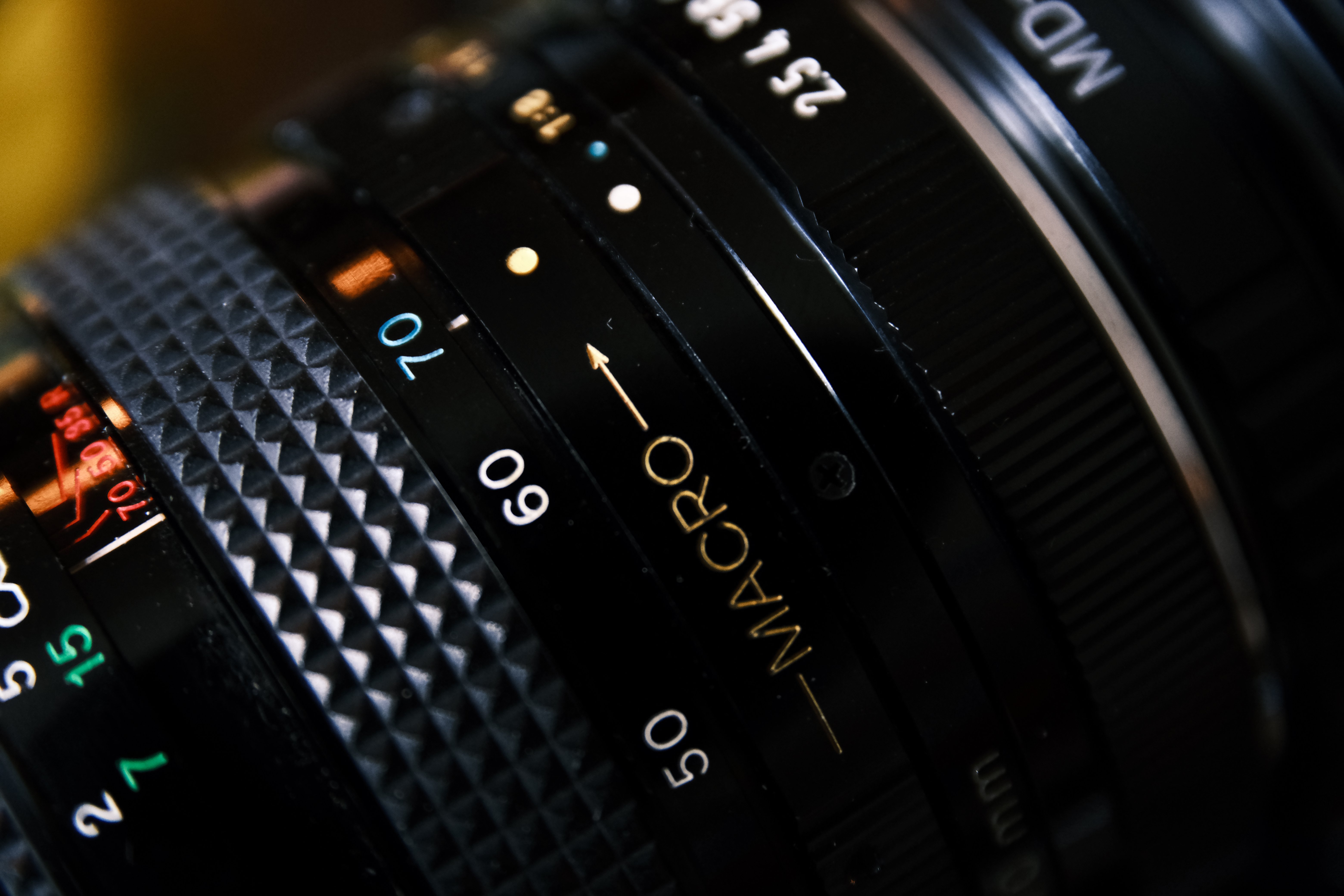

PannySVHS Posted May 22, 2020 Share Posted May 22, 2020 Wow. Awesome stuff. Tasty treats! How is the Soligor/Hanimex treating you? @Andrew Reid I find it nice at f4. 2.5 is obviously glowy. Surely tames the resolution of the S1:) But at f4 already I find it a great lens for filming. F4 is plenty to work for keeping the subject in focus. The 37 140, now we need to see that one capturing some sights! Link to comment Share on other sites More sharing options...

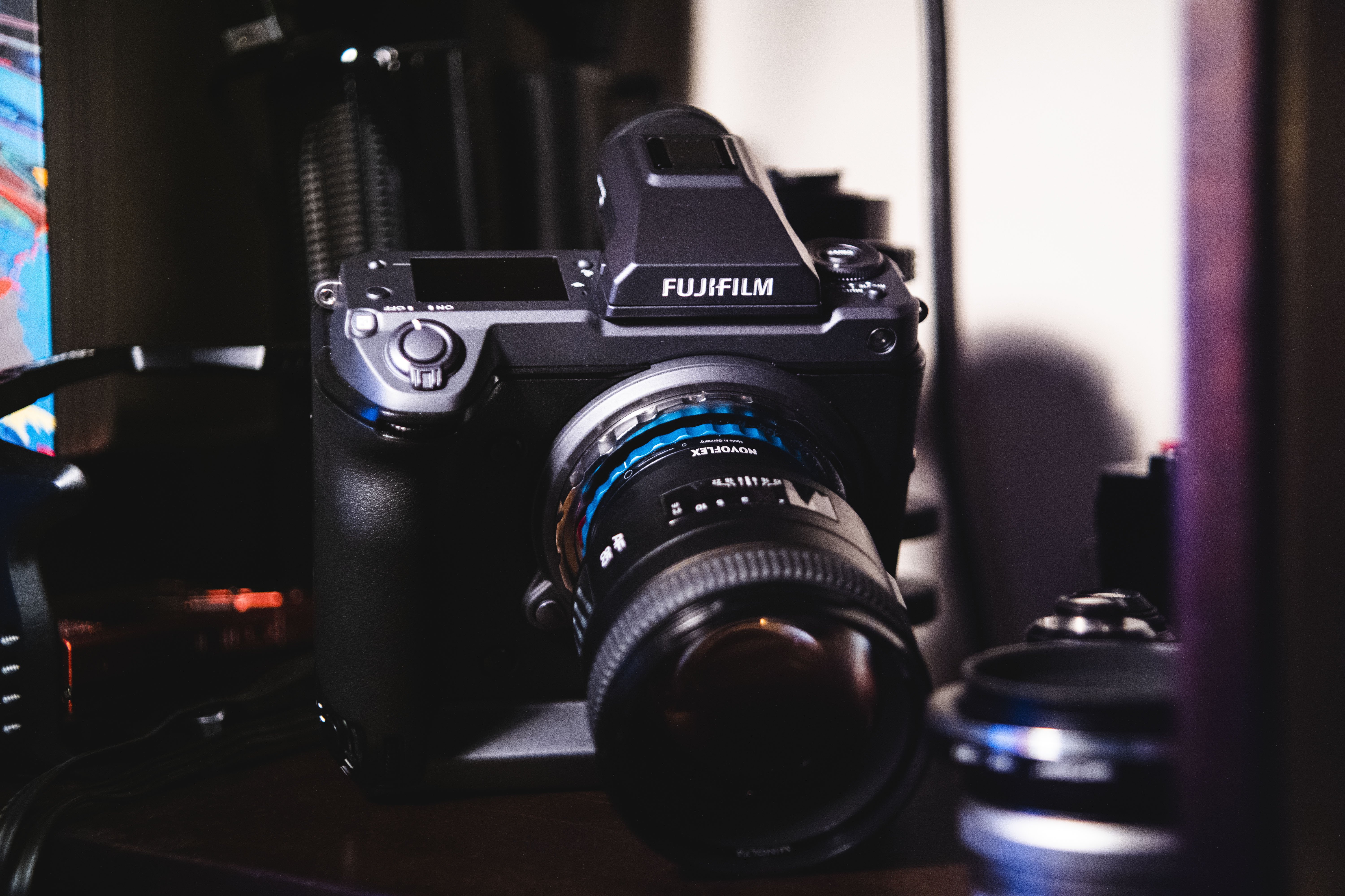

Administrators Andrew - EOSHD Posted May 22, 2020 Author Administrators Share Posted May 22, 2020 It arrived today and sits proudly on the Sigma Fp. An absolute gem. It seems parfocal to me as well! The shots of the GFX 100 are at 35mm and 70mm, both wide open. It's not exactly lacking for sharpness but is more gentle than a modern cut your throat sharp lens. PannySVHS 1 Link to comment Share on other sites More sharing options...
