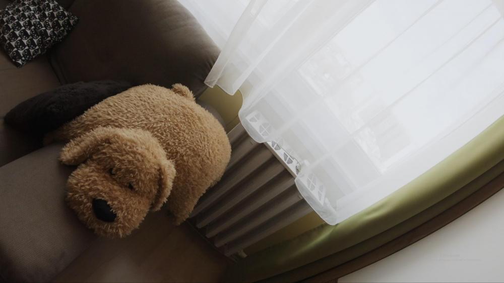

You can achieve very nice roll-off even with a GoPro Hero 7 with proper grading: (in this case: 10 stops DR from the camera in 14+ stops environment)
5 hours ago, Deadcode said:
Why does DR matter so much? we are far beyond the level of necessary DR for content creation.
Most of you guys want 15-16-17+ stops DR because you want "Arri like" highlight roll-off.
Not quite.
For storytelling purposes, you'd want the highlights to hold as much detail as possible while rolling off smoothly into clipped white.
In your shot the roll-off is indeed nice, well done. But with a higher DR camera, you'd be able to see what's outside the window, so there'd be some context for this scene.

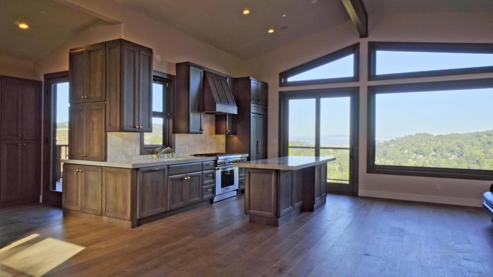

In my particular case (being the OP of this thread), it is because I am trying my hardest to both capture the interior and exterior views of a house in real estate videos.
People want to be able to see the views out the window without them being blown out, and they want to see the interior without it being too dark.
Using Slog 2 (mostly) on my a6500
On this particular day it was fairly overcast, which helped to control the exterior view, but if it wasn't so overcast then it would have been difficult to retain ANY view.

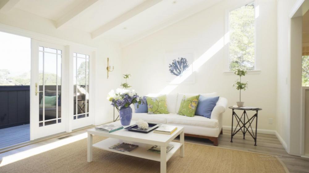

Want the ultimate DR shot? Use a slider and expose for the interior then repeat the shot with the same exact movement (this is where the slider comes in) and expose for the exterior. Combined the shots in post production, although it might appear to be "hyper" realistic to the point of looking fake because the highlight roll off in the interior won't match the exposure of the exterior and your brain will pull a massive hmmmmm.
Yeah, that is what one of my "competitors" does. The problem is that it takes a lot of time (on location) and most realtors aren't willing to pay a couple thousand dollars for a two-minute video. At least, I don't have any of those realtors as clients.
https://youtu.be/h5zOW0t-Tms?t=101

On 3/11/2019 at 8:03 AM, Deadcode said:
Can you please share some original files from the most problematic shots?
Here are some difficult shots.
The first one c0015.mp4 is kind of typical of most situations.
The other two files ( c0047 and c0048 are more extreme, the first having completely blown out window with the second retaining the view but having way to underexposed interior).

This is a hard one.
If you overexpose those highlights, it's gone. Try to grade for the interior in this case
If you expose properly, then you can do the HDR style grade.
On you linked samples the guys probably shoot RAW photos in multiexposure using sliders, then stiched them together.
