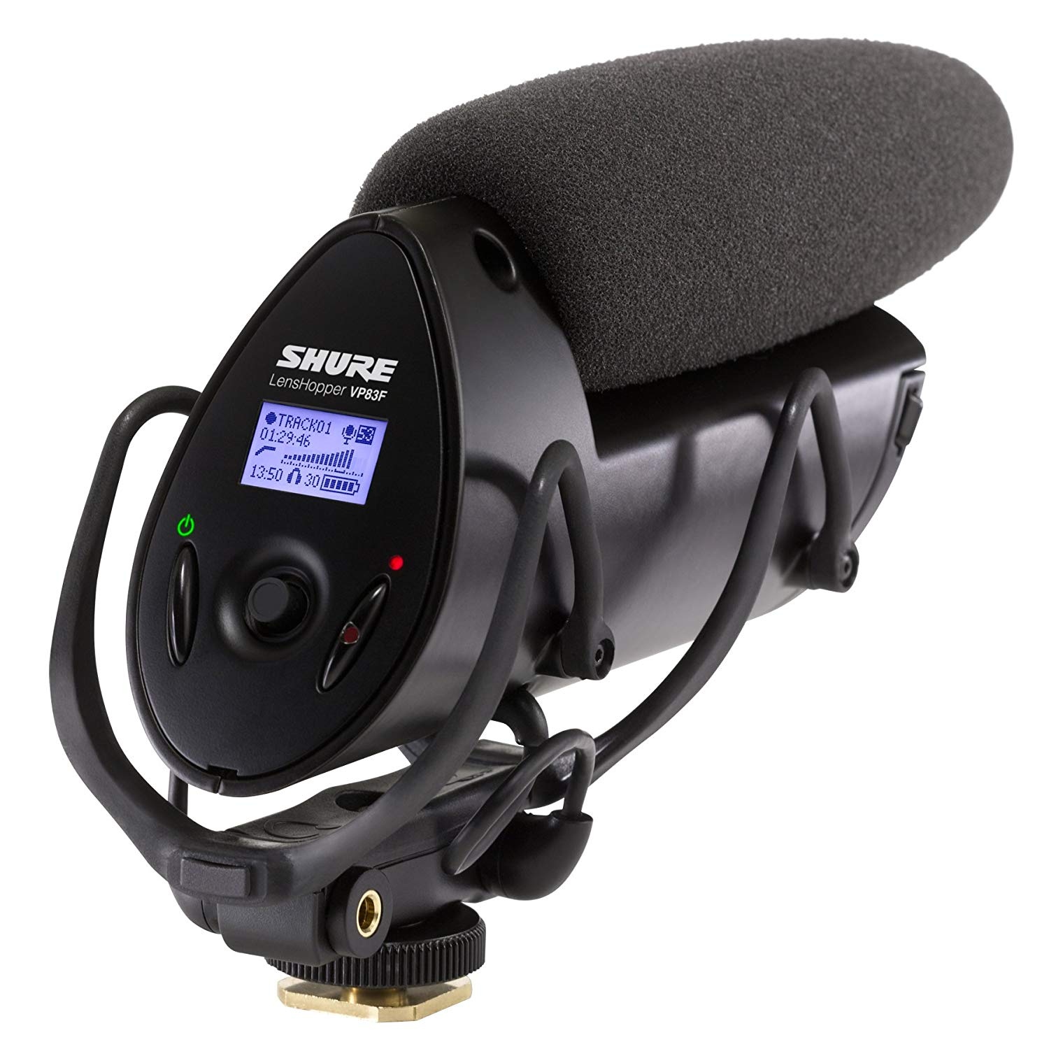

webrunner5 2,464 Posted December 9, 2018 Share Posted December 9, 2018 https://www.bhphotovideo.com/c/product/966010-REG/shure_vp83f_condenser_shotgun_mic.html Quote Link to post Share on other sites

IronFilm 4,203 Posted December 11, 2018 Share Posted December 11, 2018 6 hours ago, Dan Wake said: 2) His camera doesn’t have a hot shoe mount and mic input L bracket + Shure VP83F LensHopper (or Tascam DR10SG, or Zoom F1 with SGH-6) https://www.ebay.com/itm/L-Shape-Bracket-Holder-For-Flash-light-Camera-mini-DV-Camcorder-With-Hot-Shoe/222220823578 https://www.bhphotovideo.com/c/product/966010-REG/shure_vp83f_condenser_shotgun_mic.html 7 hours ago, Dan Wake said: 3) This is his first mic and he have no experience with audio studio. 4) He don’t want to use lavaliers because he needs to speak with a lot of people on the go, and he don’t want a dynamic microphone because he do not wants the mic to be seen in the frame of the picture. I don't except my suggestion to produce great audio results for him, because of his constraints. But it is the best suggestion in this thread so far. 6 hours ago, hansel said: But than again a shotgun mic is better than no mic at all This. But also just because something is better than something else which is much worse, doesn't mean that approach is a good idea either.... 5 hours ago, Mmmbeats said: There really isn't a solution for this. Camera mounted mic won't work for interviews. It just won't. Boom Buddy won't work if you are hopping around a location hoping to interview people on the fly. You're ruling out lavaliers, but I think they're the only real option in this case. Radio-mic to a recorder setup alongside or underneath the camera. Will take a minute or two to set up the mic, with a bit of practise. This type of work really requires two people. Yeah, some scenarios can be with luck pulled off with just one person, other times you really need a dedicated soundie. And run and gun interviews on the move with no set up time really really does need a dedicated soundie, or put up with very sub par sound (or change how you do it, just giving a few minutes more times for instance, or changing up how your shots are done). There are also other times when even one soundie is not a good idea, and you should have a sound team of two (or even three or four people). For instance I did a low budget web series on the weekend which had a boom and seven wireless lavs (multicam shooting too, with up to three cameras frequently). I really should have had a boom op for this, rather than doing the whole sound department myself (but he had to cancel on me the night before when some work popped up. Thus I did sound solo, made for a stressful risky day). Quote Link to post Share on other sites
