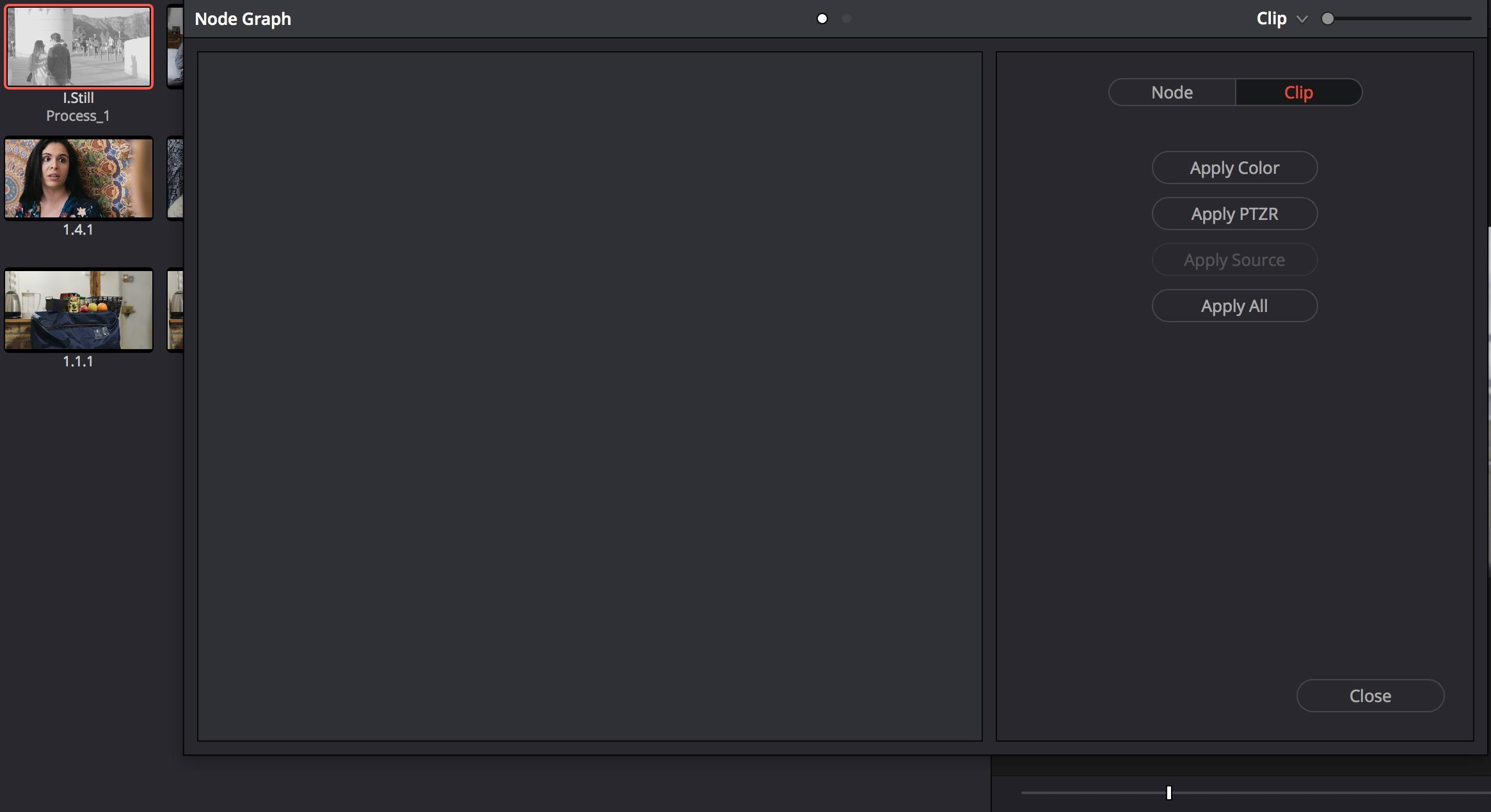

BrunoCH Posted February 21, 2019 Share Posted February 21, 2019 7 hours ago, DanielVranic said: This is the powergrade. I will be making a video on this soon Process_1.24.1.dpx This dpx is empty ?!?! Link to comment Share on other sites More sharing options...

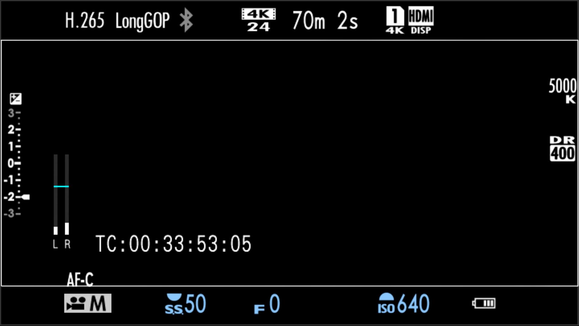

andrew_dotdot Posted February 21, 2019 Share Posted February 21, 2019 3 hours ago, androidlad said: Great! I’ve sent many feature requests and bug reports, using many names and email addresses ? But it’s better to contact your Fuji regional websites, Tokyo headquarter seems to only respond to messages written in Japanese. I wrote in English to the Japan office last week with a request and they answered me with a specific reply (they did actually read my email) within a few days. So it isn't hopeless. I asked if they could implement a setting for max ISO in video mode, or at least show the ISO being used, instead of just "ISO AUTO". Lars Steenhoff and IronFilm 2 Link to comment Share on other sites More sharing options...
DanielVranic Posted February 21, 2019 Share Posted February 21, 2019 1 hour ago, BrunoCH said: This dpx is empty ?!?! I will look into this as soon as I get home. Thanks! Link to comment Share on other sites More sharing options...

DanielVranic Posted February 26, 2019 Share Posted February 26, 2019 On 2/21/2019 at 3:44 PM, BrunoCH said: This dpx is empty ?!?! Hey, I just re-exported it and when reimported into another project I had no issues. Link to comment Share on other sites More sharing options...
BrunoCH Posted February 26, 2019 Share Posted February 26, 2019 8 hours ago, DanielVranic said: Hey, I just re-exported it and when reimported into another project I had no issues. I tried again. I don't understand. Look at the screenshot of the node display. Link to comment Share on other sites More sharing options...
