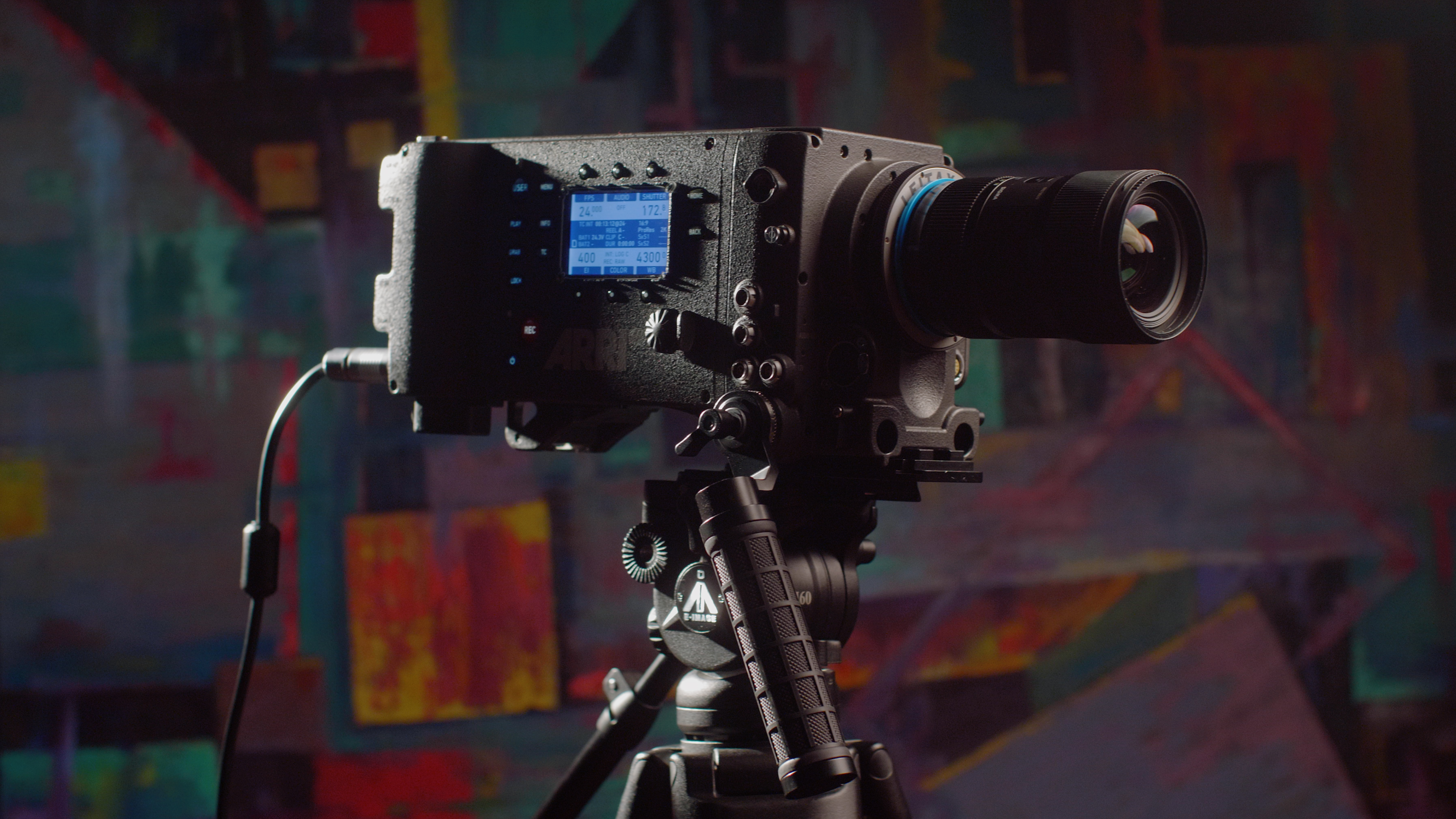

Sage Posted January 30, 2018 Author Share Posted January 30, 2018 Geoff CB, Adept and AaronChicago 3 Link to comment Share on other sites More sharing options...
IronFilm Posted January 30, 2018 Share Posted January 30, 2018 Oh hey an Arri Alexa Classic using a Nikon lens! :-D Don't see too many photos of that. Link to comment Share on other sites More sharing options...
Sage Posted January 30, 2018 Author Share Posted January 30, 2018 And no monitor ; ) Link to comment Share on other sites More sharing options...
IronFilm Posted January 31, 2018 Share Posted January 31, 2018 True. I only see a power cable connected to it. Nothing hiding over on the operator side?! How come? Link to comment Share on other sites More sharing options...
Sage Posted January 31, 2018 Author Share Posted January 31, 2018 Odds and ends are still arriving, it should be minimally operational by tomorrow (with the card reader) Link to comment Share on other sites More sharing options...
IronFilm Posted February 1, 2018 Share Posted February 1, 2018 Oh nice! So you purchased it? I think you're one of the few on this forum (the only one?!) then who personally owns an Arri Alexa Classic. May I ask what price you got it for? (& what work have you got planned for it) Link to comment Share on other sites More sharing options...
Sage Posted February 1, 2018 Author Share Posted February 1, 2018 Its probably the cheapest working Alexa ever sold, at $7800 for the body only (best offer). With shipping and minimal accessories, there was another 1.5k added on. The seller neglected to mention (or didn't know?) that it had a history of salt water damage (I called Arri about the serial number). What this amounted to is that the SD card slot wasn't working when I received it. I got creative and cleaned the contacts in there, and it worked (the electronics in the cam are water-sealed after all). The upside of this is that it is a very recent model, with only 536 hours on the body. I intend to make a reference quality color conversion for a variety of cameras, with side by sides to document the conversion. And then, I'll probably use it for close ups and 120fps slow motion for a narrative thereafter IronFilm, Geoff CB and graphicnatured 3 Link to comment Share on other sites More sharing options...
