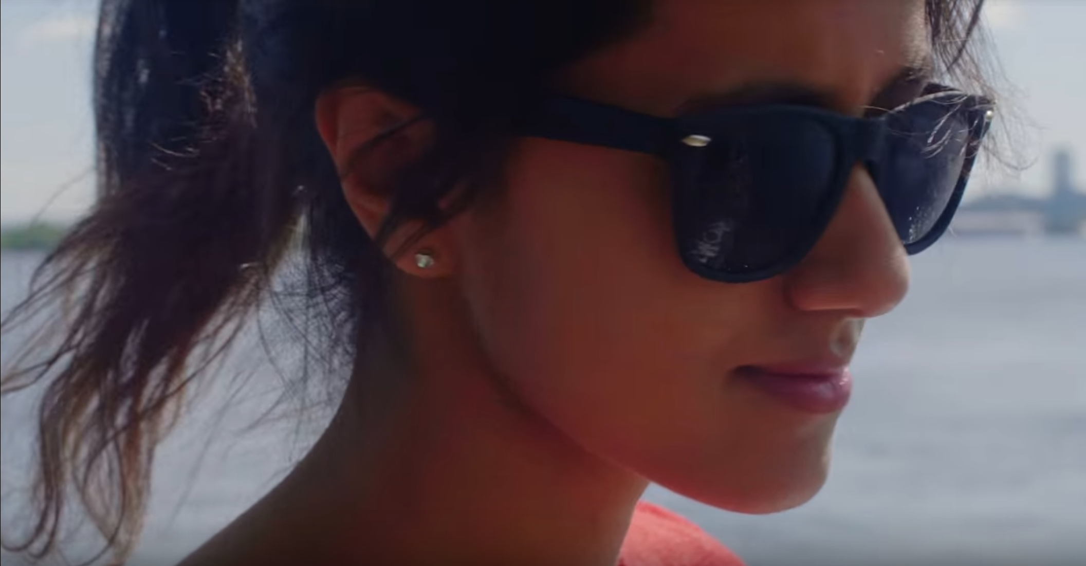

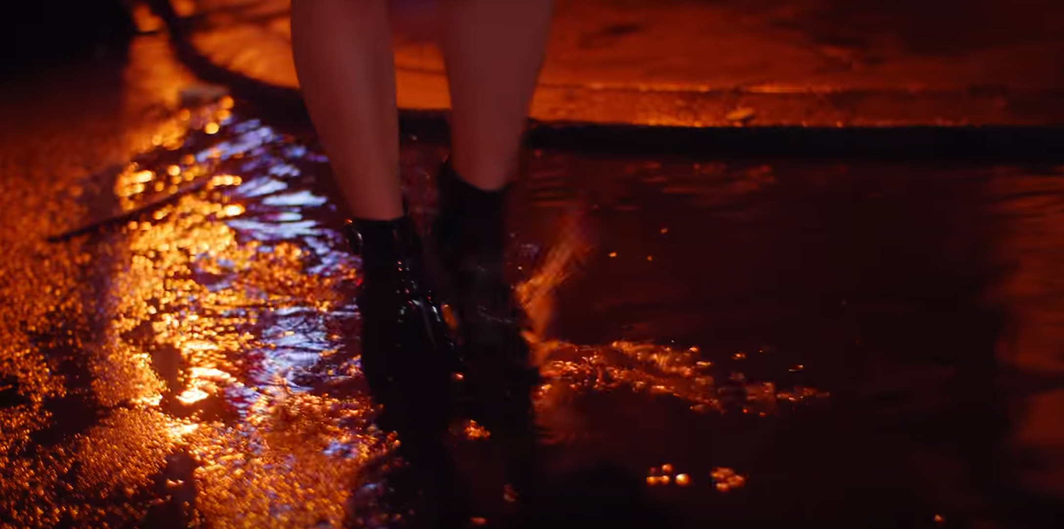

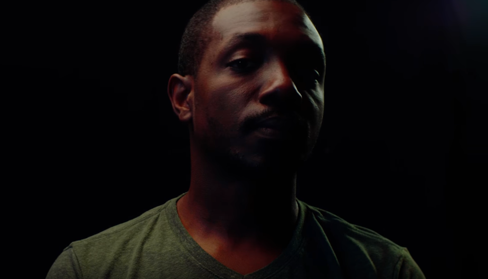

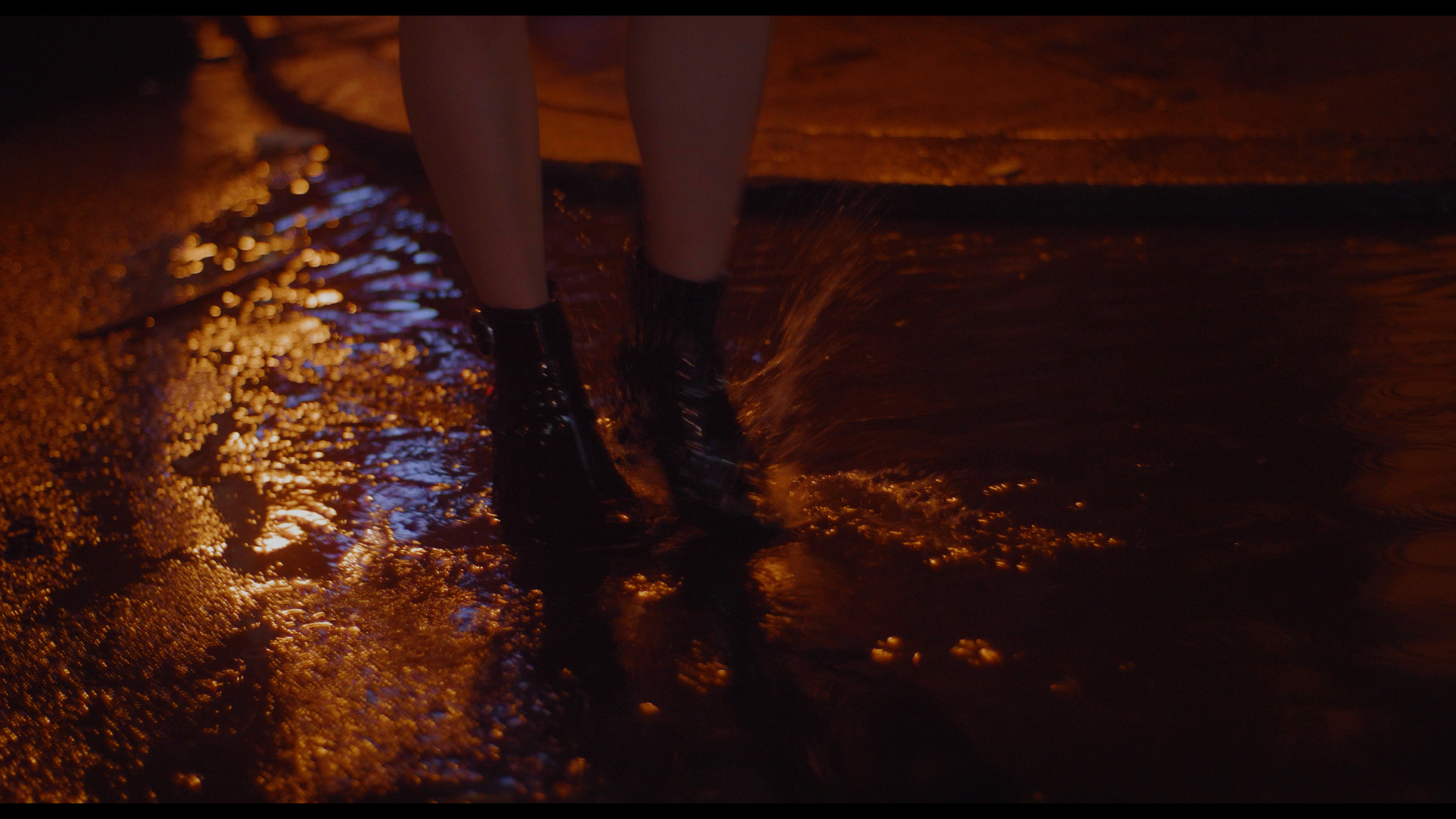

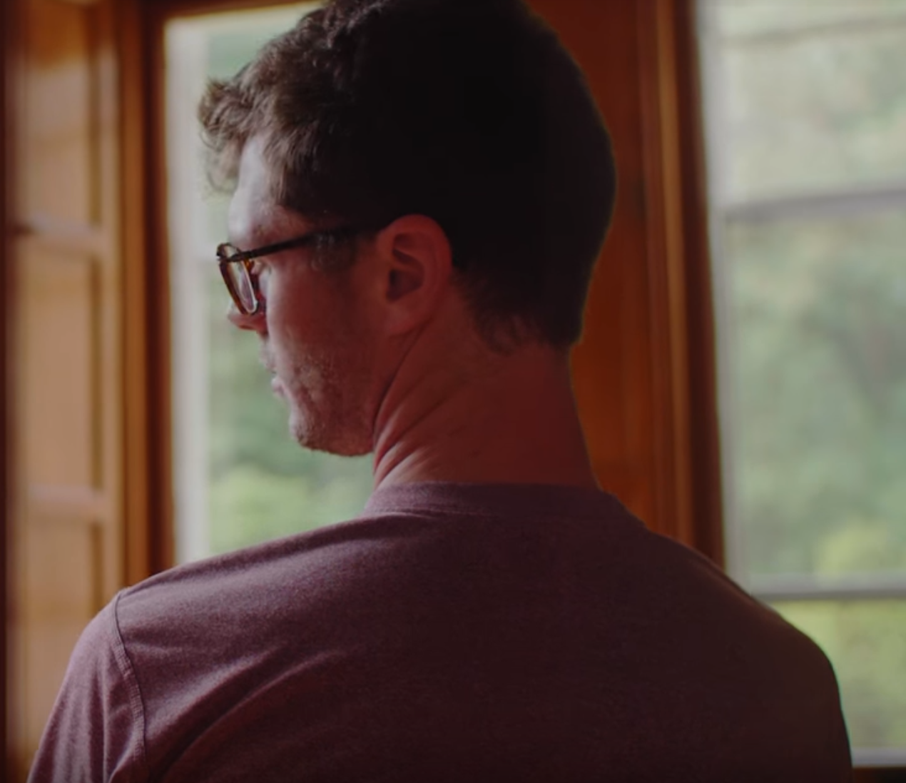

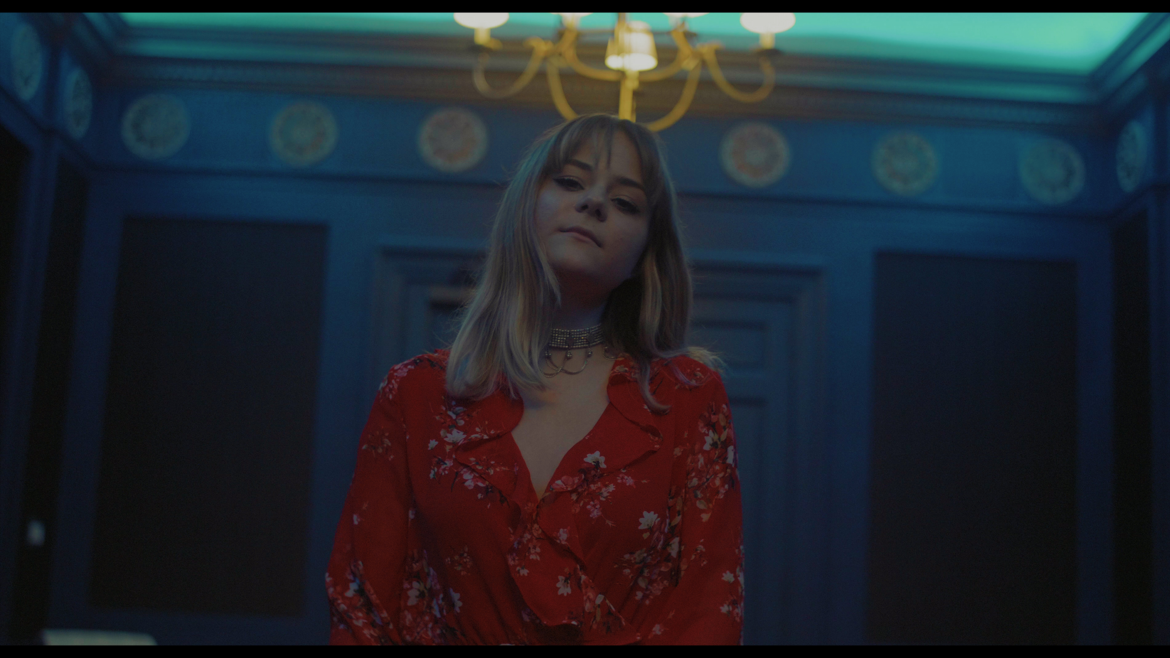

31 minutes ago, Sage said:
Here are the core conversions, without my punchy grade. I tend to grade red, and I think in a couple of these shots the red shirts cast a glow on their faces:
Did you shoot this examples using 8 bit codec? A see many blocking and color artefacts.
Any 10 bit examples?
But colors and contrast are amazing.
