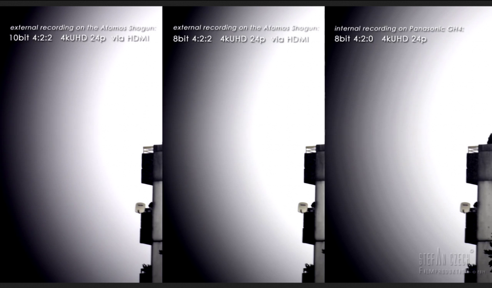

jonpais Posted January 23, 2018 Share Posted January 23, 2018 But isn’t that example demonstrating the relationship between banding and bit depth, not bit rate? Quote Link to comment Share on other sites More sharing options...
markr041 Posted January 23, 2018 Share Posted January 23, 2018 2 hours ago, jonpais said: But isn’t that example demonstrating the relationship between banding and bit depth, not bit rate? It seems to me that most of the banding disappears when the lightly-compressed, high bitrate codec at 8bit (probably ProRes 422 - that is what the Shogun uses) is used compared to the highly-compressed low bitrate internal codec (middle panel compared to the first - both 8bit). There is a gain from going to 10bit from 8bit, using the exact same compression (bitrate), but it is relatively minor. The poster should have indicated the bitrates, not just the bit depth. Emanuel 1 Quote Link to comment Share on other sites More sharing options...

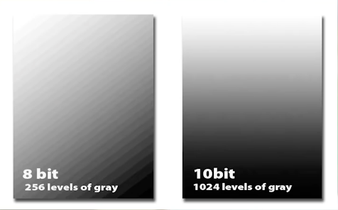

jonpais Posted January 23, 2018 Share Posted January 23, 2018 1 hour ago, markr041 said: It seems to me that most of the banding disappears when the lightly-compressed, high bitrate codec at 8bit (probably ProRes 422 - that is what the Shogun uses) is used compared to the highly-compressed low bitrate internal codec (middle panel compared to the first - both 8bit). There is a gain from going to 10bit from 8bit, using the exact same compression (bitrate), but it is relatively minor. The poster should have indicated the bitrates, not just the bit depth. The way I understood it is that bit depth, or the number of 'shades' there are for each color channel, is what determines whether we see banding in an image. In 8 bit, there are 256 levels, in 10 bit, 1024 levels, which is why, when we push the image around in post, often (if not always!), the 10 bit image should hold up better. source Quote Link to comment Share on other sites More sharing options...
markr041 Posted January 23, 2018 Share Posted January 23, 2018 10 minutes ago, jonpais said: The way I understood it is that bit depth, or the number of 'shades' there are for each color channel, is what determines whether we see banding in an image. In 8 bit, there are 256 levels, in 10 bit, 1024 levels, which is why, when we push the image around in post, often (if not always!), the 10 bit image should hold up better. source You are right ceteris paribus, but the bit depth statement and the visual comparison ignores the role of bitrate (that is, you have compared different bit depths for highly compressed clips (I assume)). The test posted above shows us that bitrate matters also, and that it matters more. Remove the high compression, and the difference by bit depth shrinks almost to invisibility. So you are correct, it is just that it turns out something is even more important than bit depth (they interact). That is, when you use 8 bits but do not highly compress you get much less banding. I have heard this before; I am not claiming the bitrate effect is correct other than interpreting what the poster showed (and I do not see anything wrong with his test). Emanuel, EthanAlexander and kidzrevil 3 Quote Link to comment Share on other sites More sharing options...

kidzrevil Posted March 6, 2018 Share Posted March 6, 2018 On 1/23/2018 at 1:04 PM, jonpais said: The way I understood it is that bit depth, or the number of 'shades' there are for each color channel, is what determines whether we see banding in an image. In 8 bit, there are 256 levels, in 10 bit, 1024 levels, which is why, when we push the image around in post, often (if not always!), the 10 bit image should hold up better. source you are right. It is bit depth not bitrate that causes the banding. The other poster is wrong on this one Quote Link to comment Share on other sites More sharing options...
Renaud Posted March 6, 2018 Share Posted March 6, 2018 11 hours ago, Robert Collins said: Have you tried setting 'af tracking sensitivity' - menu 2 - 2 - to responsive. By default it is set to standard. Yes I have this setting since the beginning but it’s still slower than my a6500.. Quote Link to comment Share on other sites More sharing options...
Emanuel Posted March 7, 2018 Share Posted March 7, 2018 20 hours ago, kidzrevil said: you are right. It is bit depth not bitrate that causes the banding. The other poster is wrong on this one Let's give 2nd look on that test a chance... People generally have that idea. Banding depends on the bit depth. That test leads to a bit different path though. Actually, it is even beyond color sampling, also bit rate. That is, not only bit depth. Practice redefines theory much often to keep going to ignore the evidence : ) Mark's @markr041 posts hinted it all :-) kidzrevil 1 Quote Link to comment Share on other sites More sharing options...
kidzrevil Posted March 7, 2018 Share Posted March 7, 2018 @Emanuel I may have misread @markr041 post. Although it is bitdepth or lack thereof that generally causes banding I guess in this case the image in question is so compressed and of such low quality bitrate is the limiting factor here. Quote Link to comment Share on other sites More sharing options...
