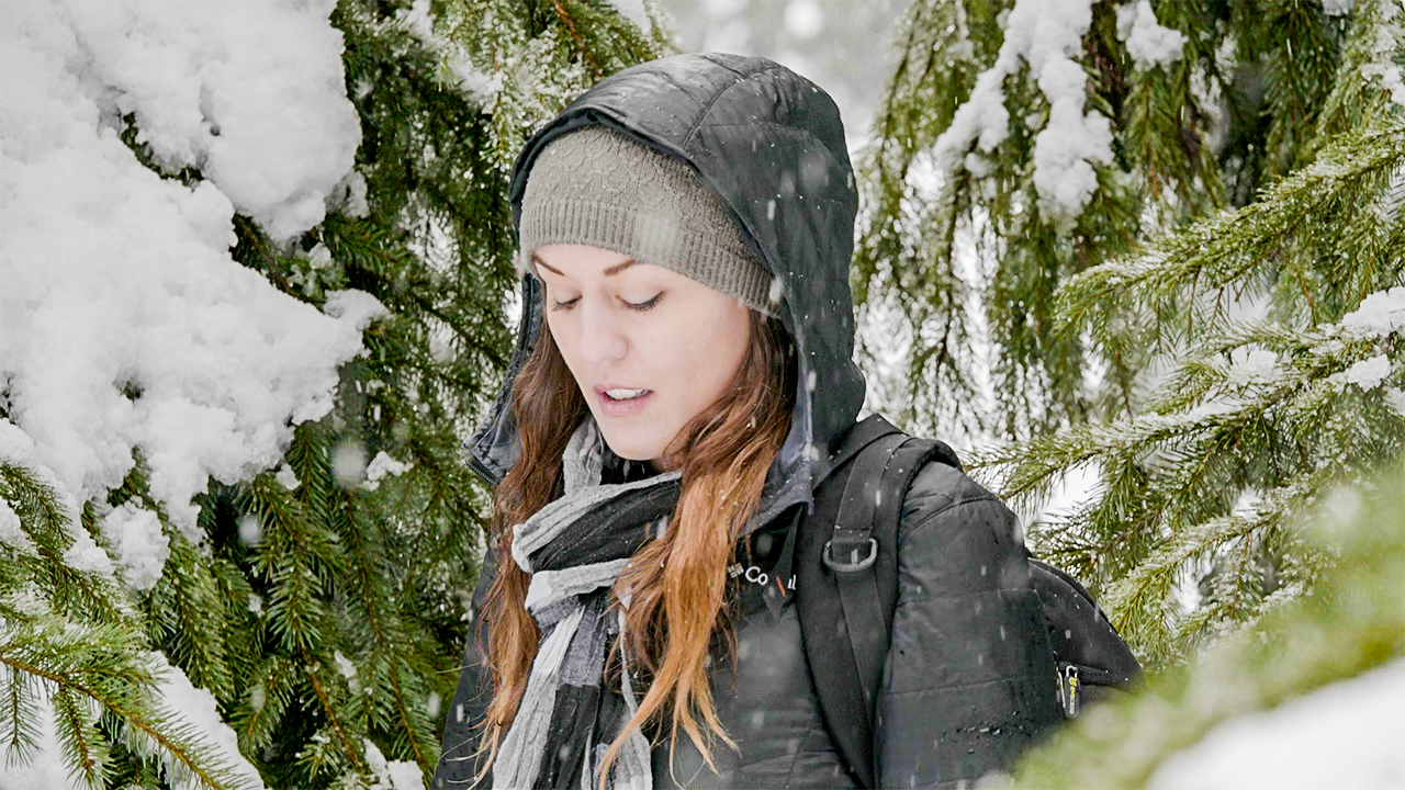

DBounce Posted January 7, 2017 Share Posted January 7, 2017 Color grading is supposed to be an art-form... not an equation. Grade to suite your story. To that point, everything that is done in the creation is there to support the story. From color grading, camera angles/movement, lens selection, background music, lighting, costume to selection of location and talent. All of it. Story telling is not science it is art. When your choices fail to support the story, that is when you fail as a filmmaker. I can say while many choose to grade these scenes as light hearted, and technically correct (read boring) I as did other choose to see them as a canvas to make something much more stylized (read interesting). I would be curious to see other attempts at grading these scenes for different genres: "SciFi", "Horror", "Drama". Because believe me they can't all look exactly the same. Jimmy, webrunner5, Stathman and 2 others 5 Link to comment Share on other sites More sharing options...

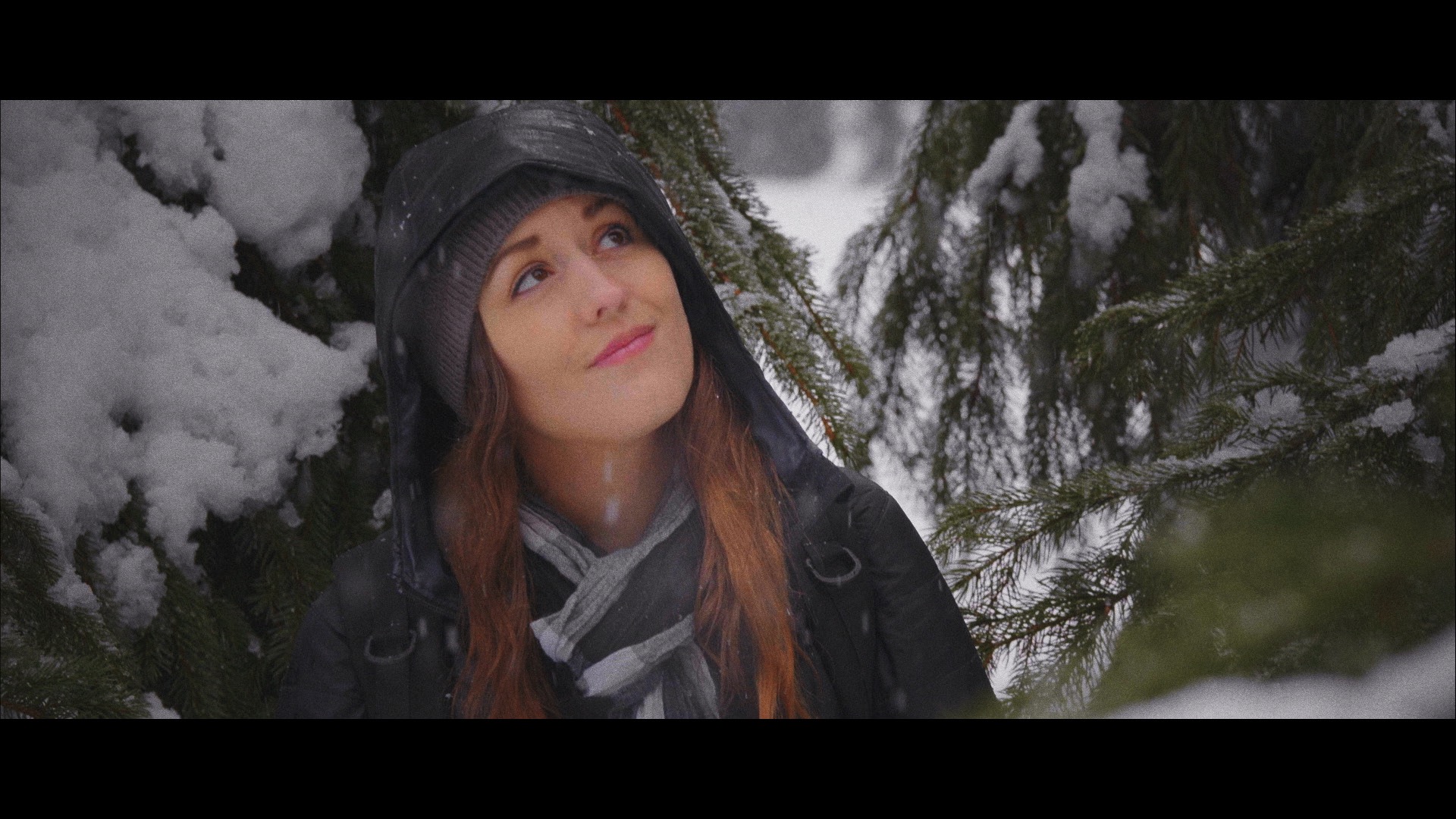

DBounce Posted January 7, 2017 Share Posted January 7, 2017 Here's a test grade with different moods... GH5_Test_Grade.mov Link to comment Share on other sites More sharing options...

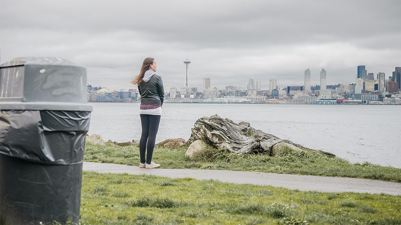

OliKMIA Posted January 8, 2017 Share Posted January 8, 2017 Here is mine. Usual Caveat, I'm not a Pro Colorist. I tried to do something balanced being light on the curve and contrast because I don't like the usual crushed black look. In terms of mood I decided to keep it on the cool side that fit the humid/snowy Seattle scene. Constructive critics and tips are welcome. If I did something wrong, please tell me how to fix it. Thanks Link to comment Share on other sites More sharing options...

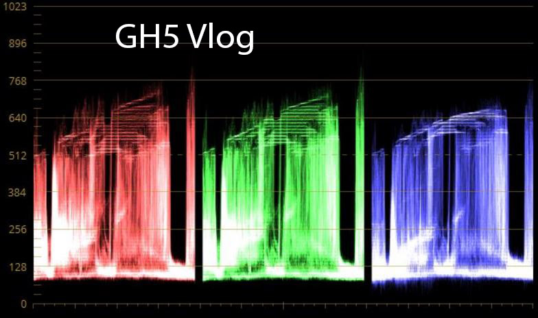

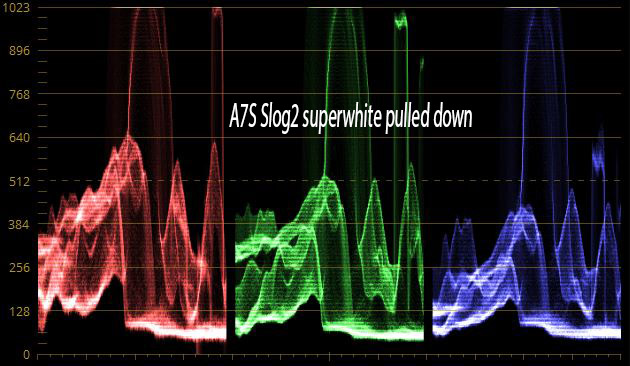

wildrym Posted January 8, 2017 Share Posted January 8, 2017 6 hours ago, Ishak Sahertian said: I don't think V-log records less "shades" than the other profiles, probably more like that everything(what the sensor is able to capture) is being compressed between 20 and 80IRE 4 hours ago, webrunner5 said: True, it pulls up the shadows, and pulls down the highlights into a narrower box. Pretty much it in a nutshell. Yes I get it, but what I mean is that instead of using almost 1024 values, it is limited to only 600ish. In 10 bit files, it is ok i guess (even though non optimal), but in 8 bit files it becomes only 160ish values. So using Vlog in 4k 60p may lead to severe banding. In comparison here are two waveforms from a7s 4k slog2 footage. The second is the same as the first one with superwhite pulled down. Third is GH5. As you can see, sony files use roughly IRE from 10 to 109, so approximately 230ish values in 8 bit. It 10 bit it would be 950ish values which would give better tonality than GH5 Vlog files. That is why I find it quite disapointing (tell me if I'm wrong with my reasoning!) Ishak Sahertian 1 Link to comment Share on other sites More sharing options...
Ishak Sahertian Posted January 8, 2017 Share Posted January 8, 2017 @wildrym Aaah I see... No you're right, that's why it's called V-Log L, L stands for light. I read on PV some rumors that the Varicam people weren't too happy about giving a consumercamera the full flegded V-log, so now we're stuck with a half assed Log profile. I'm hoping the Hybrid Log Gamma update coming in the summer will be better optimized , eliminating the need for V-log L. Link to comment Share on other sites More sharing options...
Ishak Sahertian Posted January 8, 2017 Share Posted January 8, 2017 3 hours ago, wildrym said: As you can see, sony files use roughly IRE from 10 to 109, so approximately 230ish values in 8 bit. It 10 bit it would be 950ish values which would give better tonality than GH5 Vlog files. remember right now the current alpha series cameras still don't output 10bit throught the HDMI only 8bit.. but that may change in the future if they decide not to pull a "canon"(by protecting their cinemaline) webrunner5 1 Link to comment Share on other sites More sharing options...

mercer Posted January 8, 2017 Share Posted January 8, 2017 Took another try using Mojo 2 and added a little grain... Link to comment Share on other sites More sharing options...
mercer Posted January 8, 2017 Share Posted January 8, 2017 Dang it... my monitor must be messed. It looked fine on my computer but now her face looks too orange on my phone... in my narrative, Neumann's wife just went to a tanning salon before her walk in the woods... Link to comment Share on other sites More sharing options...
