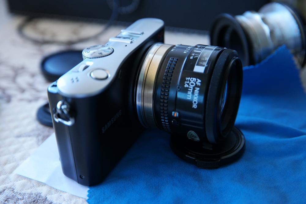

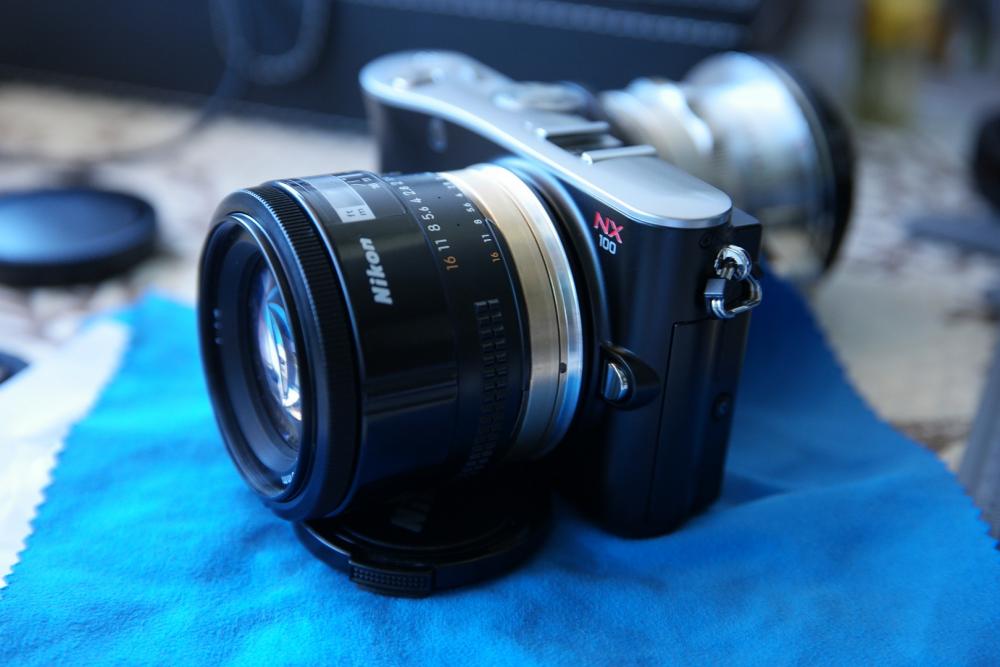

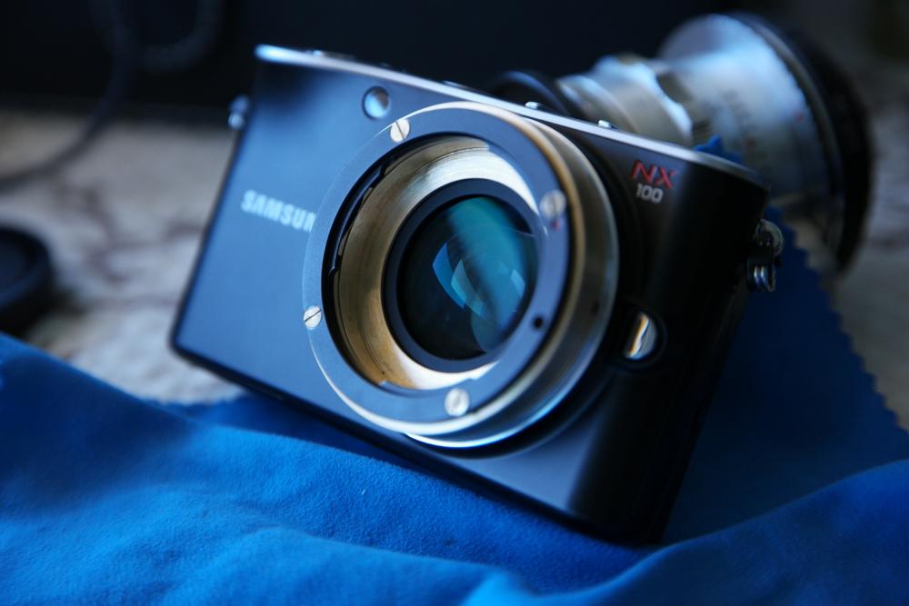

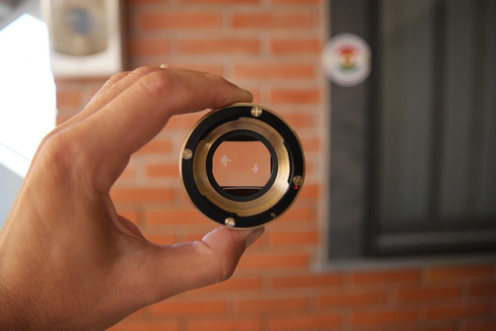

Popular Post lucabutera Posted July 23, 2016 Popular Post Share Posted July 23, 2016 23 hours ago, Marco Tecno said: Any news about speedbooster? Hallo NX World, the NX Booster it's coming soon! This is the Prototype Mark II. Marco do not worry, if I do not post my progress, is because I have a lot of work in my private life. Next week I start the test with Nx1 camera. tokhee, kidzrevil, Calum MacPhail and 14 others 17 Link to comment Share on other sites More sharing options...

vaga Posted July 23, 2016 Share Posted July 23, 2016 That adapter looks really well made! I'm impressed. So are you planning to do smart stuff? Maybe I can help you with that tokhee, Marco Tecno and Pavel D Prichystal 3 Link to comment Share on other sites More sharing options...

lucabutera Posted July 23, 2016 Share Posted July 23, 2016 23 minutes ago, Marco Tecno said: Even for the intelligent adapter with af? It: intendo l'adattatore con fuoco automatico ed apertura controllata dai comandi. At first he told me (see previous post), but since then nothing. I also tried to contact him privately on dpreview.com but even there he did not answer. I continue with my work, however, it goes very well, I hope to have a pre-set ready by the beginning of August for the NX-Nikon adapter system, which, in addition to providing me different information on the operation of SB lenses, it is cheap compared to an intelligent system. I can say with certainty is that the system is very sharp, and coupled with fast lens offers a beautiful Boke. It: All'inizio Ihkim mi ha risposto (vedi post precedenti) ma, da allora più nulla. Ho anche provato a contattarlo privatamente su dpreview.com ma anche lì non mi ha risposto. Io continuo comunque con il mio lavoro, che procede molto bene, spero di riuscire ad avere una pre-serie pronta entro i primi giorni di agosto per il sistema NX-Nikon adattatore, che, oltre a fornirmi diverse informazioni sul funzionamento delle lenti SB, è anche economico rispetto ad un sistema intelligente. quello che posso affermare con certezza è che il sistema è molto nitido, ed abbinato a lenti veloci offre un bellissimo Boke. iamoui, sandro, SMGJohn and 2 others 5 Link to comment Share on other sites More sharing options...
