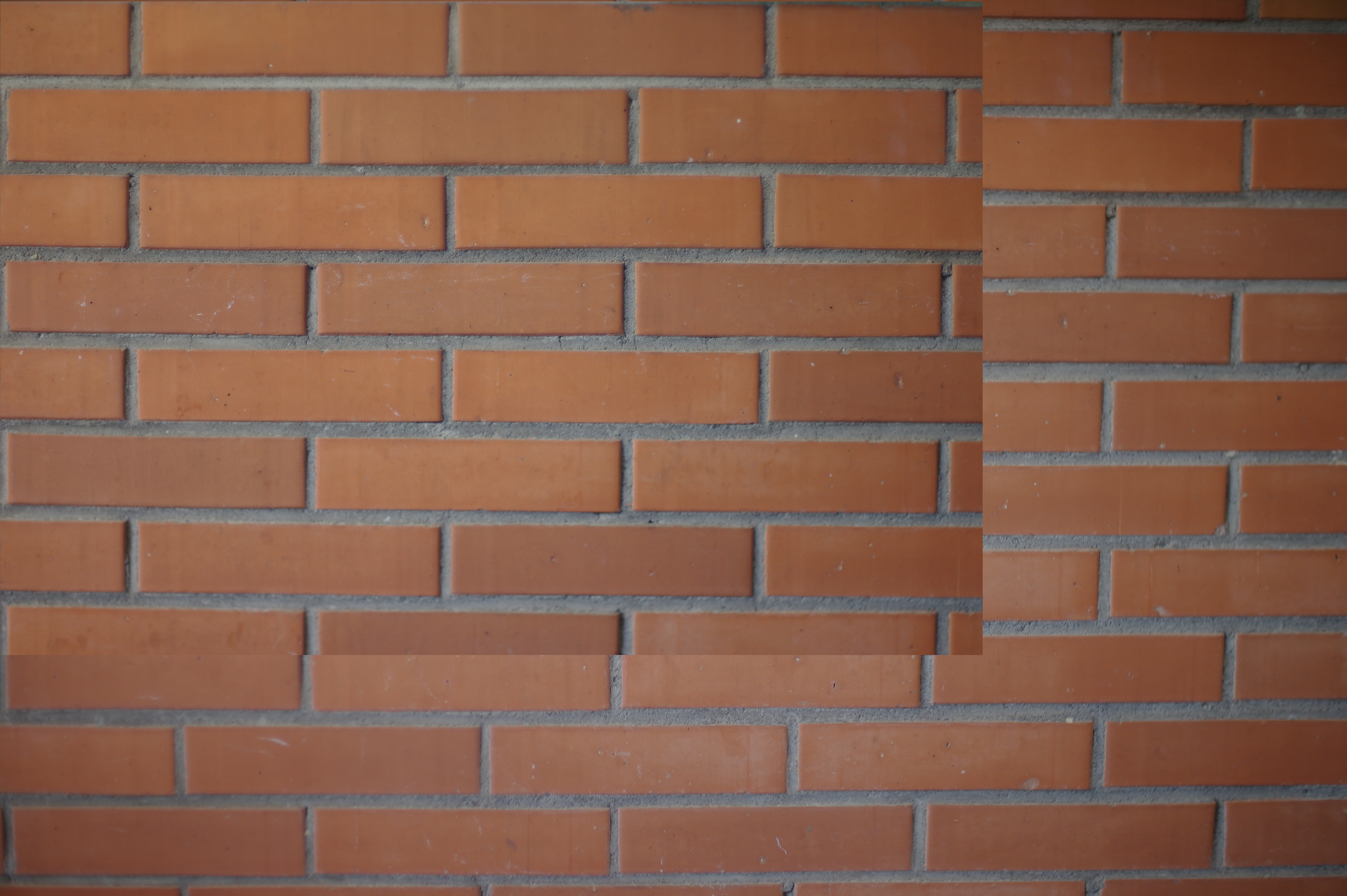

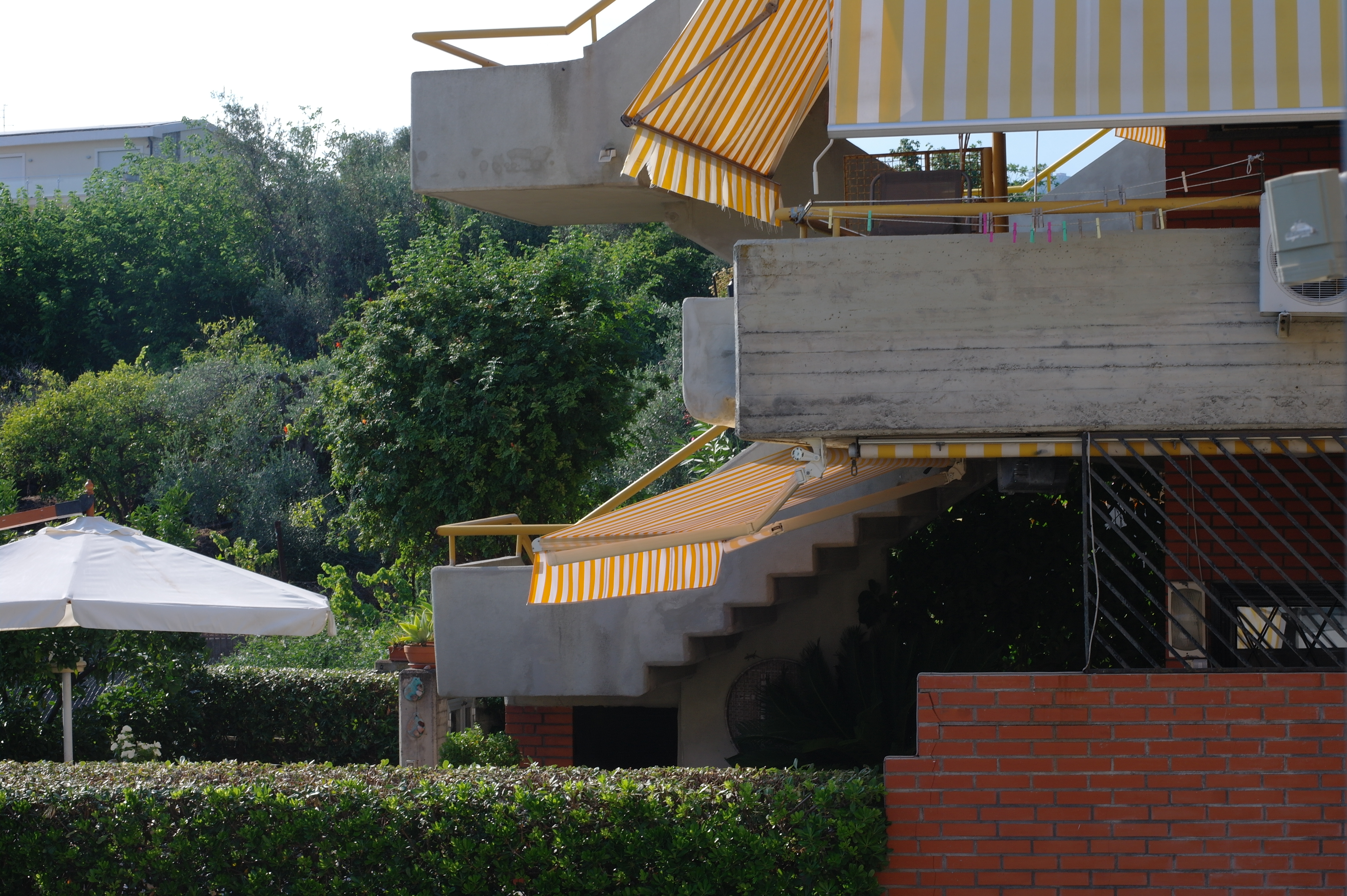

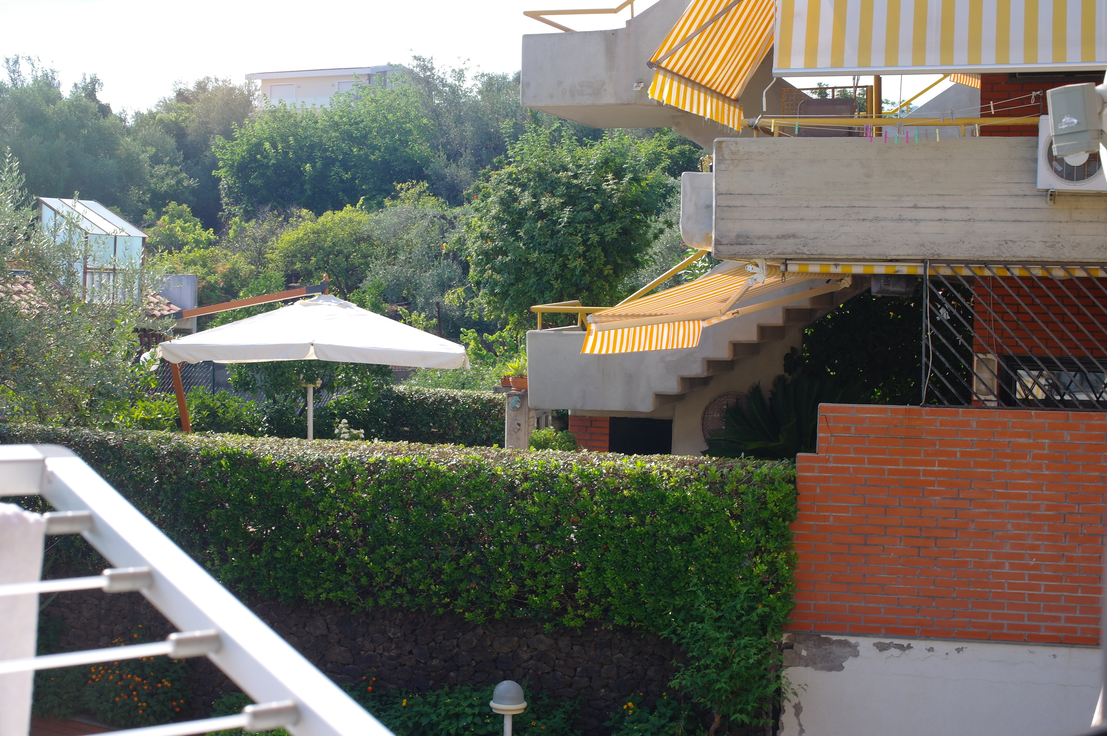

lucabutera Posted July 8, 2016 Share Posted July 8, 2016 II° test. I use the same lens (nikkor 50mm 1.4) in both photos. Link to comment Share on other sites More sharing options...
lucabutera Posted July 11, 2016 Share Posted July 11, 2016 First video: "Samsung NX100 + Speed Booster prototype". For my test, I use the Samsung NX100 camera with Nikon Nikkor 50mm f1.4. Pavel Mašek, Geoff CB, saintsimon2016 and 3 others 6 Link to comment Share on other sites More sharing options...

Pavel Mašek Posted July 12, 2016 Share Posted July 12, 2016 17 hours ago, lucabutera said: Yes Marco, it's a speed booster prototype selfmade. It's possible. In the nex time I post my full work on it, and begginning the test on NX1 camera. I have checked the photos and it seems that there is really 50% more of "image" on second photo. Second one is also brighter (there is more light that comes to sensor) with same shutter speed 1/60s (and probably same aperture). Image quality seems to be also good enough. Fullframe NX1!!! YES!!! Marco Tecno and Parker 2 Link to comment Share on other sites More sharing options...

lucabutera Posted July 12, 2016 Share Posted July 12, 2016 Wall test. Pavel Mašek, sandro, Parker and 5 others 8 Link to comment Share on other sites More sharing options...
