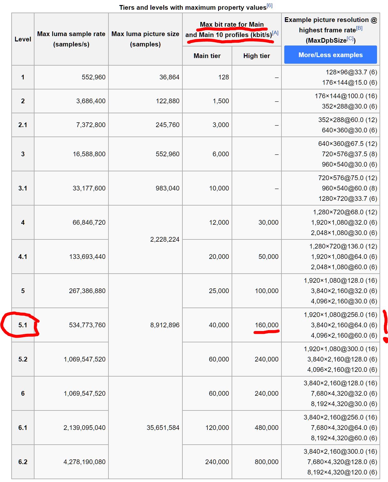

Chant Posted March 6, 2016 Share Posted March 6, 2016 17 hours ago, Syme said: Out of curiosity, how did you find the clock speed? It was in a cpu config file. But in early firmware, I am plotting the changes and original values to see what sort of leverage can happen with them. 12 hours ago, derderimmermuedeist said: If i see it right (in the Chart) then the maximum Bitrate for the H.265 HEVC is at Level 5.1 (found this Level in the File-Infos of my NX1-Videos) 160.000 kbit/s, approximately 156 Mbit/s. And interessting too, the maximum Frame rates: c4k @ 60p UHD @ 64p an FHD @ 256p This is something that I have also been looking into. With luck it is just the change of an output flag and see if things can be pushed to a higher limit. HEVC and other compression systems are less intensive with less compression, so in theory it should be able to bump up to the bus limit and have less compressed files. In the later firmware the change from 15fps to 25fps for the raw output sort of shows the ceiling of bandwidth the processor can handle. Give or take 30MB raw file x 25fps data stream is 750MBs/6000Mbs My goal is to see how close to the spec of a red weapon the nx1 can be. HEVC is sort of a pain but the way it works is more like the wavelet based .r3d files when HEVC is at lower compression rates. But the more I find the more interesting things get. And the things they did for this camera make it vastly unique compared to a canon or a sony. 5 hours ago, Marco Tecno said: I guess the ideal thing would be to write a virtual machine for running experimental NX1 fw into it. It won't guarantee that no risk is taken once ported onto the real thing, but it would actually lower the risk by a large margin. I don't know if this is easily feasible, though. Another great (but difficult thing) thing would be a "fw pushing" service from a PC, so that you can push a new fw onto NX1 no matter it's state. Another ideal thing would be a recovery, to be invoked by some keypress. The complexity of the nx1 makes that quite hard, if I am correct and there is an fpga/cpld core on board it gets more tricky. I have seen some signs though. No confirmation yet. More work will be done tonight on the dive though. I have compiled a large data sheet already on the things I have found in the first firmware update. But going though the code takes time. And if people are having issues with HEVC I highly recommend getting a GTX960 so far the only gpu with fully enabled on board HEVC encode/decode and boy does it work well. And they are not very expensive. If you go by how HEVC does compression, when you transcode it would be in the Gbs if the data rate is doubled on camera Marco Tecno, SMGJohn and kidzrevil 3 Link to comment Share on other sites More sharing options...
