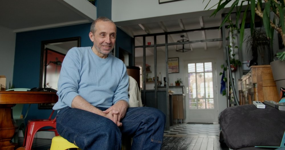

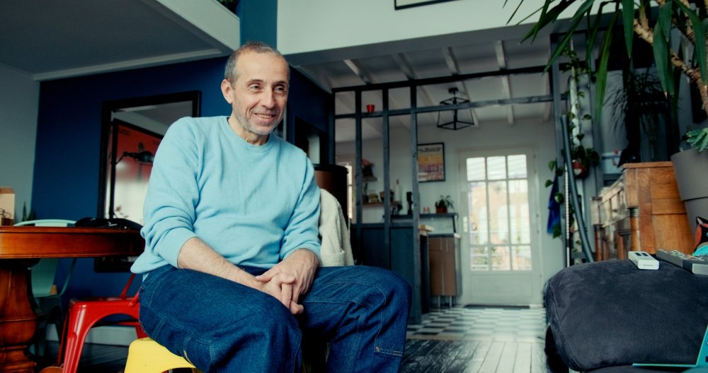

BrunoCH Posted March 24, 2023 Share Posted March 24, 2023 7 hours ago, Django said: So yeah poor colour separation when shooting at a certain distance. I've noticed colours get mushy in those scenarios. Your subject has to remain fairly close. I like what this one kid has achieved with his XH2S, the grade is a little extreme and stylised but really makes the colours pop in a pleasant way: If you like this kind of grading, the Resolve FUJI LUT could be a good start. Link to comment Share on other sites More sharing options...

Django Posted March 24, 2023 Share Posted March 24, 2023 1 hour ago, BrunoCH said: If you like this kind of grading, the Resolve FUJI LUT could be a good start. What do you mean by "Resolve FUJI LUT"? I use the official Fuji Flog/Flog2 LUTs to convert to Rec709. I'm not aware of any particular Fuji LUTs in Resolve aside from the film stock emulation ones..? 57 minutes ago, SRV1981 said: Naive question, because I too like the nostalgia Fuji provides internally, but with cameras like s5ii and others providing internally baked LUTs - doesn’t that mean you could get equal or better creative looks with minimal post processing ? With cameras like S5II or FX3/FX30 you can indeed import custom LUTs which is great but not the same thing as Fuji film simulations. There are a bunch of parameters in Fuji film simulations that you can tweak and dial-in to create what they call "Fuji recipes". For stills that even includes film grain size, type etc. SRV1981 1 Link to comment Share on other sites More sharing options...
BrunoCH Posted March 24, 2023 Share Posted March 24, 2023 1 hour ago, Django said: What do you mean by "Resolve FUJI LUT"? I use the official Fuji Flog/Flog2 LUTs to convert to Rec709. I'm not aware of any particular Fuji LUTs in Resolve aside from the film stock emulation ones..? Yes I mean the Film look LUT from Resolve (stock emulation). I don't use the FUJI LUTs to delog the Flog, I prefer color management. Link to comment Share on other sites More sharing options...

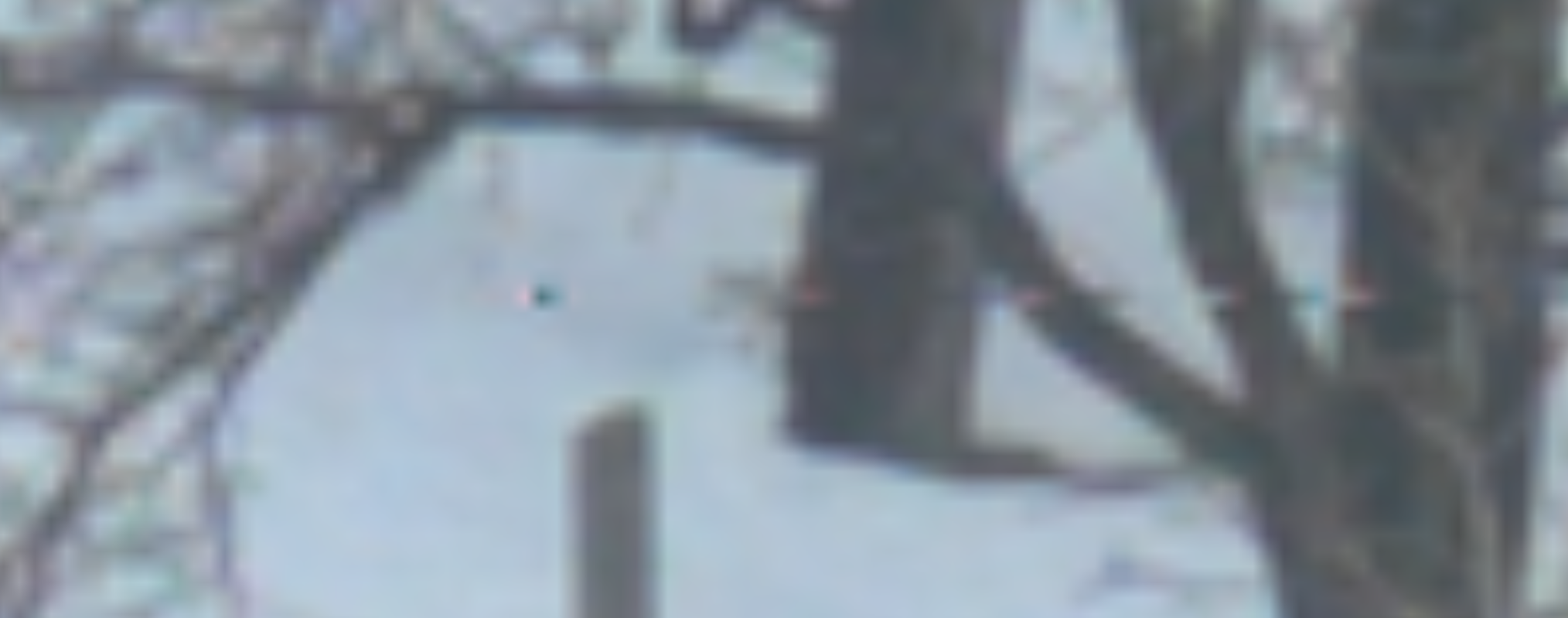

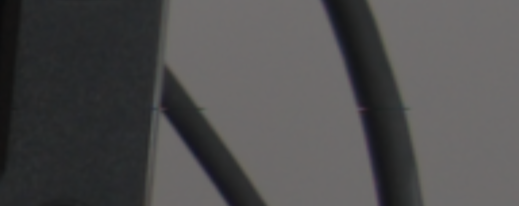

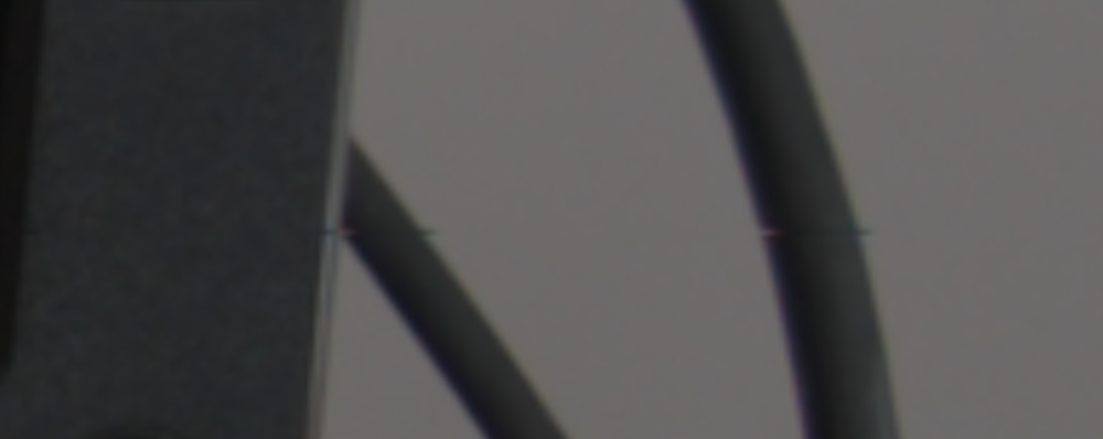

Attila Bakos Posted March 25, 2023 Share Posted March 25, 2023 Remember we discussed earlier that X-H2s 6.2K ProRes RAW has a hot pixel at the exact same location for everyone? I spent days to create an executable in C++ that removes that hot pixel from the DNG raw file created from ProRes RAW. I was just about to post it here but then I noticed that this is not a hot pixel issue at all! All pixels in the same row right from the hot pixel are shifted towards the right. See here: It starts with the hot pixel, and it goes all the way to the right edge. Or here (this is the right edge of an image, you don't see the hot pixel here, it's somewhere in the middle): Atomos says it's Fuji's fault, and as usual, Fuji couldn't care less. Atomos is also silent about the framerate bug I discovered. A new firmware was released just now and it's not fixed, it's not even listed in the known bugs. Stuff like this makes me really disillusioned. PannySVHS, Daniel Robben, Davide DB and 3 others 3 3 Link to comment Share on other sites More sharing options...
