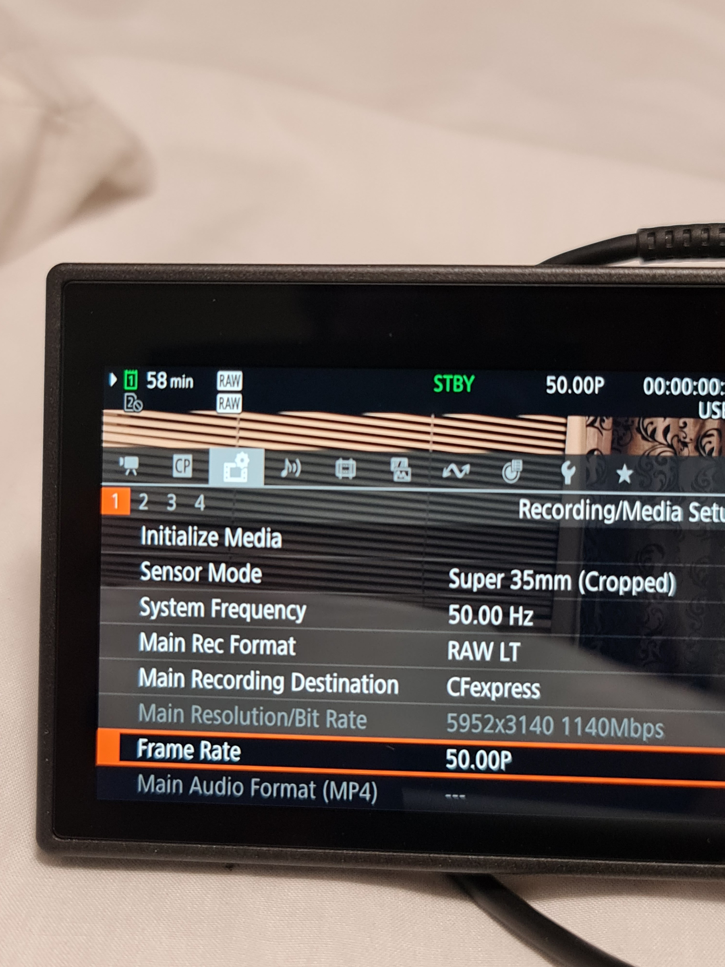

ntblowz Posted March 25, 2022 Share Posted March 25, 2022 Got the R5c today, checked the video AF and it locked on fine. 512GB only last 30min of 8k50p, on 5.9k 50p it last nearly an hour which is more doable. Might have to use the speedbooster again for 5.9k raw 🤔 And battery life is much worse than R5, 4k50p last 40 something min so I guess I will be pairing with my 18w pd powerbank for long tripod shoot.. Btw absolutely no video on photo mode. You have to switch mode to do video and vice versa. Body and operating wise it feels like mini c70 when shooting video, better balance with lens than R5 I reckon.  kye, Video Hummus, Juank and 4 others 6 1 Link to comment Share on other sites More sharing options...

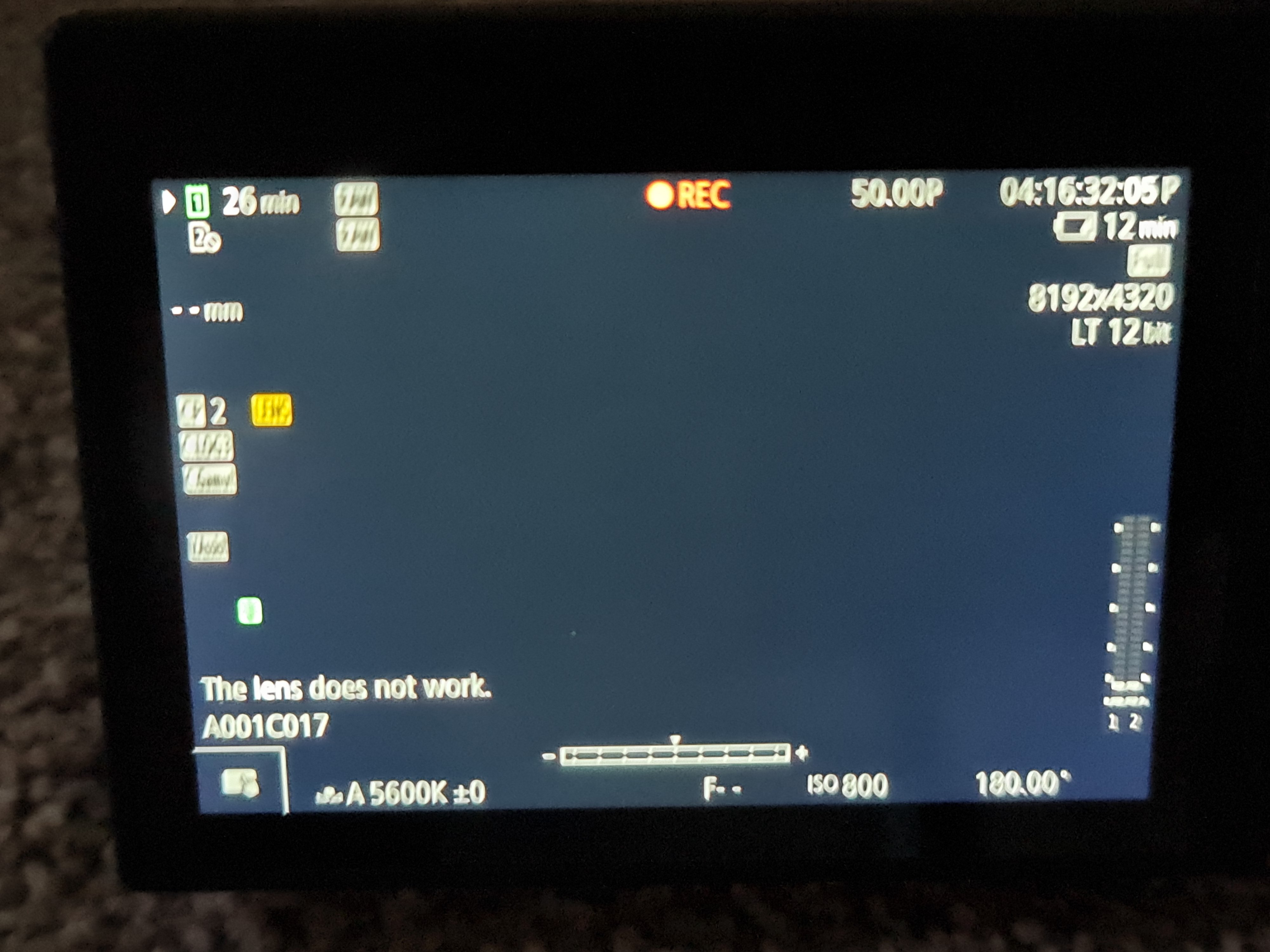

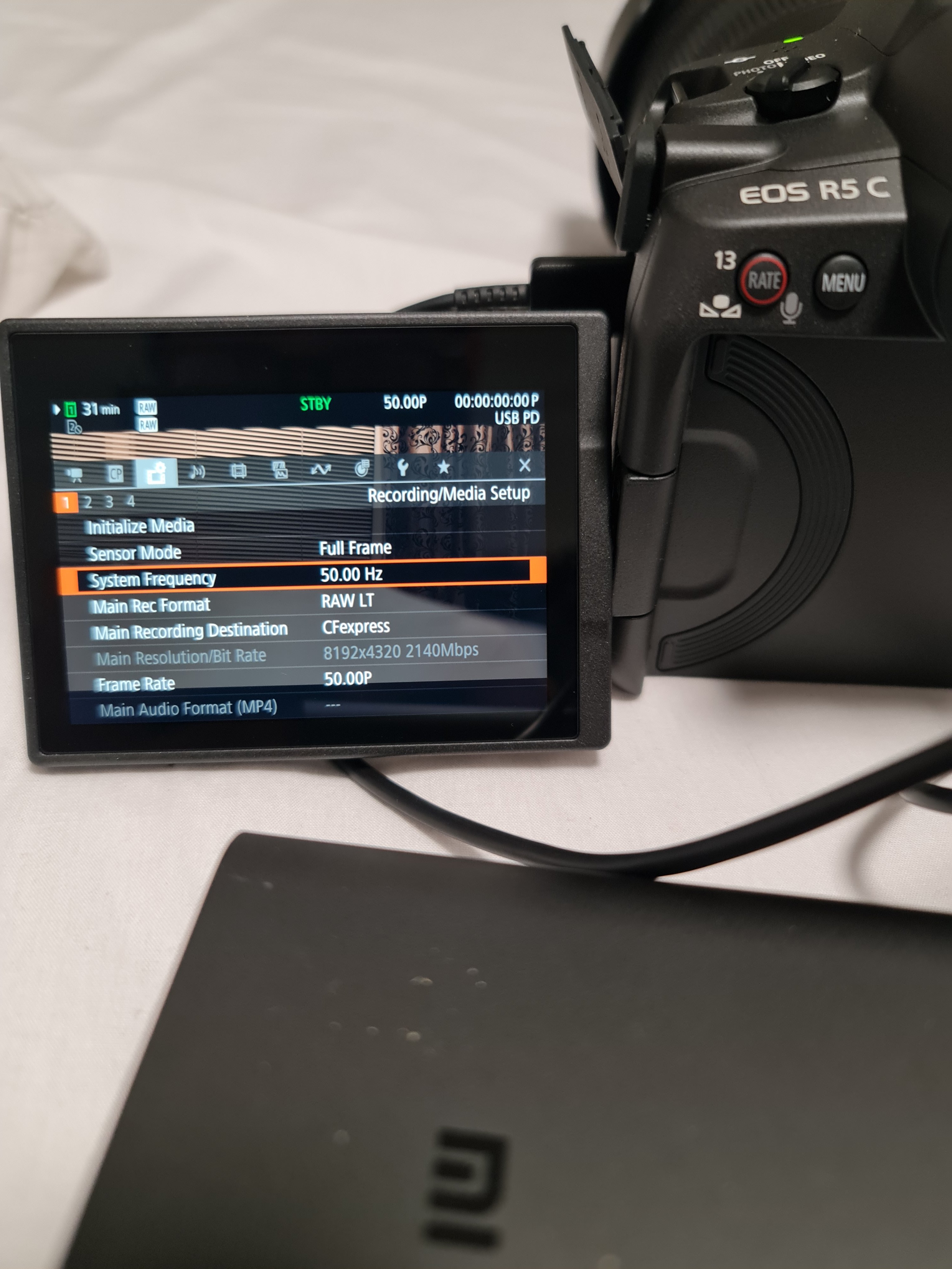

ntblowz Posted March 29, 2022 Share Posted March 29, 2022 12 hours ago, HurtinMinorKey said: So what brand of external battery do you use? And I thought you can use the internal battery for recording in 8K 50/60p raw, you just loose all power to the lens. Is this not the case? Oops u r right, it can record internally but will show this message.  I use mi powerbank pro 3 20000mah 45w, I see they have new model with 50w power, u just plug usb-c/usb-c port to both the powerbank and on the camera, no need decoupler  HurtinMinorKey 1 Link to comment Share on other sites More sharing options...

ntblowz Posted March 29, 2022 Share Posted March 29, 2022 1 hour ago, Emanuel said: So, no IS provided in-lens going with 8K 50p/60p? If using internal battery, if powered external there is IS from the lens. filmmakereu and HurtinMinorKey 2 Link to comment Share on other sites More sharing options...

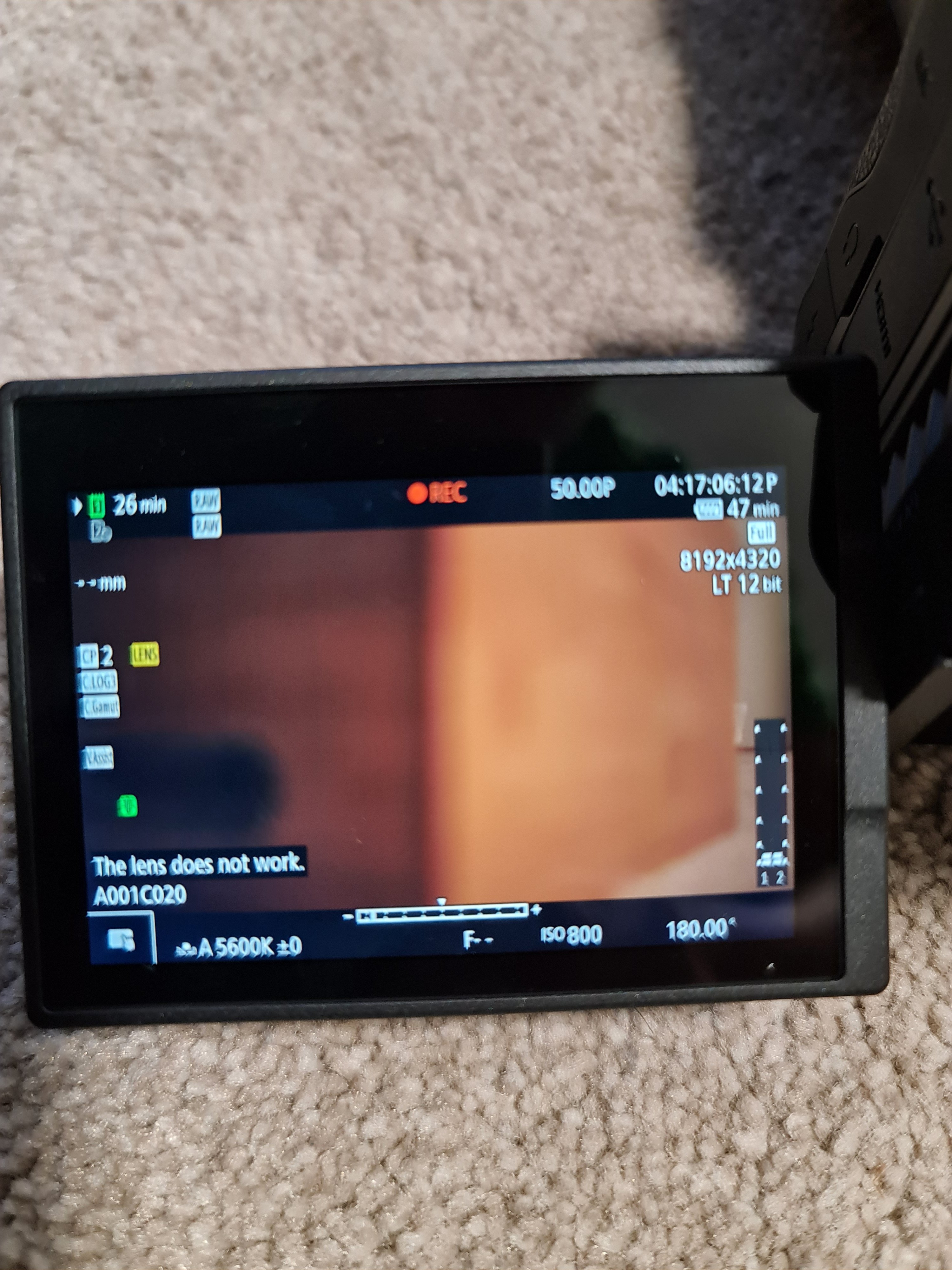

gt3rs Posted March 29, 2022 Share Posted March 29, 2022 1 hour ago, ntblowz said: Oops u r right, it can record internally but will show this message.  I use mi powerbank pro 3 20000mah 45w, I see they have new model with 50w power, u just plug usb-c/usb-c port to both the powerbank and on the camera, no need decoupler  Could you test with a full battery 8k RAW LT 50p with AF and IS on? As some reviewers (who trust them 🙂 ) mention that it works up to 50p.... Link to comment Share on other sites More sharing options...
ntblowz Posted March 29, 2022 Share Posted March 29, 2022 1 hour ago, gt3rs said: Could you test with a full battery 8k RAW LT 50p with AF and IS on? As some reviewers (who trust them 🙂 ) mention that it works up to 50p.... Still doesn't work with full Battery HurtinMinorKey and gt3rs 1 1 Link to comment Share on other sites More sharing options...
Emanuel Posted March 29, 2022 Share Posted March 29, 2022 As far as I could understand, we strictly need external battery to reach 8K RAW LT 50p going with AF + IS but both work with RF lens (I guess with EF lens adapter too?), correct? How come and from where comes that information you mention to be more precise mate @gt3rs? filmmakereu 1 Link to comment Share on other sites More sharing options...
gt3rs Posted March 29, 2022 Share Posted March 29, 2022 2 hours ago, Emanuel said: As far as I could understand, we strictly need external battery to reach 8K RAW LT 50p going with AF + IS but both work with RF lens (I guess with EF lens adapter too?), correct? How come and from where comes that information you mention to be more precise mate @gt3rs? From the official spec it was always clear that 8K 50/60 works with internal battery only without AF and IS, with external power AF IS works as normal including EF lenses. If I recall correctly that Gordon got it working on internal battery 8k 50p (not 60) with AF and IS but it was a pre release camera. This could even be lens dependent as I can imagine that you need less power for a 35 1.8 IS than for a 400 2.8 IS lens or could be that the final firmware simply does not allow it anymore as it may not be reliable. Emanuel and filmmakereu 1 1 Link to comment Share on other sites More sharing options...

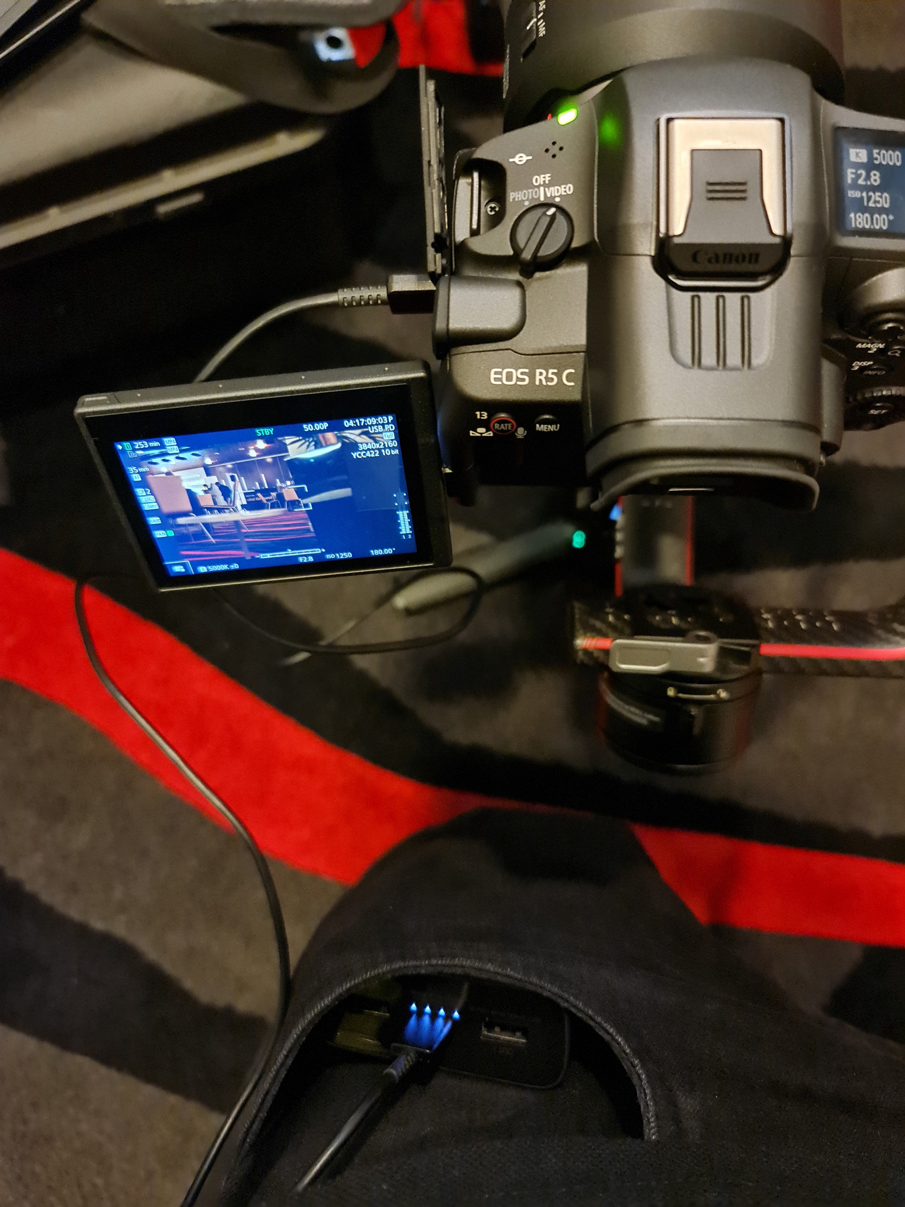

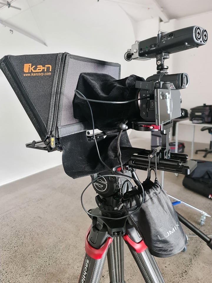

ntblowz Posted March 29, 2022 Share Posted March 29, 2022 I might need to try on light lens (the 50/16 rf), atm only have L RF lens  Btw this is how I usually shoot with r5c, use powerbank connect directly to camera HurtinMinorKey 1 Link to comment Share on other sites More sharing options...
