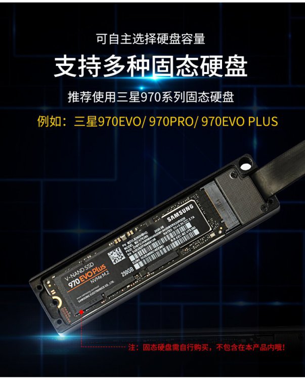

Rob6 Posted September 11, 2020 Share Posted September 11, 2020 Any chance this cfexpress to nvme ssd could work? https://www.ebay.com/itm/184438464836 andjo, horshack and visionrouge 1 2 Link to comment Share on other sites More sharing options...

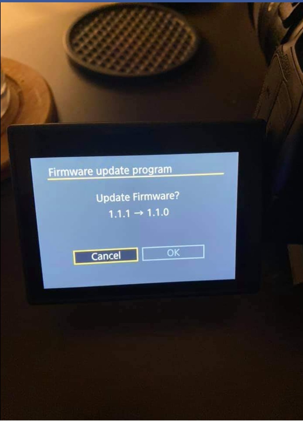

ntblowz Posted September 11, 2020 Share Posted September 11, 2020 Btw u can downgrade firmware Vavid Cincent, Emanuel and visionrouge 1 2 Link to comment Share on other sites More sharing options...

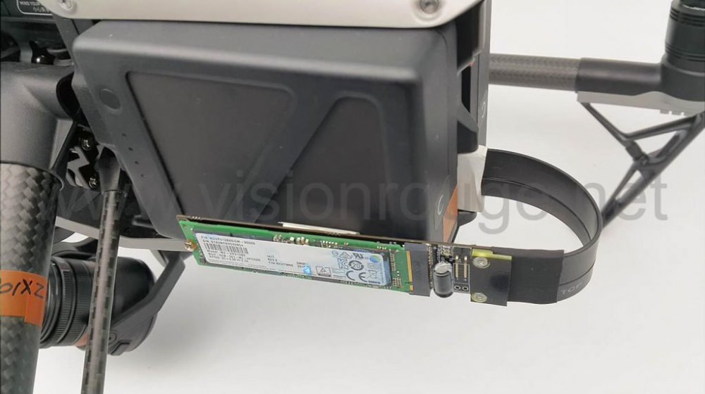

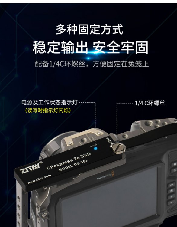

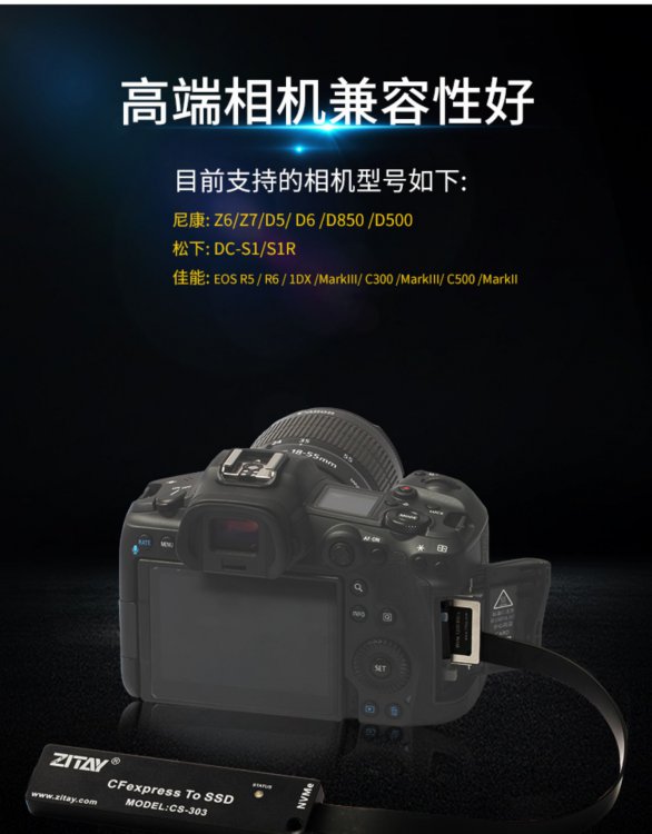

visionrouge Posted September 12, 2020 Share Posted September 12, 2020 8 hours ago, Rob6 said: Any chance this cfexpress to nvme ssd could work? https://www.ebay.com/itm/184438464836 Great finding, I was looking for such without success few weeks back. I guess t's about market demand versus offer! I did similar test on my DJI Inspire 2 and I did not lost any data writing raw 5K. I'ts also a money saver as you only buying the drive and not the card. This is one way to solve 2 issues at once. USD 150 if you found them online in China. https://item.taobao.com/item.htm?spm=a230r.1.14.28.29076df3HVdowO&id=626009844453 The price will be falling down as soon as competition kicks in. Rob6 1 Link to comment Share on other sites More sharing options...
Rob6 Posted September 12, 2020 Share Posted September 12, 2020 1 hour ago, visionrouge said: Great finding, I was looking for such without success few weeks back. I guess t's about market demand versus offer! I did similar test on my DJI Inspire 2 and I did not lost any data writing raw 5K. I'ts also a money saver as you only buying the drive and not the card. This is one way to solve 2 issues at once. USD 150 if you found them online in China. https://item.taobao.com/item.htm?spm=a230r.1.14.28.29076df3HVdowO&id=626009844453 The price will be falling down as soon as competition kicks in. Good to know. Thanks! Which nvme do you recommend? On the r5 how would you close the card door? Do you just have to leave it open and press in some trigger somewhere to make it think it’s closed? Recording 8k raw with a backup to the Sd card would be a good option for this method to give it some reliability. Thanks! Link to comment Share on other sites More sharing options...

andjo Posted September 12, 2020 Share Posted September 12, 2020 13 hours ago, Rob6 said: Any chance this cfexpress to nvme ssd could work? https://www.ebay.com/itm/184438464836 I wonder if a adapter like this will help to transfer some of the heat away from the body. But in general just being able to use a SSD over CFexpress would be a huge advantage $$. Above my technical skills but here's someone that created their own adapter + DIY https://old.reddit.com/r/canon/comments/i4082w/made_a_cfexpress_to_m2_nvme_ssd_adapter/ Link to comment Share on other sites More sharing options...
Emanuel Posted September 12, 2020 Share Posted September 12, 2020 What about this one here? https://www.techpowerup.com/forums/threads/angelbird-announces-cfexpress-cards.259049/#post-4113504 "NVMe is not a removable media. Thats like designing a camera for a 3.5" hard drive. They are not meant to be moved constantly. NVMe is also very power hungry, meaning your camera would need a larger battery, a cooling system, a pcie controller and other things cameras are not designed around." Link to comment Share on other sites More sharing options...

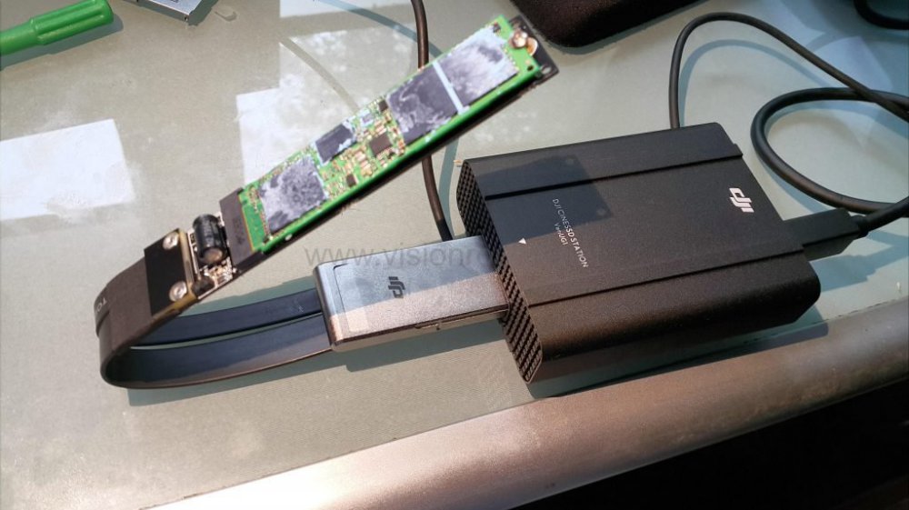

visionrouge Posted September 12, 2020 Share Posted September 12, 2020 24 minutes ago, Emanuel said: "NVMe is not a removable media. You are taking sentence out of the context. Yes, a drive is not removable easily from the enclosure and, no you may not swap drive on the fly. It's like saying SSD are not removable media. Still, they are used everyday as removable media cause the interface is something else that what is inside the enclosure. But this system is an enclosure for NVMe drive that will put the heat away from the card reader , allowing cheaper and very large drive capacity. The heat generated by the card can be way easier dissipated than a CFExpress card. I actually have such enclosure for another project, it's all aluminium with a thermal pad around And, by the way, you should talk to DJI; this is what they use on their Inspire 2 as drive.... But they change the connector type to be more sturdy. If you look at ZITAY product, they already successfully implement such solution for black-magic camera, without a need for extra external power. (CFFast to SSD) The product needs to be tested, but it specifically states R5 and Z6 / Z7 (and other C300 camera) It have a screw thread to secure it to a cage. This will help dissipate heat. And if you go for large version, it's a great option to reduce overall cost. CFExpress card are kinda 512 GB max, with nvme you can go to 4TB for similar price. You unscrew the drive when you have 4TB of data, so, maybe one a day. This product come with a cover to push the door switch and so let the cable going out. So the door will be open during shooting. I have 0 test so far, but it's look great to me on the paper. I let you do some research on their website, and not just pick up sentences from a different discussion in a blog. ntblowz, Emanuel, Vavid Cincent and 1 other 2 2 Link to comment Share on other sites More sharing options...

Emanuel Posted September 13, 2020 Share Posted September 13, 2020 On 9/12/2020 at 10:36 AM, visionrouge said: You are taking sentence out of the context. Yes, a drive is not removable easily from the enclosure and, no you may not swap drive on the fly. It's like saying SSD are not removable media. Still, they are used everyday as removable media cause the interface is something else that what is inside the enclosure. But this system is an enclosure for NVMe drive that will put the heat away from the card reader , allowing cheaper and very large drive capacity. The heat generated by the card can be way easier dissipated than a CFExpress card. I actually have such enclosure for another project, it's all aluminium with a thermal pad around And, by the way, you should talk to DJI; this is what they use on their Inspire 2 as drive.... But they change the connector type to be more sturdy. If you look at ZITAY product, they already successfully implement such solution for black-magic camera, without a need for extra external power. (CFFast to SSD) The product needs to be tested, but it specifically states R5 and Z6 / Z7 (and other C300 camera) It have a screw thread to secure it to a cage. This will help dissipate heat. And if you go for large version, it's a great option to reduce overall cost. CFExpress card are kinda 512 GB max, with nvme you can go to 4TB for similar price. You unscrew the drive when you have 4TB of data, so, maybe one a day. This product come with a cover to push the door switch and so let the cable going out. So the door will be open during shooting. I have 0 test so far, but it's look great to me on the paper. I let you do some research on their website, and not just pick up sentences from a different discussion in a blog. 970 Evo Plus is clearly the way to go, price-wise included: https://techtestreport.com/samsung-970-evo-vs-970-evo-plus-vs-970-pro-which-is-the-best/ BTW seems plain obvious to me, you have zero clue about to whom you addressed those words as well the intention of my post up there... I stand my prior notes to express my thanks to you, because I actually succeeded to see you adding a new post to comment it ;- ) Rob6 and techie 2 Link to comment Share on other sites More sharing options...

danieleciraolo Posted September 13, 2020 Share Posted September 13, 2020 I had updated my r5 to version 1.1.1 .. but it did not restore the times with the date change and battery removal. I reverted to version 1.1.0 and resumed the timer reset. Firmware downloaded from canon italy. Who does the reset of the timer with the date change work with version 1.1.1 and r5? Link to comment Share on other sites More sharing options...
