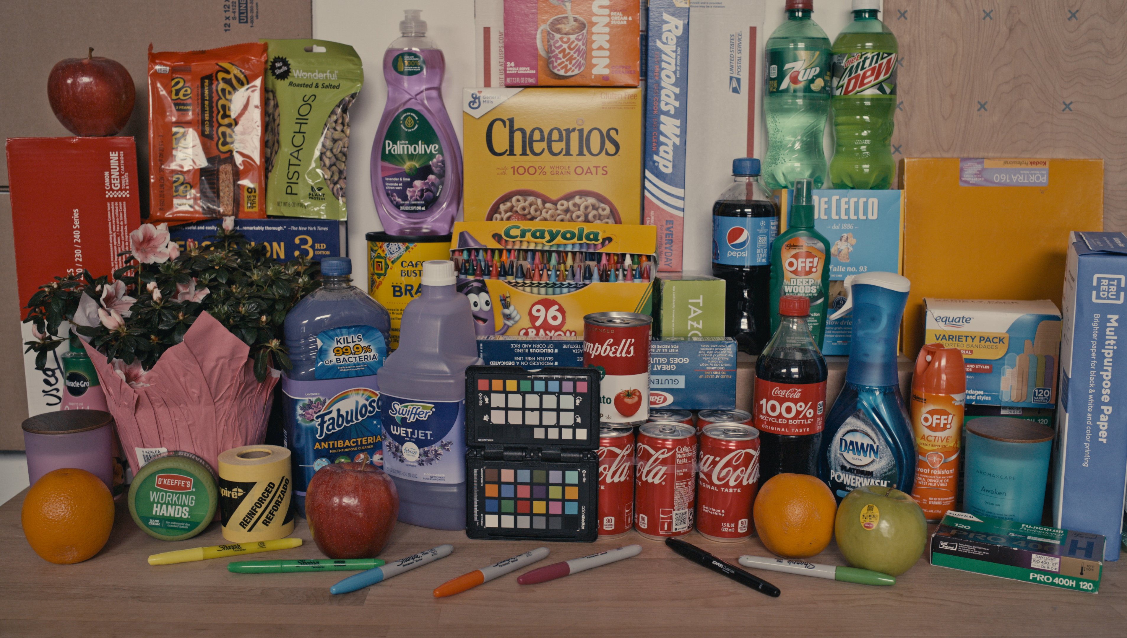

webrunner5 Posted May 7, 2022 Share Posted May 7, 2022 Put a Coke Cola can in that scene. Everyone knows what Red looks like with it as a reference. You have to have the 3 primary colors represented. Llaasseerr and mercer 1 1 Link to comment Share on other sites More sharing options...

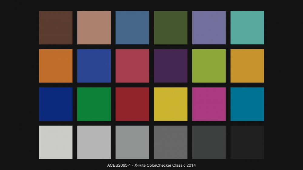

Llaasseerr Posted May 7, 2022 Share Posted May 7, 2022 This image shows how an idealised colorchecker chart looks rendered through ACES AP0 with a Rec709 display target. Link to comment Share on other sites More sharing options...
Ryan Earl Posted May 7, 2022 Share Posted May 7, 2022 8 hours ago, webrunner5 said: Put a Coke Cola can in that scene. Everyone knows what Red looks like with it as a reference. You have to have the 3 primary colors represented. But do they? LOL I attached two more DNG files to check out if anyone is interested with lots of commercial objects including some coke cans. Color "On" with a Kodak Film LUT. kye and webrunner5 1 1 Link to comment Share on other sites More sharing options...
hyalinejim Posted May 7, 2022 Share Posted May 7, 2022 7 hours ago, Llaasseerr said: This image shows how an idealised colorchecker chart looks rendered through ACES AP0 with a Rec709 display target. That's pretty cool, how was that chart generated? I find it hard to figure out sometimes how a Colorchecker should be represented by a given camera. Here the rendering looks a bit low contrast and darker than it should be. Patch D4 is just above 18% grey in reality so should be represented by at least 126, 126, 126 RGB in Rec709. And the brightest patch is 90% reflectance so it should be considerably brighter than shown here. This is what the spectral data provided by X-Rite looks like in a linear gamma, converted to sRGB: But of course a camera recording of this would be in a different gamma. Nevertheless, I always feel that D4 should be at whatever the middle grey values of the colour space is. Here's a photo of a Colorchecker using Adobe Standard picture profile: D4 patch is the same but highlights are lower (there's a highlight roll off rather than clipping at 100% reflectance which you would get in scene linear) and the shadows are darker. All this is to say that be wary of digital representations of colour charts for video applications. The spectral data file provided by X Rite is useful for calibrating the linear colour response of RAW camera profiles, but there are gamma issues to consider when matching actual shots to representations of charts: the gamma of the camera may not (and perhaps should not) match the gamma of the generated chart. In this case, if somebody can get the different flavours of DNG into a scene linear gamma with no highlight recovery then the middle image above is what the visual reference should be for testing which flavour has the more accurate colour Link to comment Share on other sites More sharing options...
webrunner5 Posted May 8, 2022 Share Posted May 8, 2022 1 hour ago, Ryan Earl said: But do they? LOL I attached two more DNG files to check out if anyone is interested with lots of commercial objects including some coke cans. Color "On" with a Kodak Film LUT. That looks pretty close to reality I think, maybe a Little bit on the lighter side but I think that is the best so far. But keep in mind I think everyone sees color a bit different and some people are just plain color blind. They say women see color different than men do. They distinguish pastels better for one thing. Sure aren't going to argue with them that is for sure. Thomas Hill and PannySVHS 2 Link to comment Share on other sites More sharing options...
