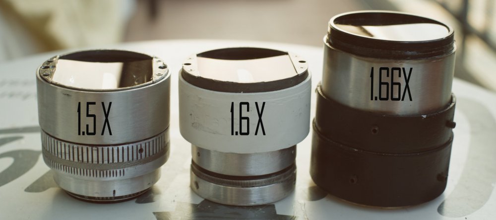

Popular Post Cosimo Posted June 4, 2020 Popular Post Share Posted June 4, 2020 Matching different cylinders glass from different anamorphic scope is equivalent of a cylindrical Galilean telescope running backwards, finding a match with different systems that meet the afocal condition. Here are few prototypes I put together and some sample shots. I hope you like, thanks! . rokkimort, kye, AndreasK and 11 others 12 1 1 Link to comment Share on other sites More sharing options...
PannySVHS Posted June 4, 2020 Share Posted June 4, 2020 Awesome! Now if you could explain a bit more to the clueless:) Beautiful images. What camera did you use? Out of likes for today. Cosimo 1 Link to comment Share on other sites More sharing options...

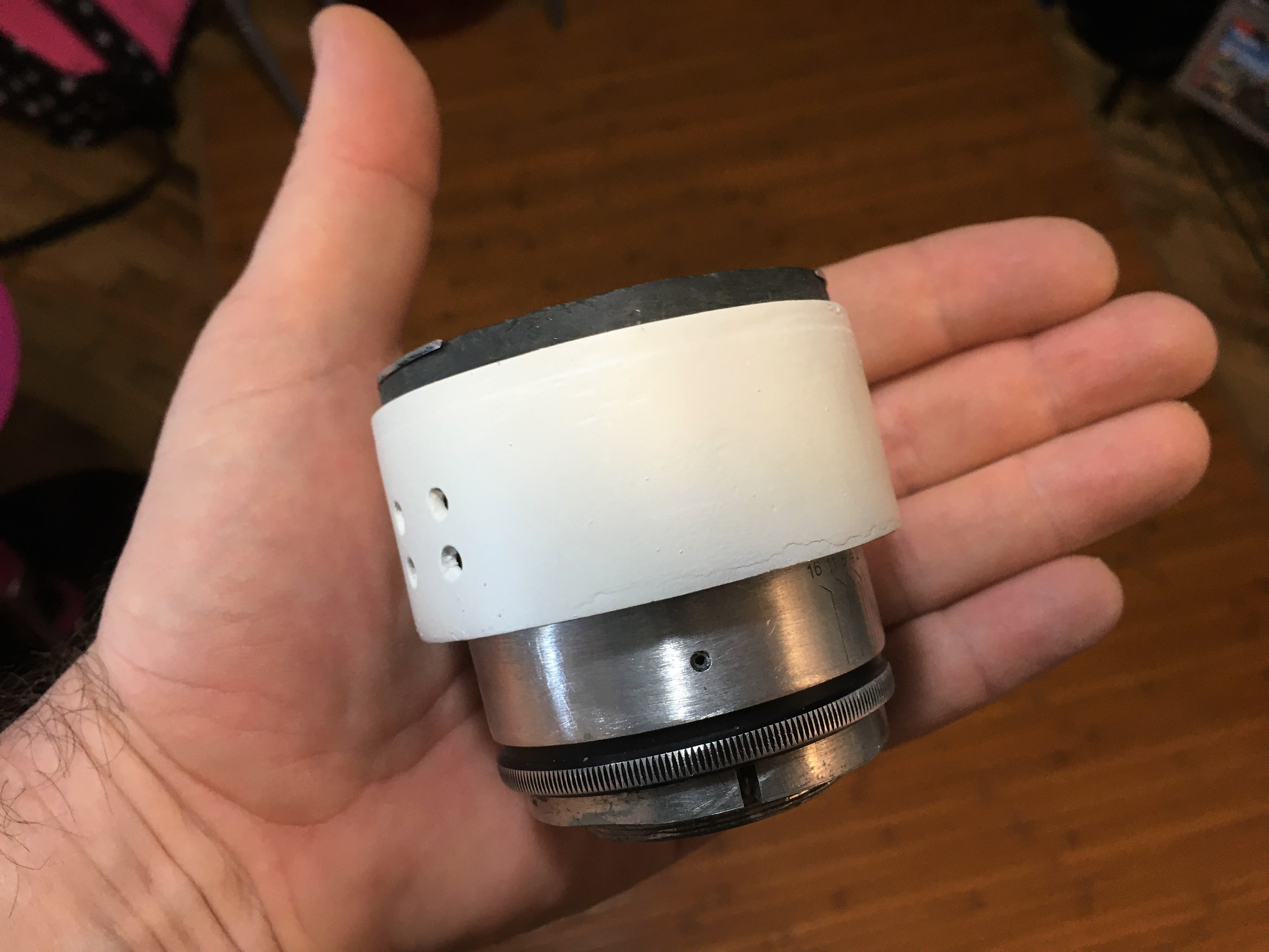

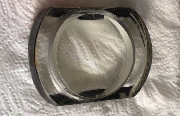

Cosimo Posted June 4, 2020 Author Share Posted June 4, 2020 3 hours ago, PannySVHS said: Awesome! Now if you could explain a bit more to the clueless:) Beautiful images. What camera did you use? Out of likes for today. Thanks very much, In short, what I do is experimenting with anamorphic glass using the 35mm and 16mm projector scopes. Once the glass has been extracted out its original body from different anamorphic lenses I combine and mix them, finding a match with different systems that meet the afocal condition. That is parallel light in/ parallel light out, ending up with a completely different scope in terms of compression ratio, IQ, character, multi-colors in the horizontal artifacts and structure (dimensions). The process is quite tiring and time-consuming. The first photos show 3 Schneider Cinelux-based hybrid prototypes fixed at infinity, without focus ring. These hybrids will fit inside a FVD focusing now is possible from minimum to infinity. I have made other interesting combinations with very large front glasses such as front 35Nap and front HI FI 2 which have been cut to the right diameter matched with the right rear glass re-housed and ready to enter the FVD. There is much more to say but I don't want bore you. I am on full frame sensor 5D3. heart0less, job and leslie 3 Link to comment Share on other sites More sharing options...

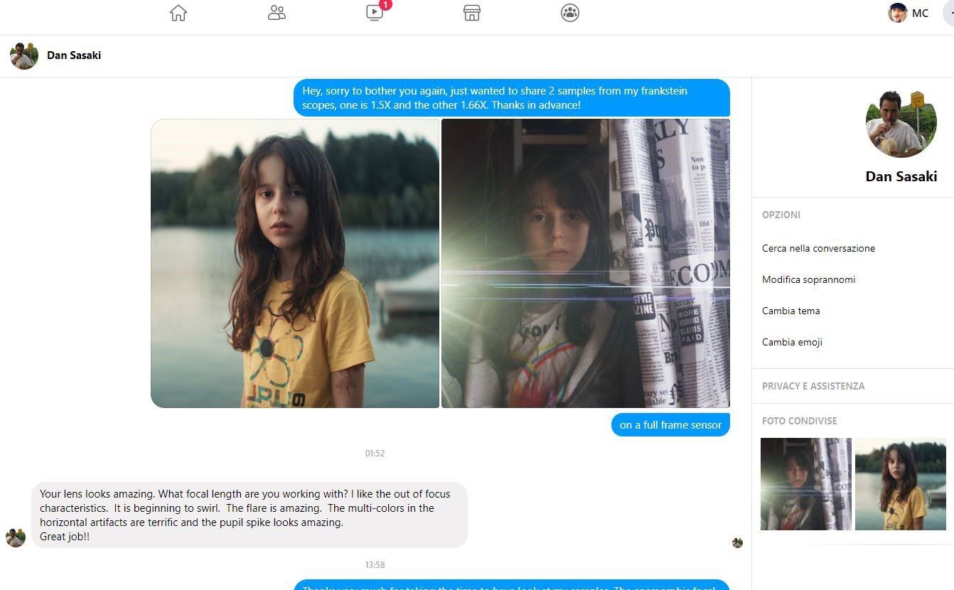

leslie Posted June 17, 2020 Share Posted June 17, 2020 6 hours ago, Cosimo said: Thanks Leslie! To be honest I also had some doubt about the multiple horizontal flares, I have contacted Mr Dan Sasaki Panavision optical engineer to have an opinion about my scopes and my experiments. I had a lovely chat with the guy. You can read the answer on the screenshot I have attached from my private messenger .There is no grading at all in the photo I 've posted. No I haven't paid full price for my lenses , it is an early investment I did when the anamorphics weren't so expensive like in these days,, I am glad I did though, most of these were quite cheap as well since they had small issues. This is a quick flare test I did quite long time ago with this scope my mistake, i was thinking the image was from a frame of a clip, not a photo from a full frame. I hadn't really connected the dots so to speak. Of course now that i have reread everything not having to grade and having such colours, it makes sense. Still its a nice image (no pun intended) that flaring is pretty bold, not sure it would grow on me. I do have a nap 35 pulled apart sitting in a box, maybe i need to keep an eye out for another broken anamorphic to play with. Link to comment Share on other sites More sharing options...
