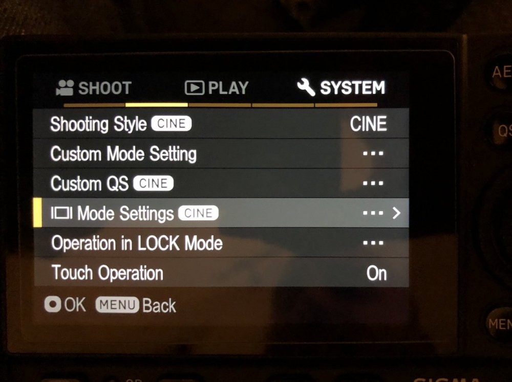

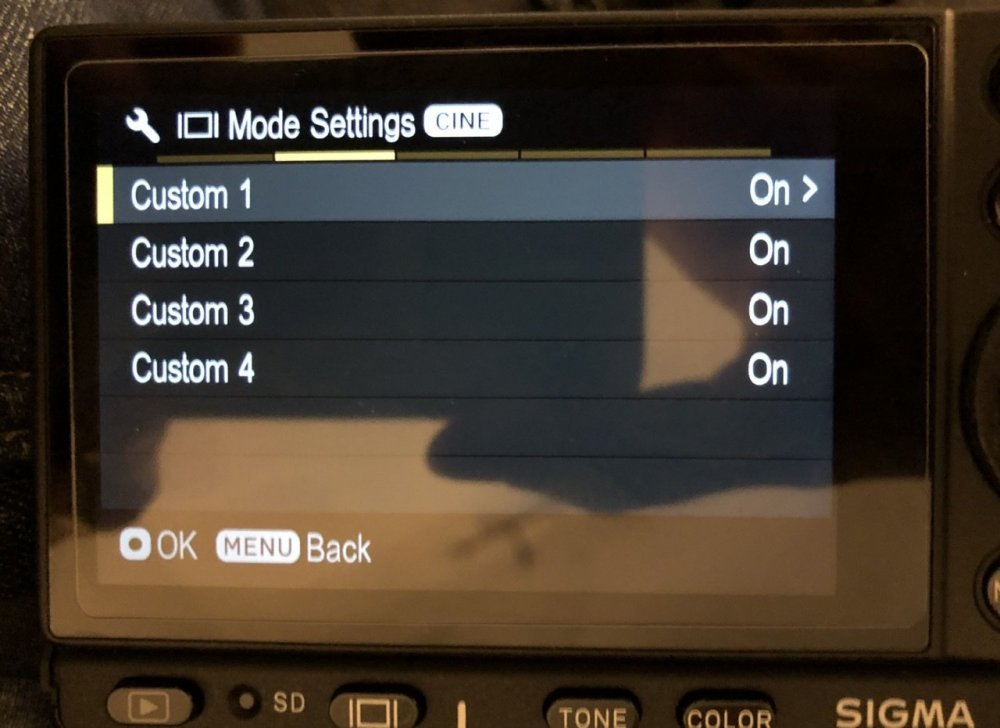

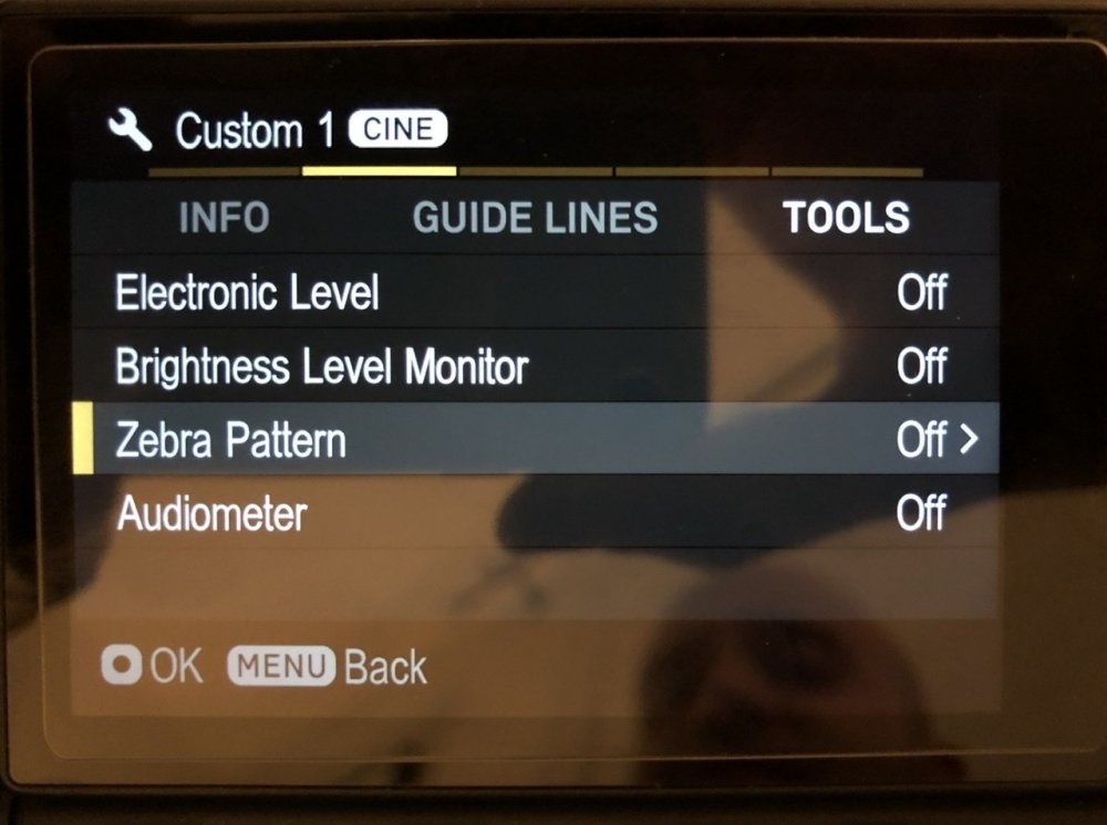

Brian Williams Posted December 7, 2019 Share Posted December 7, 2019 17 hours ago, MikhailA said: "after powering off the camera, or after power save sleep, the camera loses basic settings such as video resolution, codec, audio recording level" - is that true? 17 hours ago, rawshooter said: Unfortunately yes. So I just now got around to testing this- it seems that turning off the camera vs letting the auto power-save put the camera to sleep are basically the same thing, have the same effect on settings. If you in one of the Custom modes (C1, C2, C3) and you change a setting and let the camera turn off, then yes, when you turn it back on the settings will have changed to their default settings; which seems right to me, that’s how all programmable custom modes work on cameras, the whole point of them is to remember a specific setup of settings. The difference here is that the “sleep” mode is actually turning off the camera, or doing all the same things that turning off the camera does, instead of just pausing the camera as most cameras do when going to sleep. But in any of the other modes, PSAM, anything you set stays set that way the next time the camera turns on, whether you turned the camera off or if it went to “sleep”. 12 hours ago, rawshooter said: The problem is that you need custom modes for zebras to be visible. This isn’t true, you can set any of the display modes to have zebras on, and this applies to both custom modes as well as PSAM modes. (I only now just discovered this in the menus). Again, it sucks, but you can’t have zebras and focus peaking on at the same time. rawshooter 1 Link to comment Share on other sites More sharing options...

rawshooter Posted December 7, 2019 Share Posted December 7, 2019 5 hours ago, Brian Williams said: So I just now got around to testing this- it seems that turning off the camera vs letting the auto power-save put the camera to sleep are basically the same thing, have the same effect on settings. If you in one of the Custom modes (C1, C2, C3) and you change a setting and let the camera turn off, then yes, when you turn it back on the settings will have changed to their default settings; which seems right to me, that’s how all programmable custom modes work on cameras, the whole point of them is to remember a specific setup of settings. The difference here is that the “sleep” mode is actually turning off the camera, or doing all the same things that turning off the camera does, instead of just pausing the camera as most cameras do when going to sleep. But in any of the other modes, PSAM, anything you set stays set that way the next time the camera turns on, whether you turned the camera off or if it went to “sleep”. This isn’t true, you can set any of the display modes to have zebras on, and this applies to both custom modes as well as PSAM modes. (I only now just discovered this in the menus). Again, it sucks, but you can’t have zebras and focus peaking on at the same time. Thank you so much for your help and clarification! Turns out that, reading the camera manual, I got completely confused about the difference between Custom modes (C1, C2, C3) and "Custom Mode Settings" (which only affect the display) - I had thought that "Custom Mode Settings" were about configuring the Custom modes... (Sigma's language is not exactly helpful here...) Maybe it would be good to write a practical guide for the camera, because it has its own quirks and learning curve. - I just found out that the display for video recording can be much improved for judging correct exposure, and seeing more details in shadows and highlights, when setting Color to "Portrait" and "Tone" to "Manual" with +5 in the Shadows and -5 in the Highlights. Link to comment Share on other sites More sharing options...
