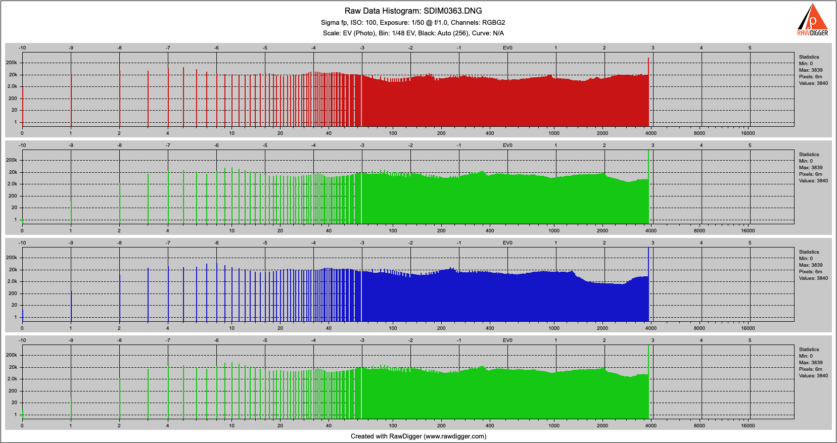

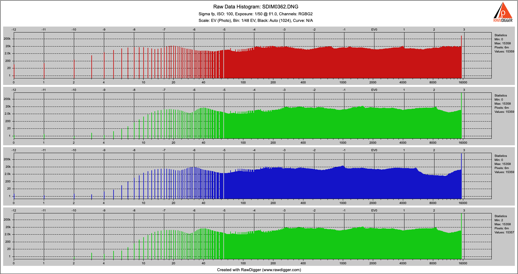

cpc Posted December 9, 2019 Share Posted December 9, 2019 23 hours ago, paulinventome said: The knock on effect is that, like the shadows which go green, the highlights go magenta. As @Lars Steenhoff mentions i do wonder if this is a bug/issue or just a side effect of the lack of tonality. If you recall the linearisation mapping that you posted before, there is a steep slope upwards at the end. Highlights reconstruction happens after linearisation, so it would have the clipped red channel curving up stronger than the non-clipped green and blue; it needs to preserve the trend. This hypothesis should be easy to test with a green or blue biased light. If the non-linear curve causes this, you will get respectively green or blue biased reconstructed highlights. I don't think the post raised shadows tint is related to incorrect black levels. It is more likely a result of limited tonality, although it might be exaggerated a little bit by value truncation (instead of rounding). This can also be checked by underexposing the 12 bit image additional 2 stops compared to the underexposed 10 bit image, and then comparing shadow tints after exposure correction in post. Link to comment Share on other sites More sharing options...
paulinventome Posted December 9, 2019 Share Posted December 9, 2019 3 hours ago, cpc said: I don't think the post raised shadows tint is related to incorrect black levels. It is more likely a result of limited tonality, although it might be exaggerated a little bit by value truncation (instead of rounding). This can also be checked by underexposing the 12 bit image additional 2 stops compared to the underexposed 10 bit image, and then comparing shadow tints after exposure correction in post. I've done a bunch more digging. I think you're right however i have errors in highlights now with 12 and 10 bit - compared to 14 bit stills and also magenta single pixels. However i am trying to work out whether this is data or resolve. I have a feeling it might be resolve. I am perhaps going to revise my comments about 14 vs 12 vs 10 bit. Some initial tests suggested to me that the difference was lopping off 2 bits and a couple of stops between 14 and 12. But after some more testing now i simple cannot tell the difference between full range 12 bit and full range 14 bit. My exposure is +1 on sky and shadow. And both 12 and 14 bit (and 10) pull back full detail in clouds despite all showing as fully clipped. As a control i compare to Lightroom and what i've realised is that in lightroom where there is no highlight option actually it is taking full advantage of that ALL the time seamlessly. Resolve and Lightroom match. This is suggesting to me that perhaps the lopping off of 2 bits is in the shadows. Yet between 14 and 12 i cannot break. Whereas 10 is clearly lacking detail. I have no method here at the moment to test dynamic range (aka i can't find my wedge chart) So not 100% sure at the moment and more tests to be done. But 12 bit is very robust - or 14 bit stills are hampered somehow. cheers Paul Emanuel and Lars Steenhoff 2 Link to comment Share on other sites More sharing options...

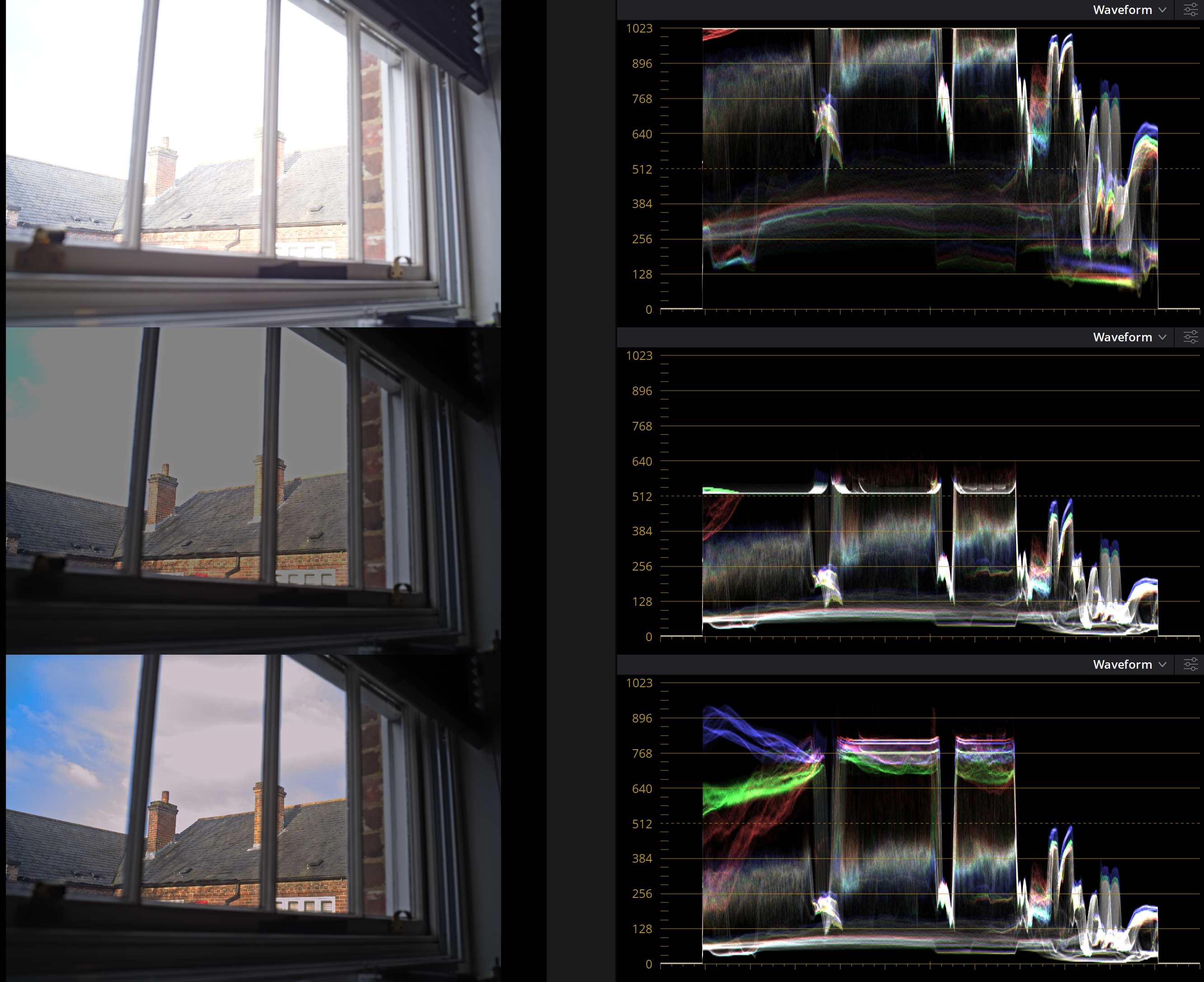

paulinventome Posted December 9, 2019 Share Posted December 9, 2019 Okay, so the 12 to 14 difference is in the lower stops. The DNG sets the point at which is EV0, so in the 12 bit that is set two stops lower. You can see the raw data in the files. So Resolve will bring them in based around the EV0 point. But it is interesting at least in this test (outside a window with clipping clouds) that i can't visually really see a difference - when i push the shadows up, and expand that - either on scopes or visually. This makes some sense now that the difference between 14 and 12 is at the bottom of the range and it's filled top down. So really you are missing two stops at the shadows but actually this is really only a handful of code values at that range. What i will do is lock off a shot and shoot 8/10/12/14 and compare. What amazes me about this scene is the level of recovery. The lower picture shows as shot, it's at least 2 stops over. Then pull it down normally and then turn on highlight. This is recovered from the Red channel which hasn't clipped in a lot of places. If you took the image into Lightroom and brought it down the same thing happens automatically. So using Lightroom to judge native dynamic range of an image is not possible (the degree of recovery depends on the scene) Cheers Paul In the i Link to comment Share on other sites More sharing options...
