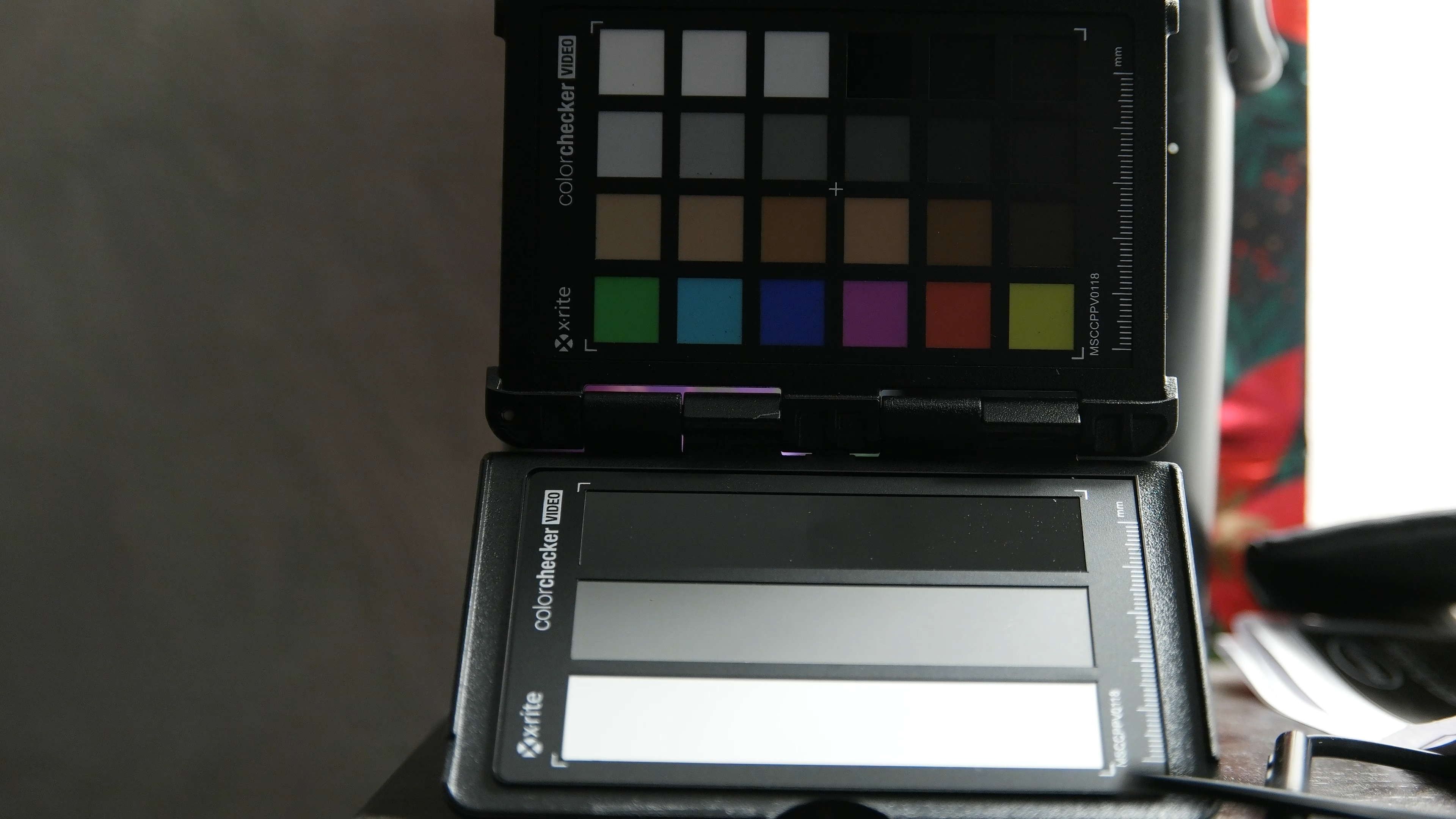

mnewxcv Posted February 18, 2019 Share Posted February 18, 2019 I can confirm that turning OLED Color on/off creates a visible difference when shooting a colorchecker. Attached a photo of each. Looks like a bit higher saturation overall, but it is also not linearly increased for each color. Rather, blues seem to be a bit higher in saturation with OLED color on, and the magenta trace seems to pull true to magenta, while the magenta trace pulls slightly to the blue side of magenta with OLED color off. Also, my wallpaper, which I consider to be in the white family but containing some color looks much more yellow/warmer with OLED color on. However, the white squares on the color checker are almost identical between on and off, so white balance isn't really affected directly. oled off.bmp oled on.bmp Kisaha, KnightsFan and Francesco Tasselli 3 Link to comment Share on other sites More sharing options...
