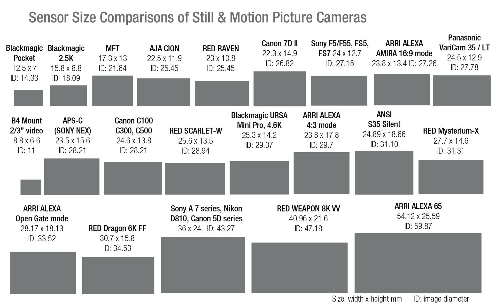

The math...
1. look up the sensor dimensions
2. multiply by the focal reducer’s factor
3. Profit
Link to post

On 12/13/2018 at 5:24 PM, Caleb Genheimer said:
The math...
ummm.... is your math calculations correct? I'm trying for the life of me to replicate your figures for the maths on the GH5 4:3 sensor and Speedboosters:
17.3 X 13mm
X0.64= 27X20mm
X0.71= 24.3X18.3mm
- For the Metabones Speed Booster XL 0.64x  wouldn't it be both width (17.3) and height (13) multiplied by 1.64?  So instead it would come out as...
https://www.metabones.com/products/details/MB_SPEF-m43-BT6
X0.64= 28.37X21.32mm
- Same goes for the ULTRA 0.71x
https://www.metabones.com/products/details/MB_SPEF-m43-BT5
X0.71= 29.58X22.23mm
- And the Zhong Yi Mitakon Lens Turbo Adapter Mark II .726x
https://zyoptics.net/product/mitakon-lens-turbo-adapters-mark-ii-for-m43-mount-camera/
X0.726= 29.85X22.44mm
Correct?... Or am I missing something here. How did you come out with X0.64= 27X20mm and X0.71= 24.3X18.3mm???
For the sake of comparison if choosing an APS-C or APS-H camera and using a speed booster with FF lenses... The sensor sizes would calculate from the Fuji X-T3 starting at 23.5mm×15.6mm (APS-C) to what??
- Using the Zhong Yi Mitakon Lens Turbo Adapter Mark II at 0.73x magnification (36mm FF width multiplied by .73 and 24mm FF height multiplied by .73) OR no??
https://zyoptics.net/product/lens-turbo-adapters-mark-ii-for-fuji-mount-camera/
X0.73= 26.28X17.52mm
- And for an APS-H camera like the Sigma Quattro H at 26.7×17.9mm itwould become... ehhh idk?!... this can't be the right math i'm using because these sensor sizes numbers are coming out smaller than a boosted m43 sensors...  I don't know how to derive these figures!!!
Please help.
And any links/recommendations to focal reducers for an FF canon 'EF' to Fuji X mount adaptor... in the best quality for the various reducer size options, do let me know!
Link to post

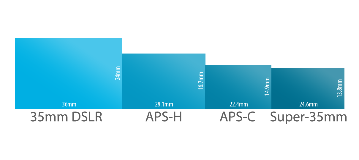

My calculations for reference of when attempting to get a digital sensor equivalent as close to 4 perf super 35 cinema as possible on an slr:
Original 4 perf=
23.16 x 18.16mm
Current 4 perf=
24.89 x 18.66mm
RED Helium=
29.90 mm x 15.77mm
Comparison:
M43
17.3 x 13mm          (not wide enough / not tall enough)
ApsC
23.5 x 15.6mm      (wide enough / not tall enough)
ApsH
26.6 x 17.9             (too wide / not tall enough)
SENSOR AS IS:
ApsC 23.5 x 15.6mm    (NO: wide as film but not as digital / not as tall as film or digital after crop)
ApsH 26.6 x 17.9          (YES: between width of film and digital / BUT not tall as film YET tall as digital after crop)
WITH SPEED BOOSTER:
Original 4 perf = 23.16 x 18.16mm
Current 4 perf = 24.89 x 18.66mm
RED Helium = 29.90 mm x 15.77mm
- X0.85
M43= 20.35 x 15.29mm         (NO)
ApsC= 27.64 x 18.35mm        (YES: between width of film and digital  / tall enough for film and digital after crop) CLOSEST EQUIVALENT~ THE WINNER!!!!
ApsH= 31.29 x 21.05mm       (NO: wider then film and digital / too tall for film and digital)
- X0.75
M43= 23.06 x 17.33mm         (NO: not as wide as film or digital / not tall enough for film but taller than digital
ApsC= 31.33 x 20.8mm          (NO: too wide for film and digital / too tall for film and digital
ApsH= 35.46 x 23.86              (NO: too wide for film and digital / too tall for film and digital
- x0.726
M43= 23.83 x 17.9mm            (YES: wide enough for film BUT not digital / NOT tall as film YET tall as digital after crop)
ApsC= 32.36 x 21.48mm       (NO: too wide for film and digital / too tall for film and digital)
ApsH= 36.63 x 24.65              (NO)
- x0.71
M43= 24.36 x 18.30mm        (YES: wide enough for film but not digital /  tall as film and digital after crop)
ApsC= 33.09 x 21.9mm         (NO: too wide for film and digital / too tall for film and digital)
ApsH= 37.46 x 25.21mm      (NO)
- X0.64
M43= 27.03 x 20.31mm       (YES: between width of film and digital / tall enough for film and digital after crop) The closest 'smaller sensor size' equivalent
ApsC= 36.71 x 24.37mm      (NO)
ApsH= 41.56 x 27.96mm      (NO)
Link to post

All the Sony FF cameras have the crop mode which ends up a 1.5 crop, just like their APSC cameras are. That way you can use the E mount lenses on the FF stuff which are called FE lenses. And that works out to be pretty close to s35.
And Real Cine cameras are All over the place in what they call s35 if you look at the graph below. So digital cameras wise anything goes for s35. The Canon C100, C300, C500 which by the way all use the same sensor, is one of the Few cameras that are really the old film dimensions in the modern era.
