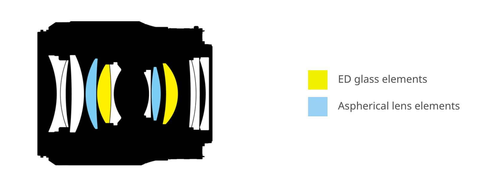

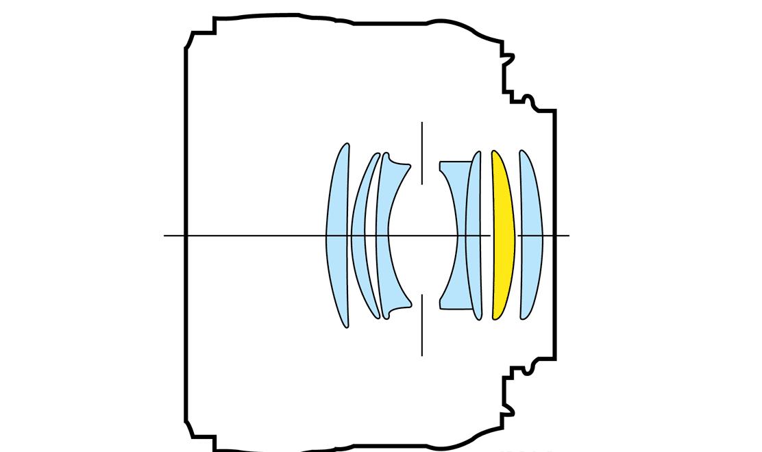

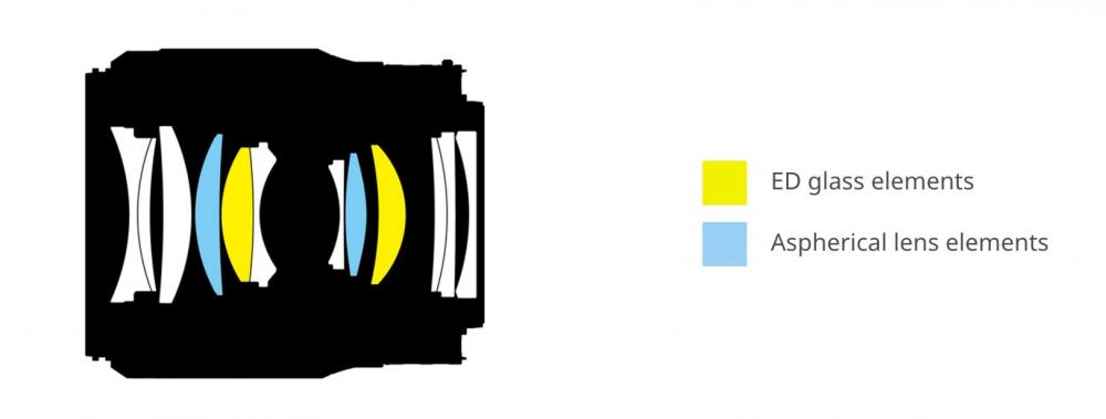

41 minutes ago, padam said:
This is exactly why they went with f/1.8 Z primes instead of faster. Other casing point is the Leica 50/2 APO, which still sets the benchmark (although all the rest they made is not far off in absolute terms).
Their new 50mm F1.8 Z is far from being a simple design,even compared to the 2011 release G which
was a significant step forward from the old film era AFD lens.
