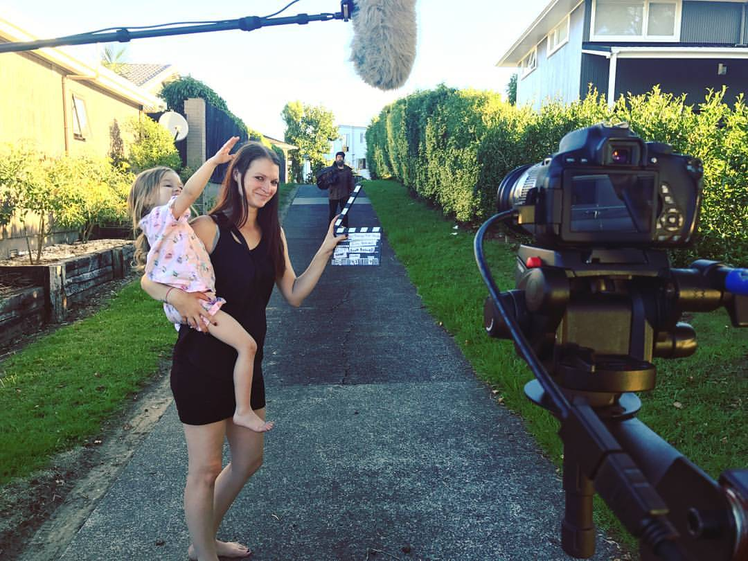

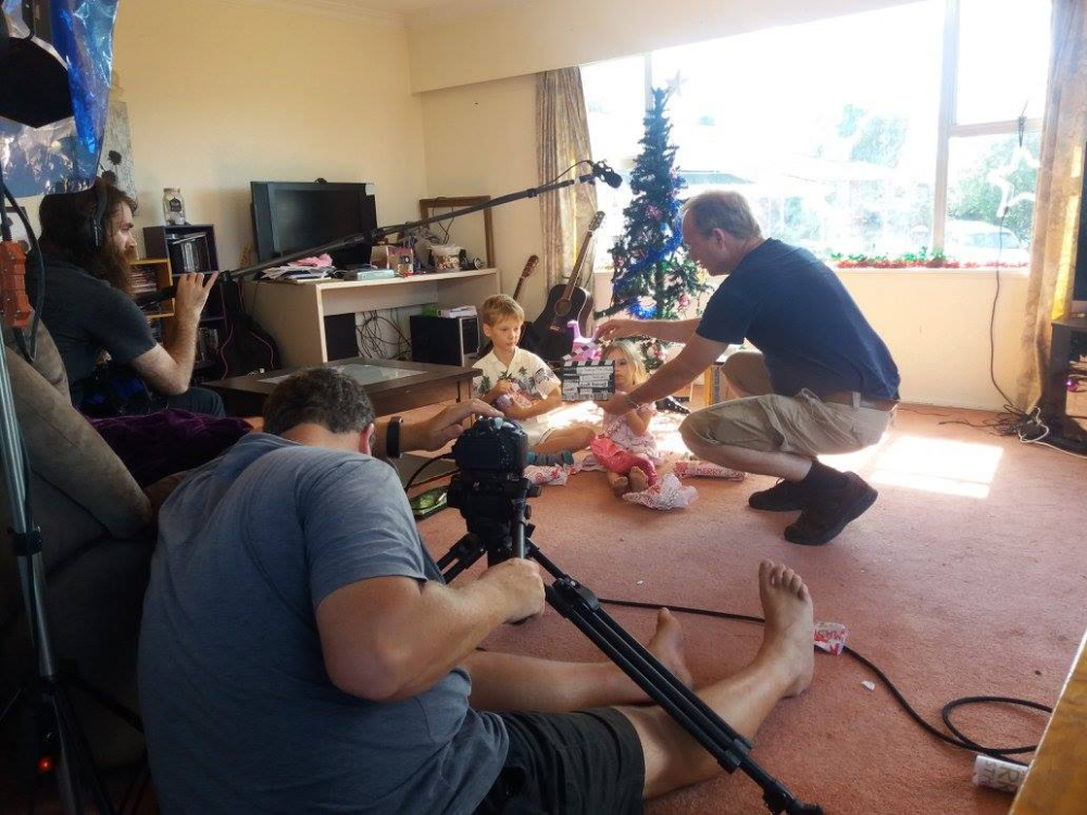

IronFilm Posted April 5, 2018 Share Posted April 5, 2018 4 hours ago, sam said: very well put. what's a typical reference monitor setup on the sets you frequent though? Flanders Scientific / Sony / Panasonic / etc are some of the common ones I see on sets with budgets. On low / no budgets then I can see almost "anything" used! Quite commonly, just a TV or PC monitor: This btw is the trailer of the film which was shot during the previous vlog from just before: It was just shot on a lowly Canon Rebel DSLR, seriously. A BTS shot of the director (it was her first ever film) and the camera (oh, and you can see my blimp too in the shot! ha): An indoors pic (you can tell from the HDMI cord running out the director is sitting somewhere there to the right of the pic, monitoring the shot): Me again, this was back when I was still using my Tascam DR680: kidzrevil 1 Link to comment Share on other sites More sharing options...
