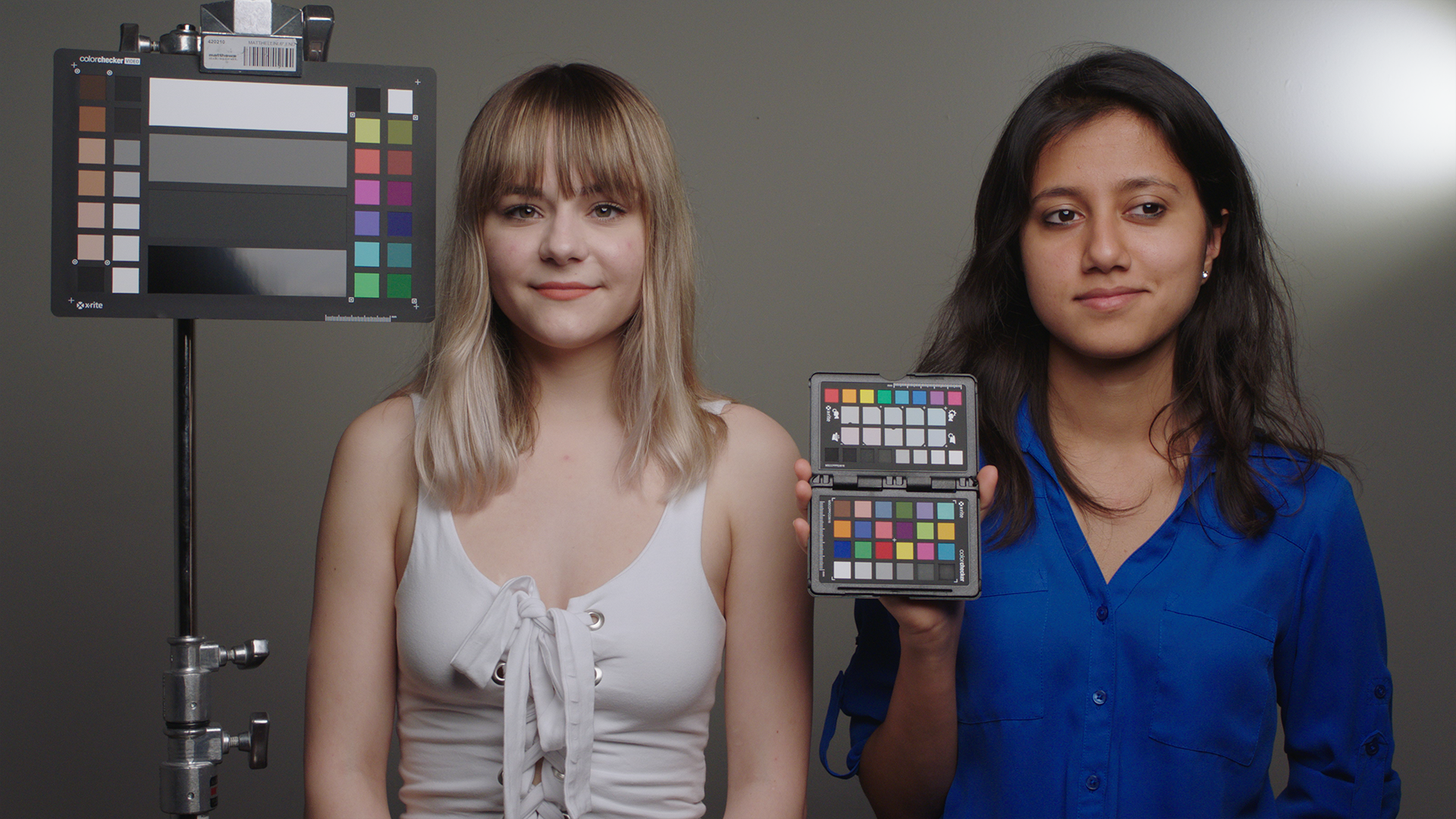

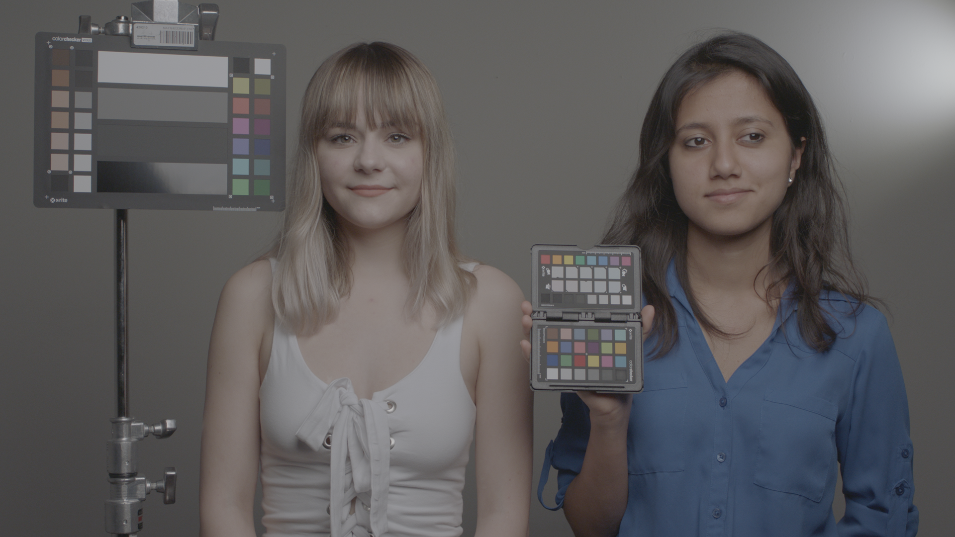

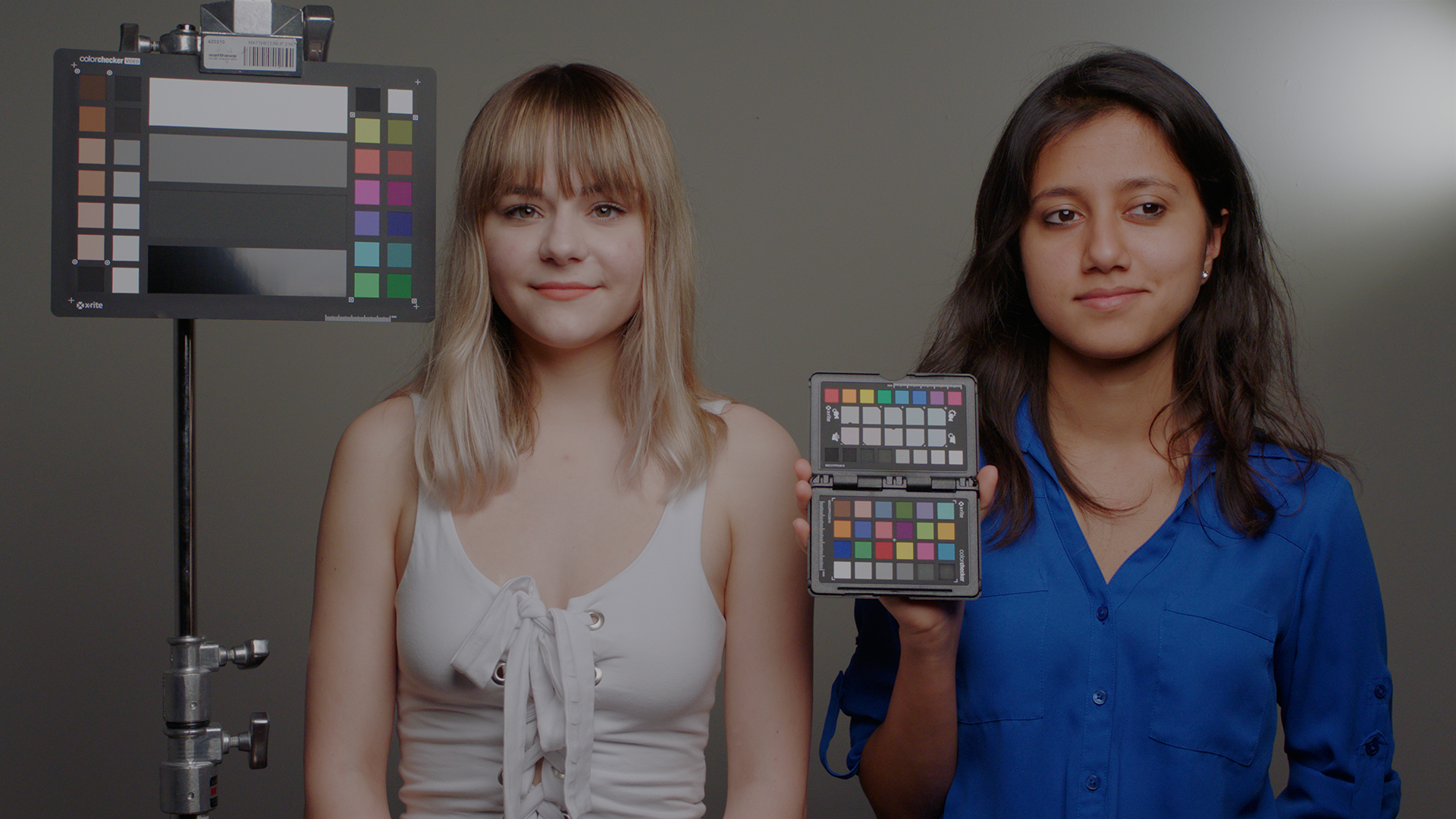

Maverick530 Posted September 5, 2018 Share Posted September 5, 2018 Ugh, I think I'm doing something wrong now. Maybe I was doing it wrong the whole time. In premiere I put the GHa Daylight (LogC) into Basic Correction, Then in creative, Im putting the Pop, Main, Lut. But whats happening is my image is just lifting the gamma and not expanding at all... Link to comment Share on other sites More sharing options...
Sage Posted September 5, 2018 Author Share Posted September 5, 2018 11 minutes ago, Maverick530 said: Ugh, I think I'm doing something wrong now. Maybe I was doing it wrong the whole time. In premiere I put the GHa Daylight (LogC) into Basic Correction, Then in creative, Im putting the Pop, Main, Lut. But whats happening is my image is just lifting the gamma and not expanding at all... Ah yes, that seems to be a common error. Its something I'd like to update the website to reflect, and not just have in the Pdf (many skip the Pdf). In Premiere, the standard route for VLog is to place the PRE (10 or 8 bit) in 'Basic', and then the conversion (Main/Soft/Pop or LogC) in 'Creative'. If you go the LogC route, then you'll need a second instance of Lumetri to use an Arri display Lut (or other LogC tailored Lut). Otherwise, just a black level placement is required to conform to cinema luma placement (Pdf) Also, WB corrections (if needed) go in the first 'Basic' section, with the Temp/Tint sliders Link to comment Share on other sites More sharing options...
Maverick530 Posted September 5, 2018 Share Posted September 5, 2018 1 minute ago, Sage said: Ah yes, that seems to be a common error. Its something I'd like to update the website to reflect, and not just have in the Pdf (many skip the Pdf). In Premiere, the standard route for VLog is to place the PRE (10 or 8 bit) in 'Basic', and then the conversion (Main/Soft/Pop or LogC) in 'Creative'. If you go the LogC route, then you'll need a second instance of Lumetri to use an Arri display Lut (or other LogC tailored Lut). Otherwise, just a black level placement is required to conform to cinema luma placement (Pdf) Also, WB corrections (if needed) go in the first 'Basic' section, with the Temp/Tint sliders So I use the Pre and then skip the LogC conversion? I read the PDF a few times but it got lost in translation, Maybe a tutorial video would be a little more helpful. Link to comment Share on other sites More sharing options...
Sage Posted September 5, 2018 Author Share Posted September 5, 2018 10 minutes ago, Maverick530 said: So I use the Pre and then skip the LogC conversion? I read the PDF a few times but it got lost in translation, Maybe a tutorial video would be a little more helpful. That's a good idea. I'm going to do a tutorial video, and streamline the vital points to emphasize them. Yes, the Premiere PRE (for VLog) corrects a subtle green distortion in VLog shadows that is unique to Premiere. Then you may use 'Main' in the 'Creative' section. The LogC variation is a distinct workflow (exact copy of what comes out of an Alexa, as measured at every point in the colorspace) that requires a (3rd) display Lut. Main prepares everything nicely, so that you are right in range of correct cinema luma placement (a place graders often go awry), have the correct Arri RGB display primaries for LogC, and have ideal saturation placement (especially with v2.2). JeremyDulac and mirekti 2 Link to comment Share on other sites More sharing options...
