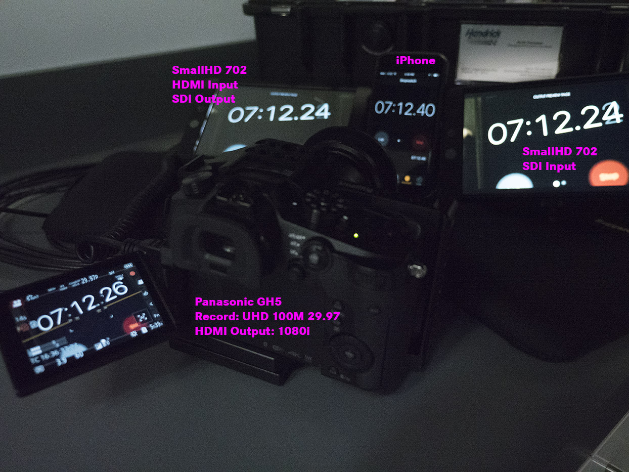

cameraDave Posted September 5, 2017 Share Posted September 5, 2017 I experience a very noticeable delay with my GH5. I'm not sure how scientific my test is but I can see the delay with my eye when someone is speaking and the audio doesnt match. I have tried different cables, different record settings, 1080p etc with no noticeable difference. Link to comment Share on other sites More sharing options...
Don Kotlos Posted September 5, 2017 Share Posted September 5, 2017 2 hours ago, cameraDave said: I experience a very noticeable delay with my GH5. I'm not sure how scientific my test is but I can see the delay with my eye when someone is speaking and the audio doesnt match. I have tried different cables, different record settings, 1080p etc with no noticeable difference. Your method is capturing the lag pretty well. Is there a ~140msec lag on the camera LCD as well? That agrees with the GH4 delay in one of the video posts up in the thread, but it is not just an HDMI lag, is a general lag in display. Link to comment Share on other sites More sharing options...

cameraDave Posted September 6, 2017 Share Posted September 6, 2017 15 hours ago, Don Kotlos said: Your method is capturing the lag pretty well. Is there a ~140msec lag on the camera LCD as well? That agrees with the GH4 delay in one of the video posts up in the thread, but it is not just an HDMI lag, is a general lag in display. Yes with the test I did I consistently saw ~120-160msec lag. Link to comment Share on other sites More sharing options...

Mick Fanning Posted July 25, 2019 Share Posted July 25, 2019 I can confirm that the latency issue is with the external HDMI device rather than the GH5 itself. I have two EVFs. An Alphatron that shows enough lag to make it problematic for precise camera moves and focus pulls and a Kinotehnik that does have some lag but it is noticeably less. Link to comment Share on other sites More sharing options...
