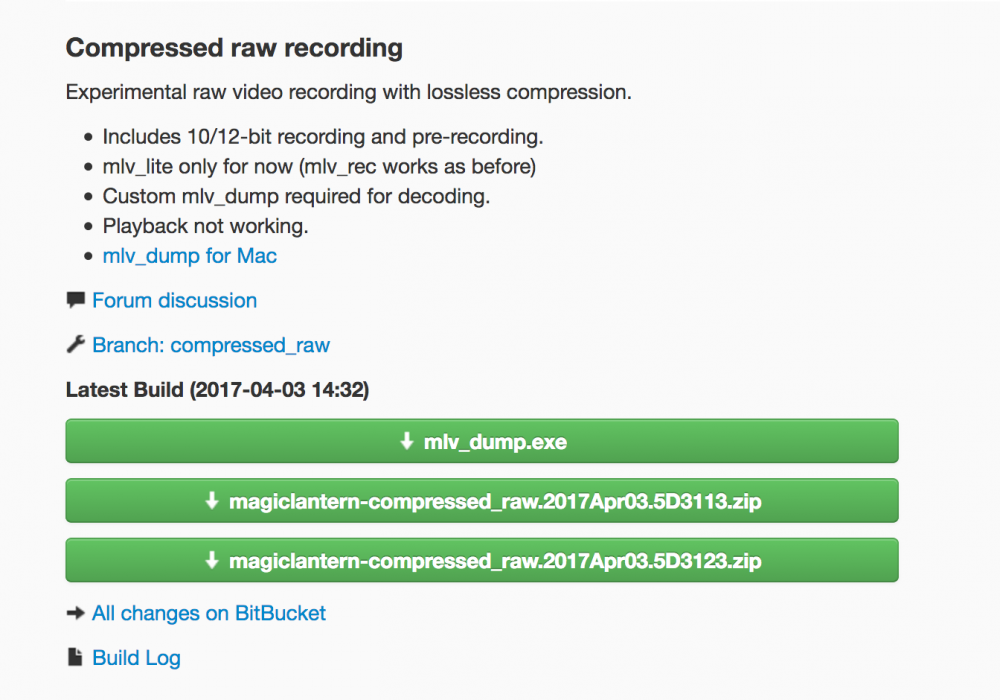

15 hours ago, EthanAlexander said:
I've been running a build from late 2013 that has SUPER stable 14 bit at full 1080 on my 5D3, so I've never been willing to update. Can anyone confirm how stable the 12 bit compressed build is? I'd love the smaller file sizes.
Why not keep that version on an SD, then try some of the new builds on a different one?
The latest 4K build seems very steady with all the normal modes (1080/24p etc)

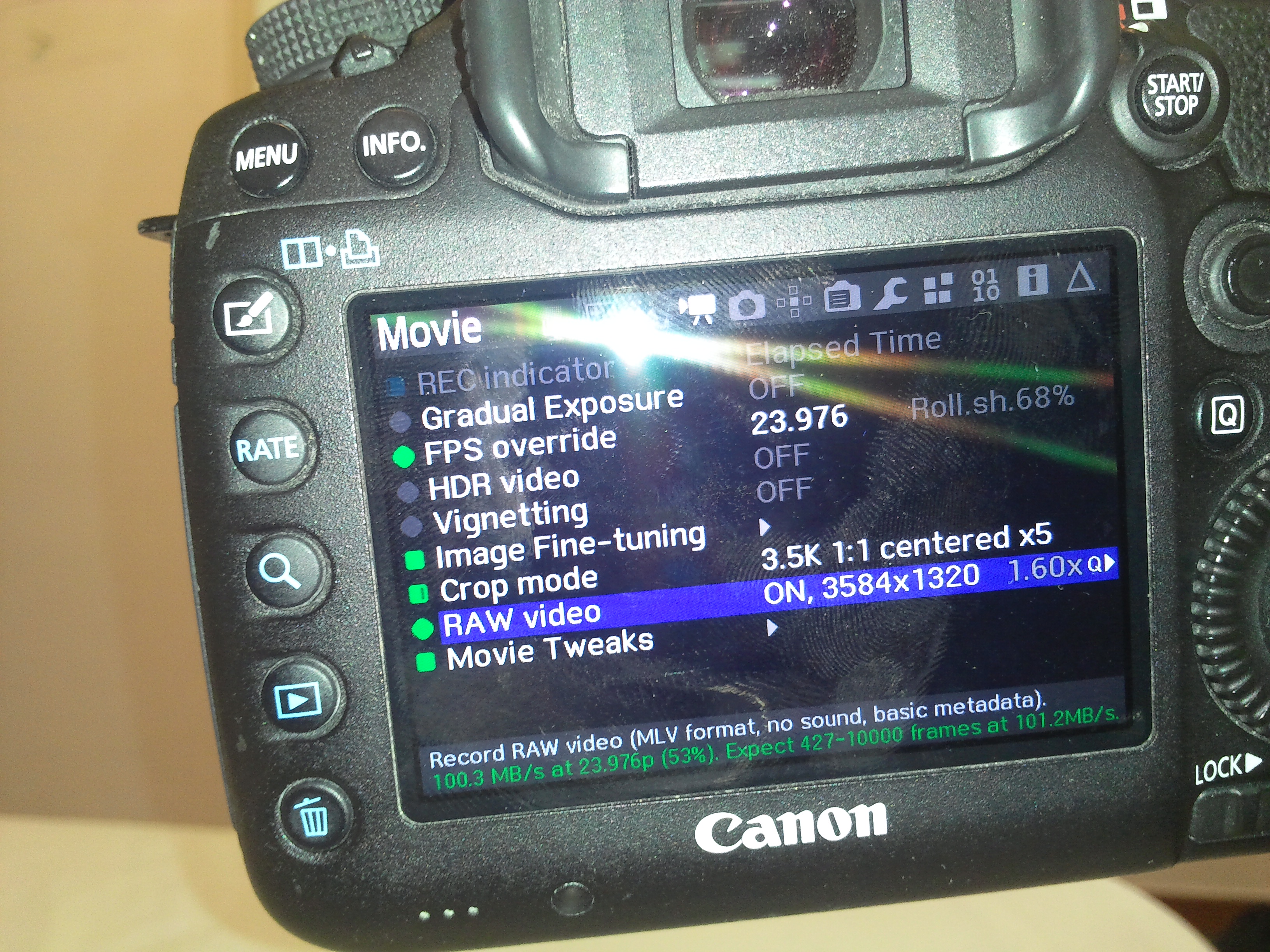

On 6/7/2017 at 11:42 PM, Andrew Reid said:
3072 x 1308 is 95.5MB to the card with 14bit lossless. What card are you using that gives you such a high sustained data rate? I thought it maxed out at around 85MB/s on the 5D3?
It is a shame they have not got live-view working yet with the 3K/4K mode, it's impossible to frame a shot.
5DIII max speed is around 100MB/sec. course it can write at that speed only with with globaldraw off
http://www.magiclantern.fm/forum/index.php?topic=6215.0
