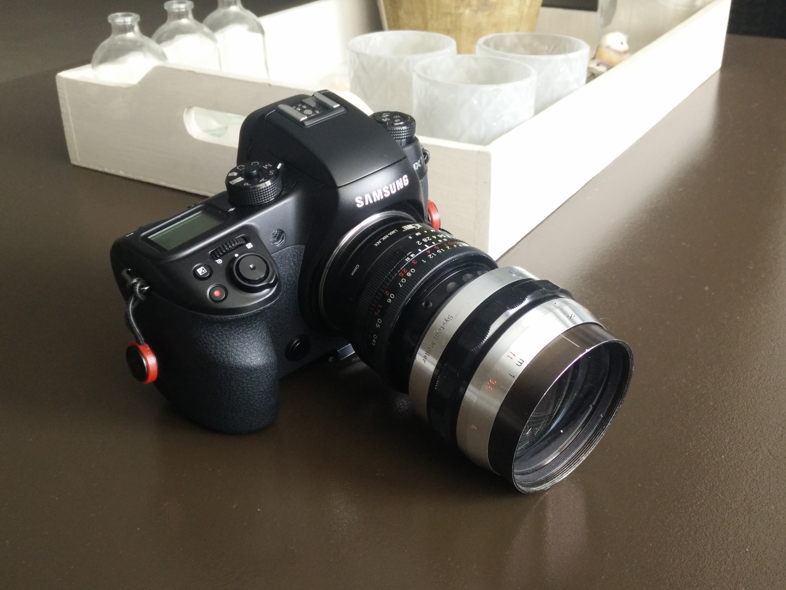

keessie65 Posted April 15, 2017 Share Posted April 15, 2017 I own the Bolex since a few months an I really like him. I use him with the Voigländer Ultron 40mm at my Samsung NX1. I have the one with bleuish / magenta flares and that one is what I have heard very rare. I consider buying the hardcoreDNA, but then I need also a rig for the weight of the combi. But perhaps I switch over to the Iscorama 36 to keep it compact for point and shoot. The sharpness of the Bolex is amazing! Juxx989 1 Link to comment Share on other sites More sharing options...
