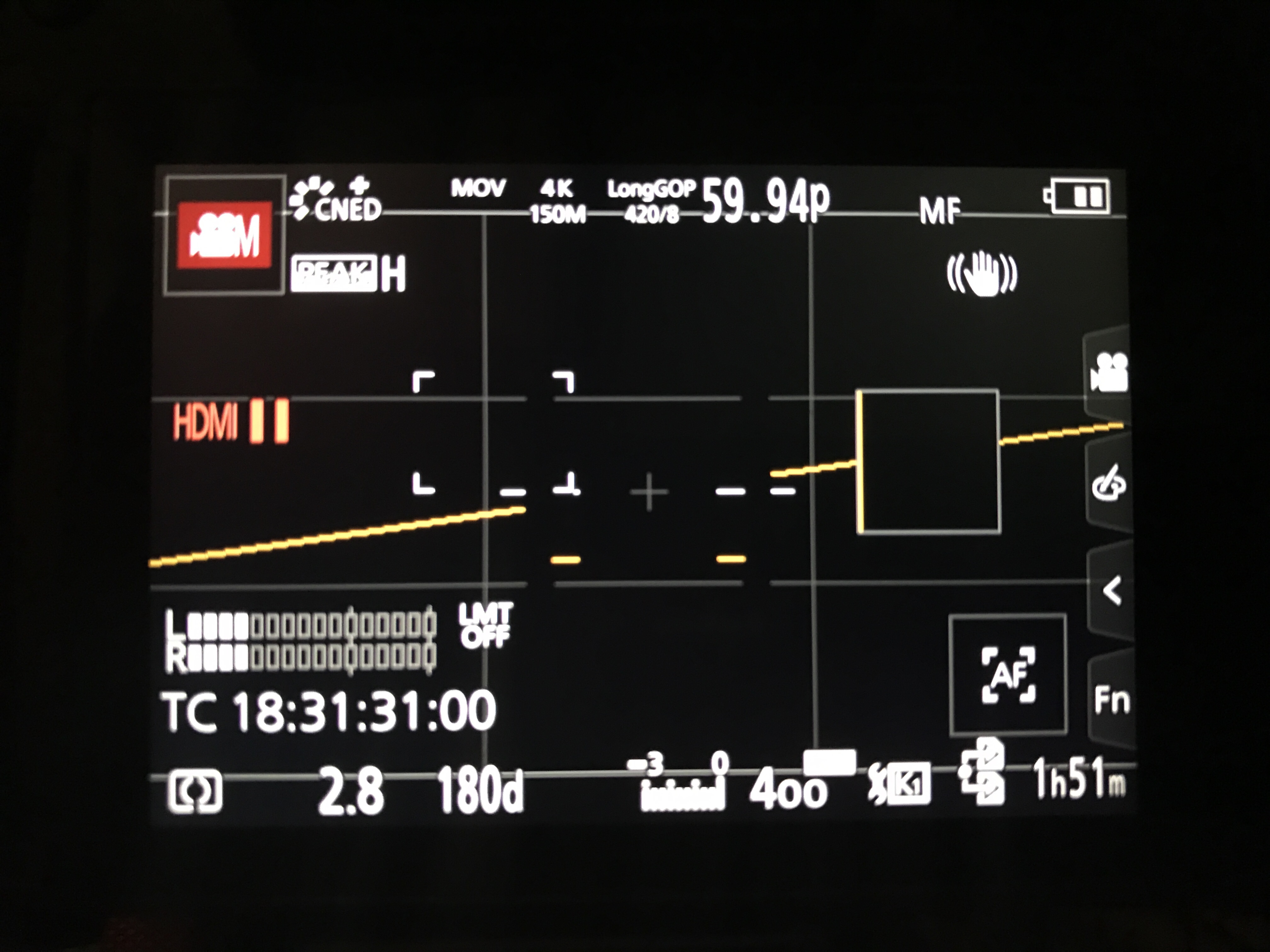

I'd like but I can't shoot Cinelike D mode because I setted my GH5 on 4K 59,94p 150mbp. For this reason the writing Cinelike D is disappeared. I like to understand: why to shoot in Cinelike D mode if it has more dynamic range than natural?

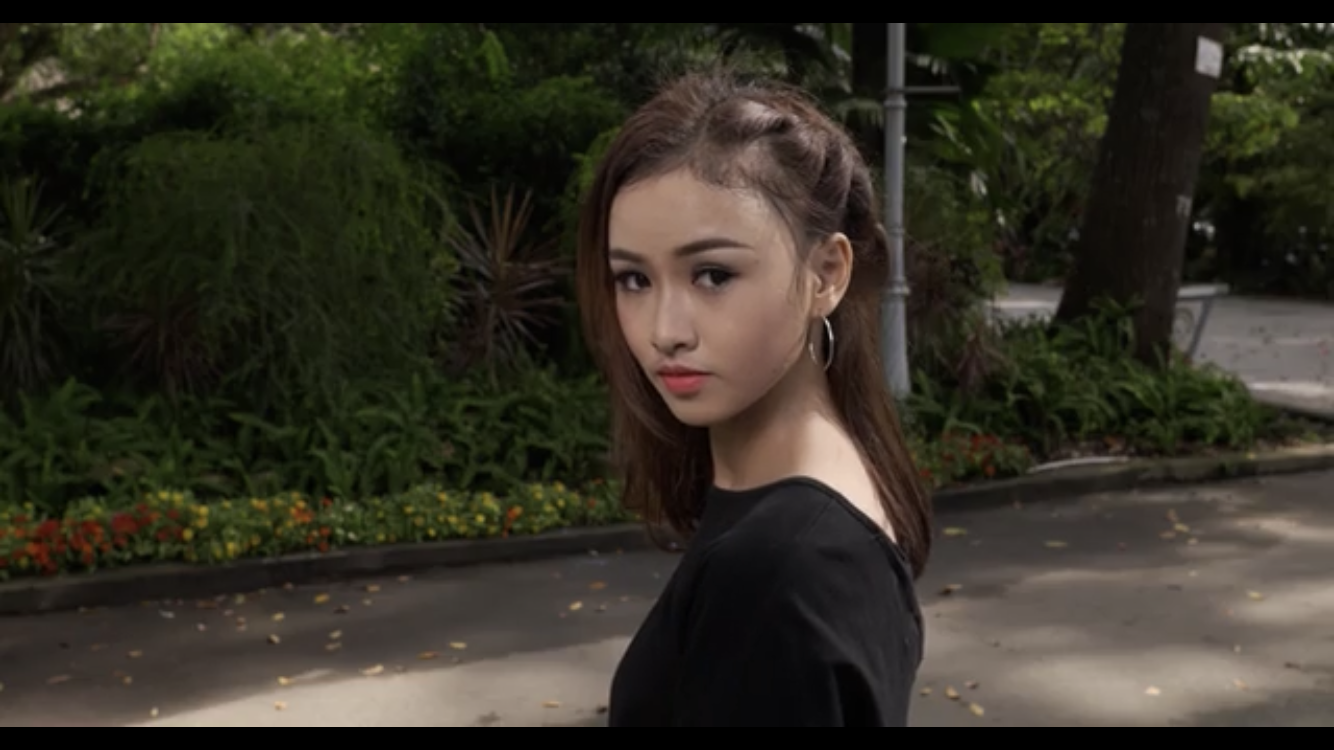

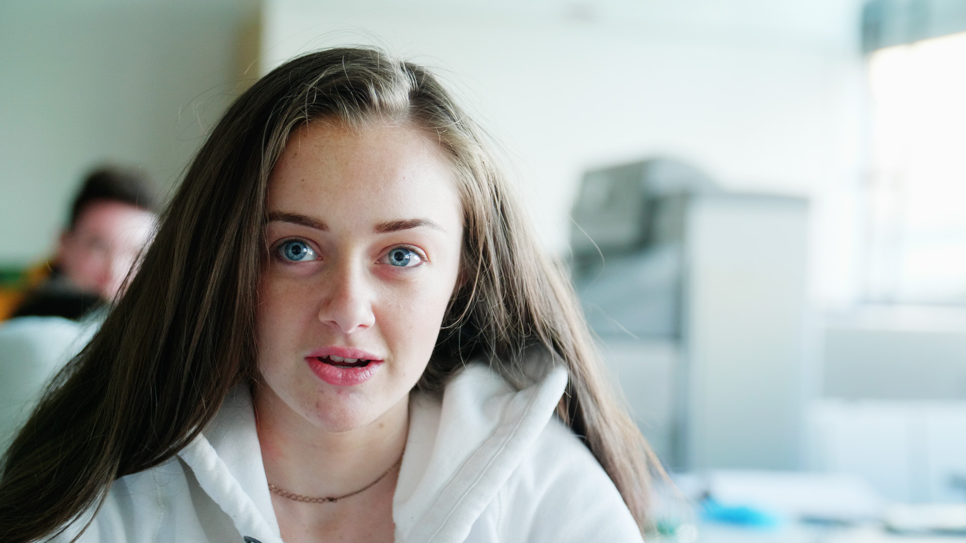

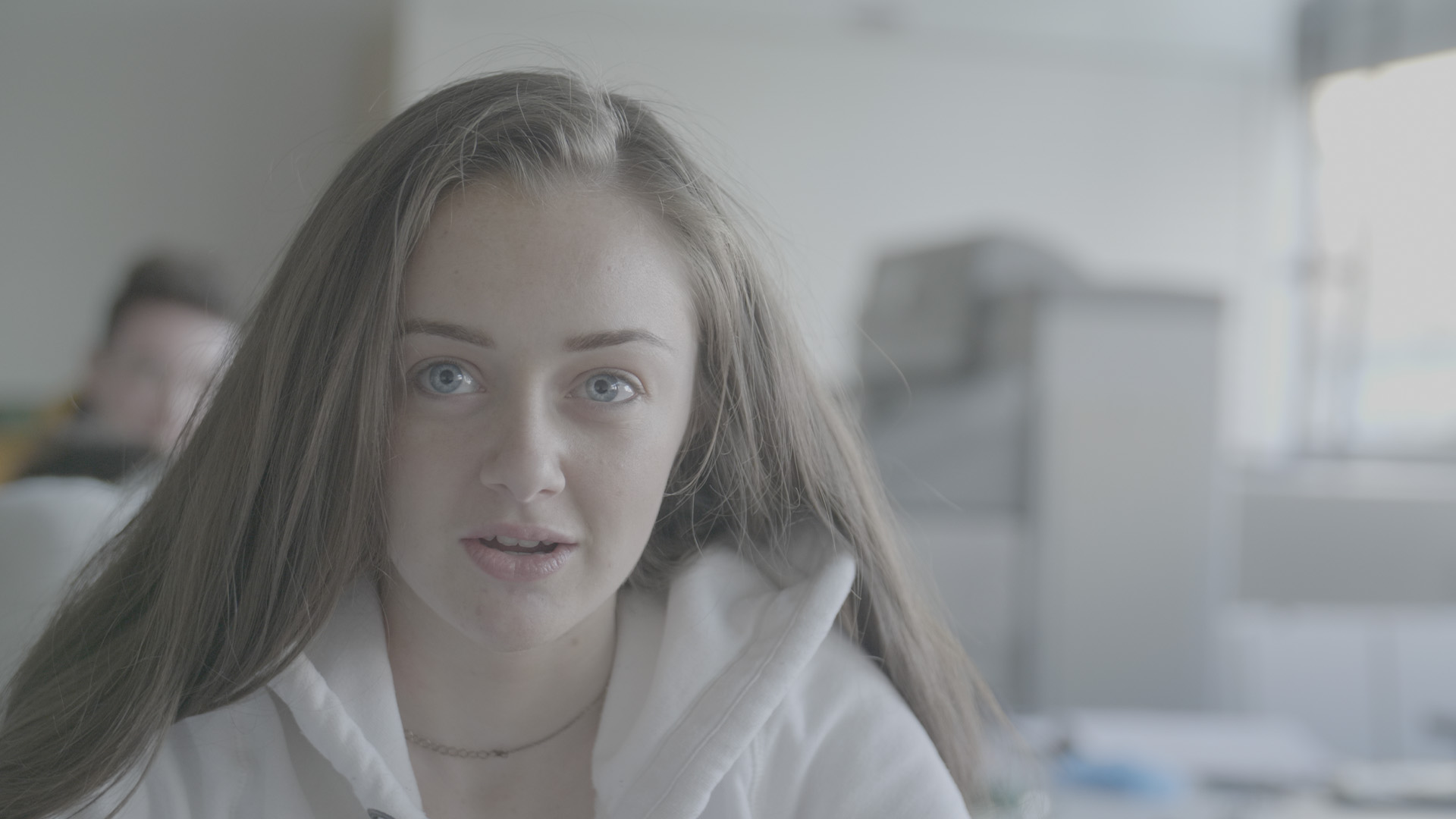

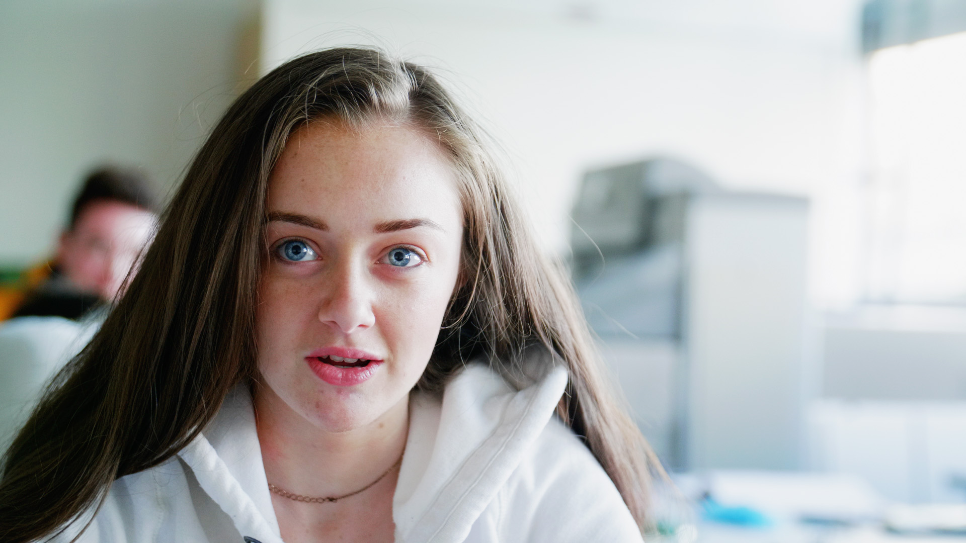

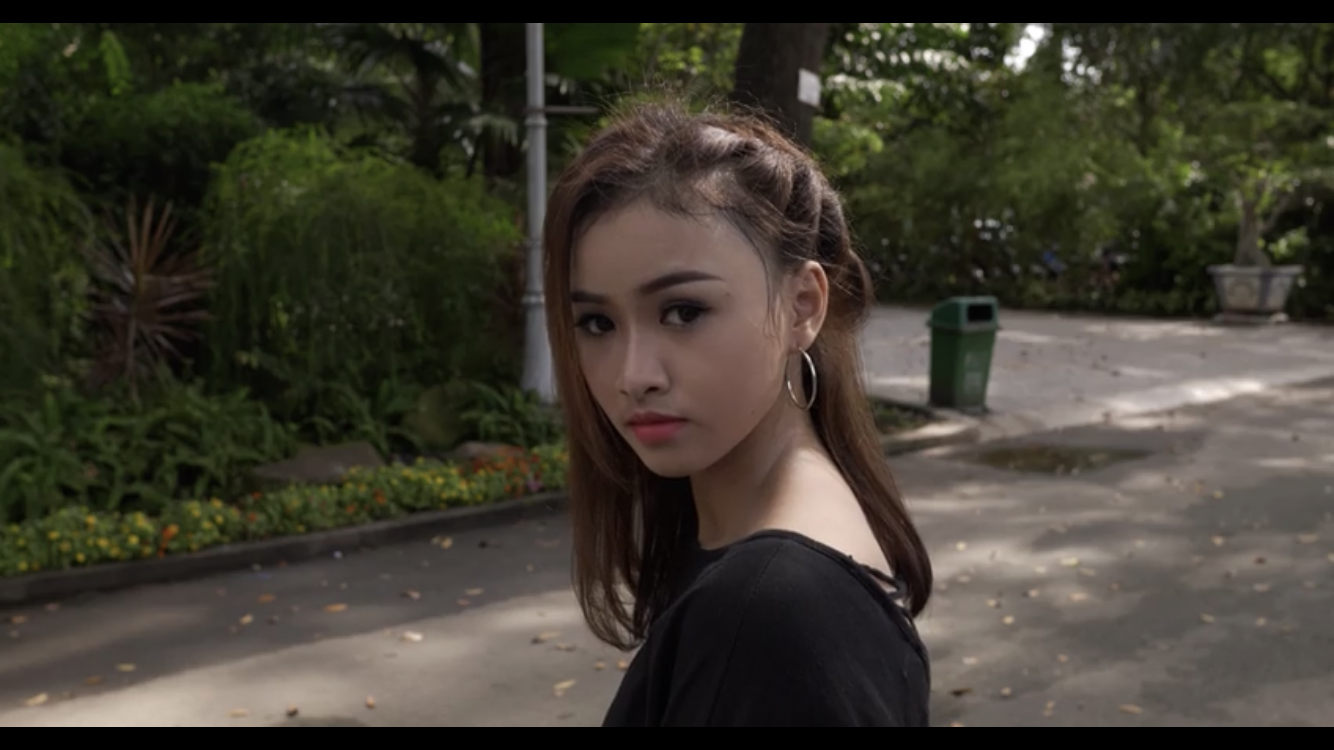

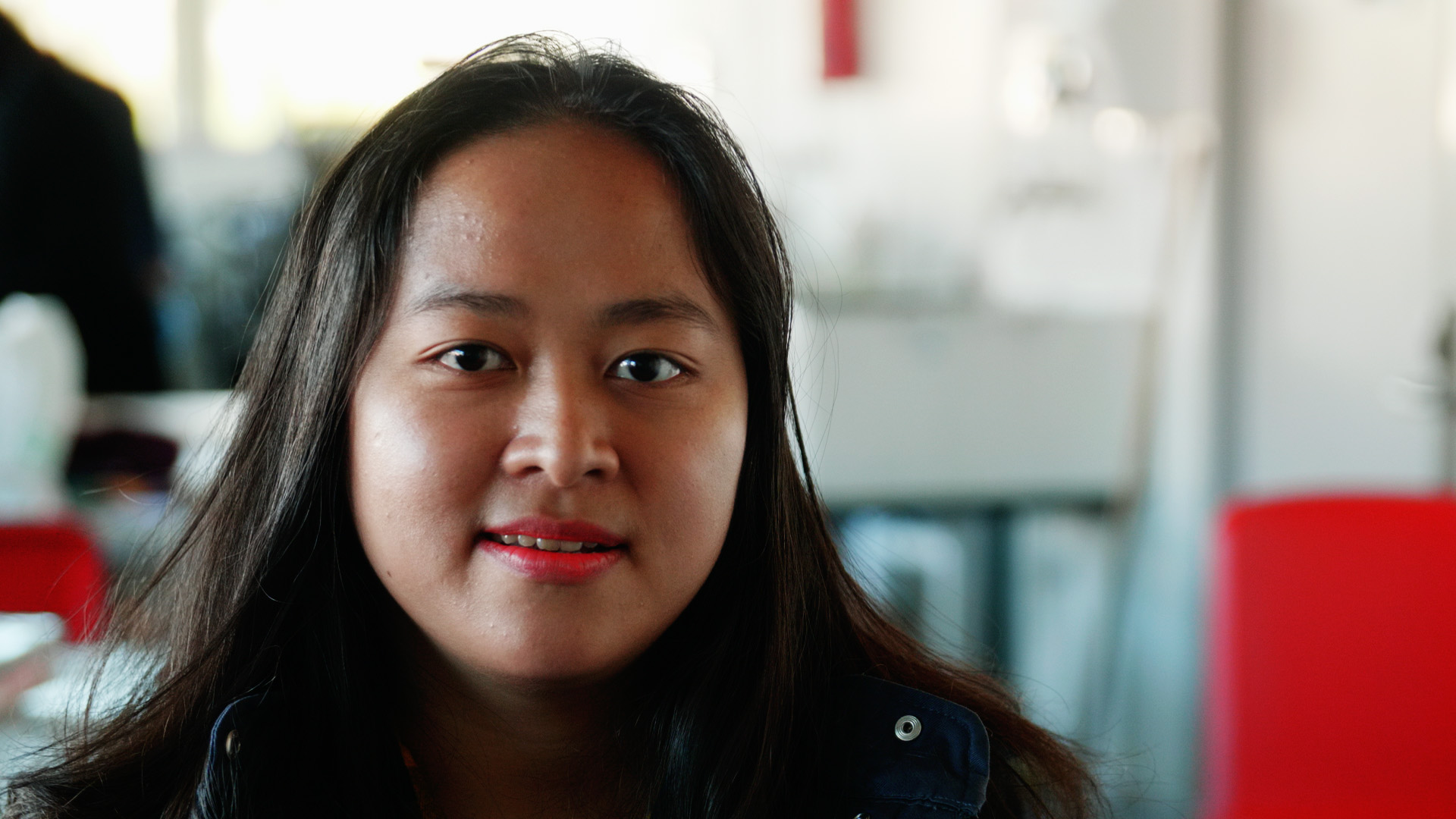

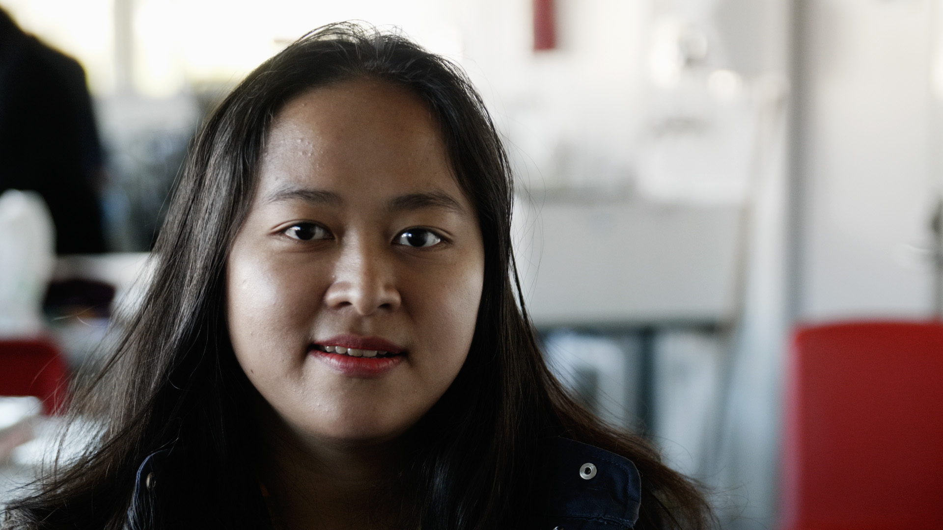

Here are some comparisons. This was shot in natural light on the Daylight WB preset. Here, the redness of skin in Joos's settings isn't particularly evident to me.
VLOG:
Add contrast:
Add Channel Mixer (Joos settings):
Compare with Sage's GHA with matched contrast:
Compare with my current Ektar look:

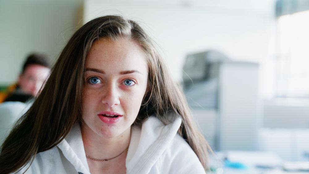

EDIT: On second thoughts, some reds are just far too saturated with Joos's Channel Mixer settings. Look at the radioactive reds that it creates on the inner lip area in this next example.
Plain VLOG with contrast:
Add Channel Mixer:
